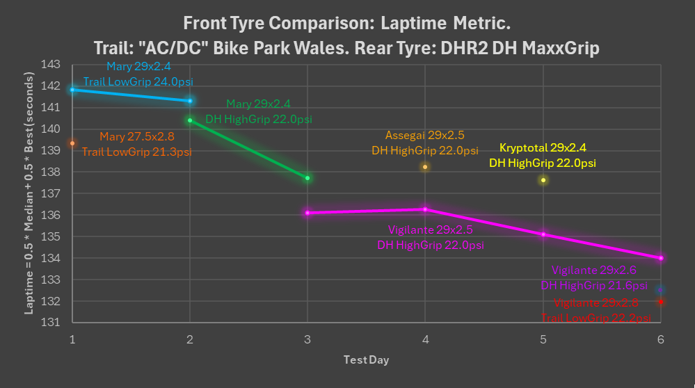

Hey all 👋
I did a whole heap of tyre testing last year at Bike Park Wales. The aim was to accurately measure which were quickest, based on multiple timed laps. I had always intended to make this video in case anyone finds it interesting or helpful, but only just got round to making it. Hope you enjoy it, let me know what you think, and whether any of this lines up with your experience. I was extremely surprised by the results... 😲
The tyres on test were:
  • Continental Kryptotal 29x2.4 DH/Supersoft
  • Maxxis Assegai 29x2.5 DH/MaxxGrip
  • Schwalbe Magic Mary 29x2.4 DH/Ultra Soft
  • Schwalbe Magic Mary 29x2.4 SuperTrail/Soft
  • Schwalbe Magic Mary 27.5x2.8 SuperTrail/Soft/Plus+
  • WTB Vigilante 29x2.6 Tough/HighGrip
  • WTB Vigilante 29x2.5 Tough/HighGrip
  • WTB Vigilante 29x.2.8 Light/FastRolling/Plus+
Rear control tyre: Maxxis Minion DHR2 27.5x2.4 DH/MaxxGrip
Tldr spoiler:
I did A-B-A testing on each day aiming to get in 5 quality laps before swapping tyre, then 5 laps, swapping back again and another 5 laps.
Timing was done by picking the exact GoPro frame where I crossed a specific feature on the trail, e.g. tree, rock, post etc so that I could get accurate timing to 1/60th sec and construct a perfect lap taking the best from each sector.
The results often surprised me and I think "feel" can be misleading. The Assegai for example felt epic, but in the data it is slower in every sector.

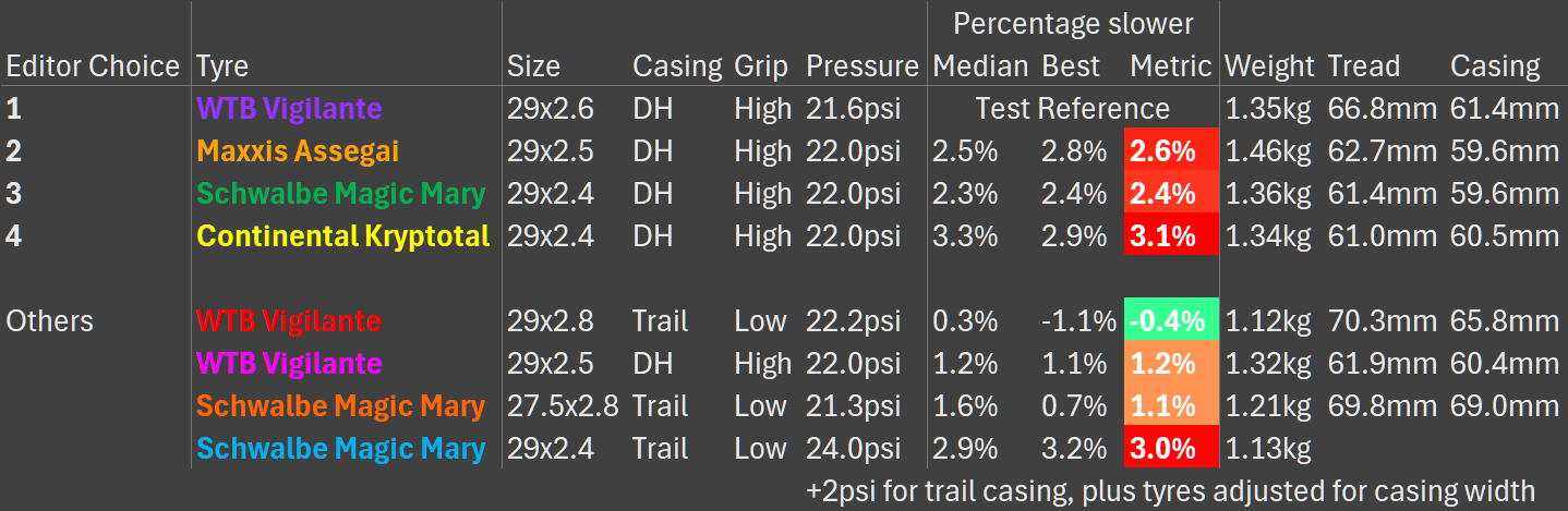

So you're telling us, the fastest tyre at DH is a tyre no pro team uses?
It is an uncomfortable conclusion, but yes, for me this was the quickest tyre in the data by some margin. I love riding DH but I'm no WC pro. That said I think I probably represent a typical rider much more than Dunne!
Also worth remembering that a lot of the pro teams get paid ~£100k to run a specific tyre, so what you see on TV may not necessarily be the best.
Yes, no, maybe, sorta... I deffo agree with some of that above... It's a very interesting test though for sure.
I know what you mean. It just feels wrong, and I'm as surprised as you.
I did my best to quantify it, and accept the limitations, but I reckon I've done a more thorough job than most reviewers by trying to measure it.
What it really taught me is that feelings are deceptive.

This is the winning tyre if anyone is curious:
WTB Vigilante Tough High Grip Tritec E25 Tubeless 29´´ x 2.6 MTB tyre, Black | Bikeinn
29x2.6 Tough/High Grip
Doing 100 laps I got pretty good at knowing the track, which gained me a lot of time. It's quite cool that this came as an accident/side effects of really concentrating to put in fair consistent laps. I think if my objective had been to get quicker by doing loads of laps I might have got frustrated or tried to push too hard and make mistakes. Would be a cool test, to see if focusing on something other than outright speed results in more progress.
The tests are super hard as you have to be absolutely on it all day, and e pedal up since I don't think you could get that many runs on uplift with time to change wheels, fix broken derailleurs etc.
I did the testing really for myself as I was just curious to know what are the fastest tyres based on data. Of course when you fit any new tyre it feels great because you're comparing it to an old one, so it's interesting to do back to back and look at times rather than feelings.
I wanted to share it in case anyone else finds it interesting. Perhaps I'll do some more shootouts if it proves to be popular. Schwalbe Radial Albert is on my radar.

What made you chose those tyre pressures? and would being +/- 2 or 3psi have altered your results any?
Now you should test the 27.5 x 2.8 against the 29 x 2.8 to see which one is faster. I think the 27.5 would be faster and quicker handling. I don’t care if it’s fashionable or not, but I’ve been running 27.5 x 2.8 DHRII’s F&R for years now and they’re awesome!
Minimum level that would provide me with adequate rim protection (from pre test running listening to that distinctive rock hit rim noise). Probably all tyres would have benefitted from slightly lower pressure, but I wouldn't like to speculate without testing.
Yep, getting to the bottom of this would be interesting. I'm not sure there would have been much in it between the 29x2.8 Vigi and 27.5x2.8 Mary. Also would bookend the testing. I've emailed WTB for that illusive tough/grip 29x2.8 🤞
I think next will be 2.6 Albert radial Vs Assegai, as I get that most people don't love plus tyres due to steering precision.

Most were run on Nukeproof rim, inner width 30.48mm. 27.5x2.8 was on DT 35mm inner, while 29x2.8 was on Crankbrothers 31.13mm (widest I had).
