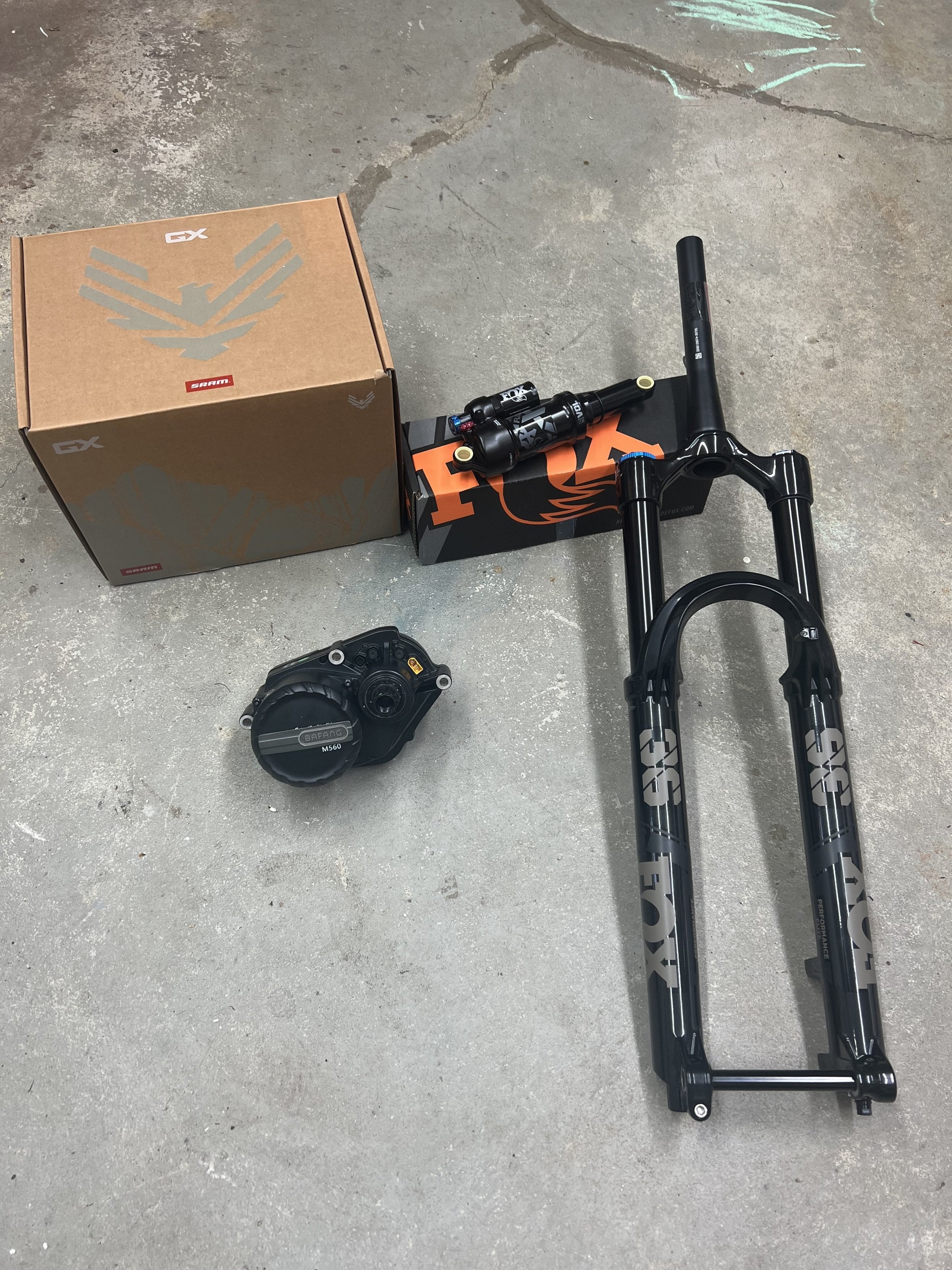

Some goodies are starting to arrive.

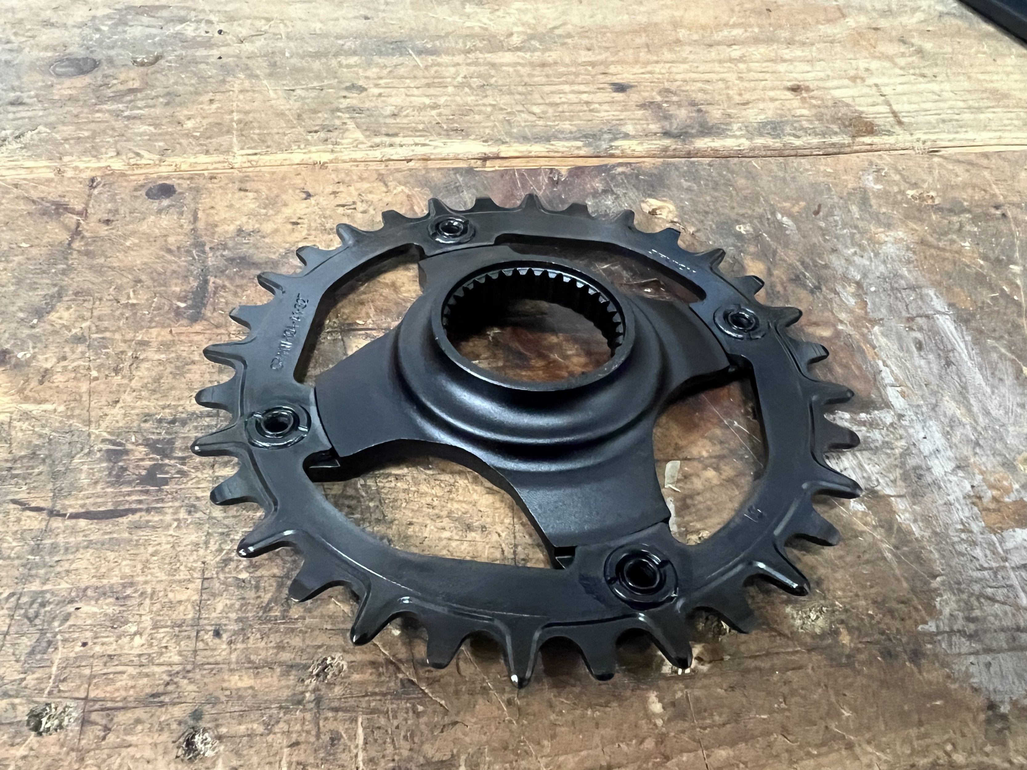

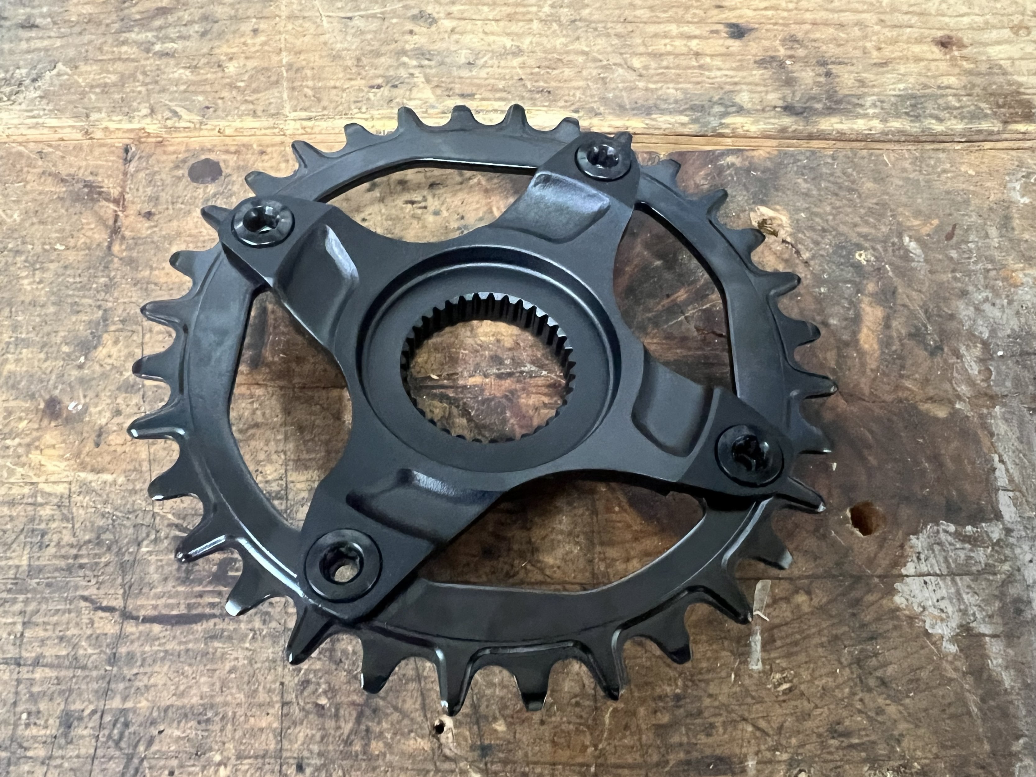

The chainring below that came with the motor is not compatible with a chain guide so I ordered another from GreenBikeKit that will hopefully be the correct one.

Finally got the proper chainring with room for the chain guide on it and my BESST Pro
