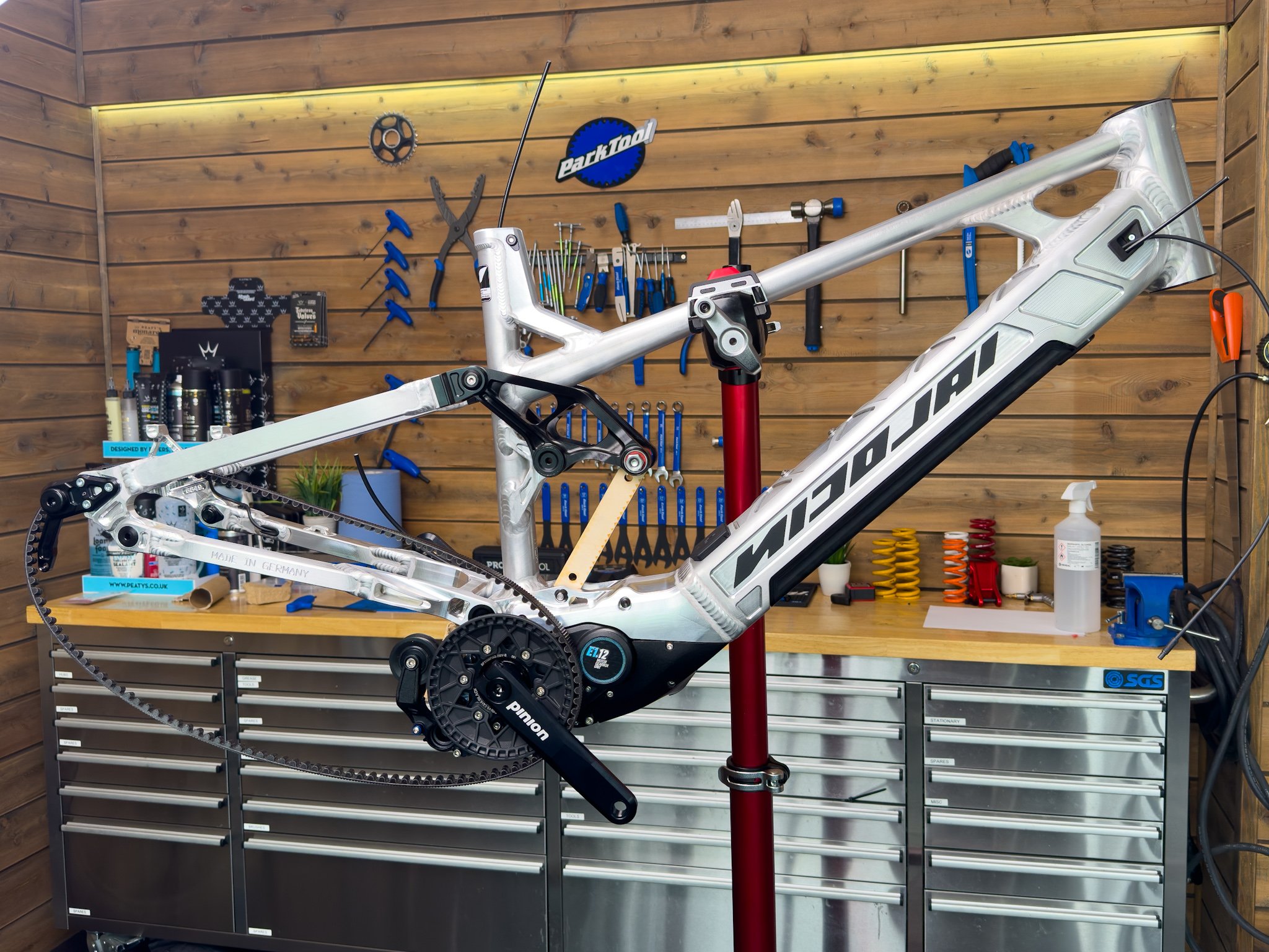

New Nicolai with Pinion gearbox announced

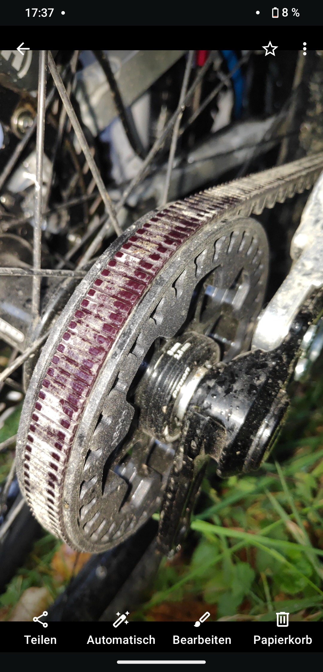

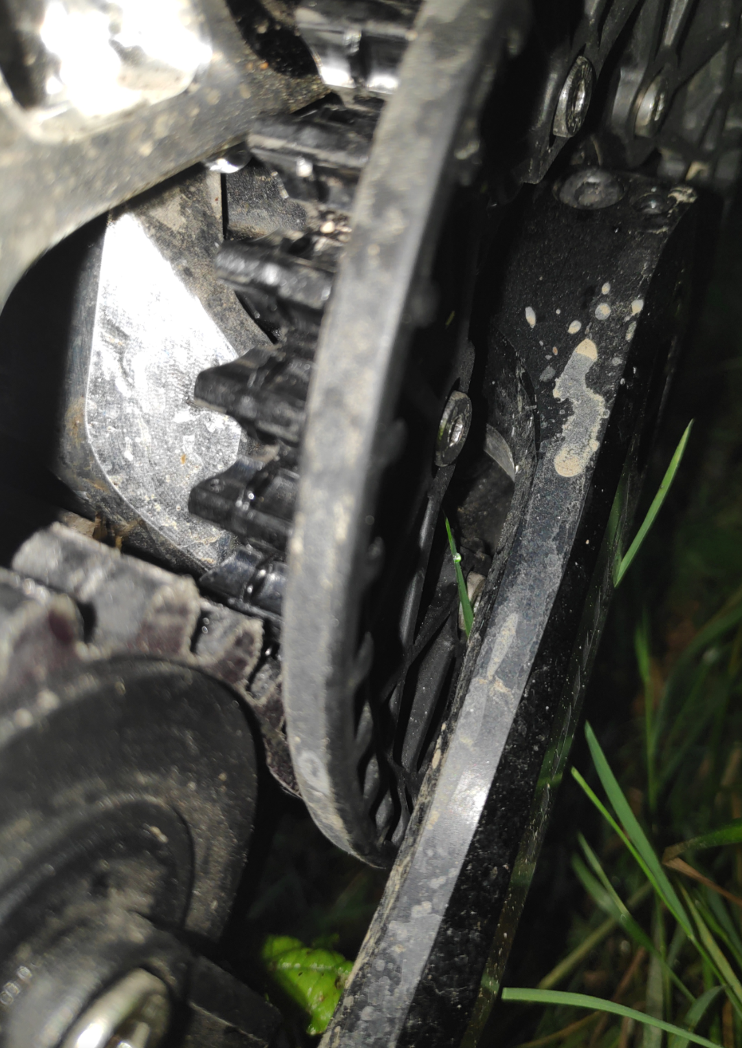

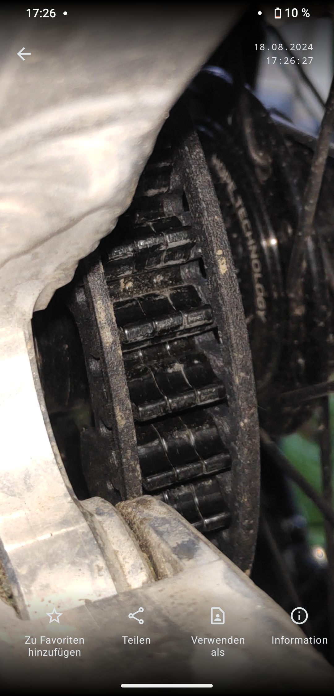

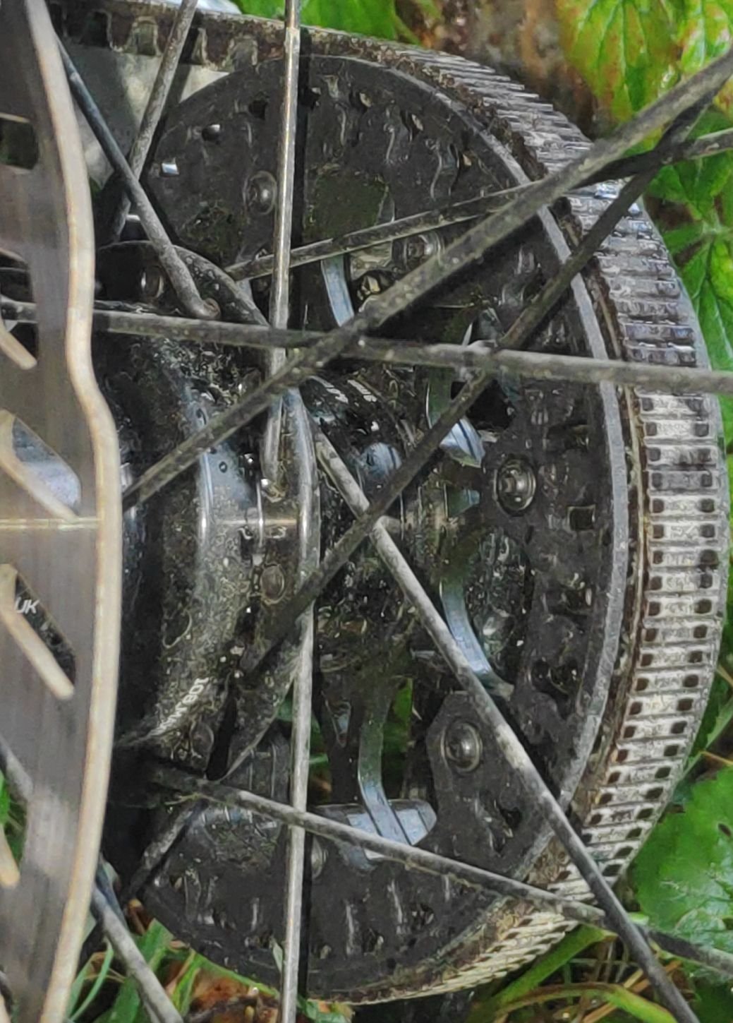

Could kindly take more detailed pictures please? I am interested in seeing how Nicolai designed the rear sprocket to go without the stubber.
I think they call it "snubber", See here
The new rear sprocket contains "side guidance" instead of "middle guidance" compared to the old one. The belt is the same, I guess. The pictures show that the belt still has the nut in the middle, because the front sprocket still uses the "middle guidance".
Some pictures:
Screenshot_20240818-172915_Galerie.jpg Screenshot_20240818-172653_Galerie.png Screenshot_20240818-173728_Gallery.png Screenshot_20240818-175555_Galerie.png Screenshot_20240818-175749_Galerie.png
Some pictures:
View attachment 145497 View attachment 145498 View attachment 145499 View attachment 145500 View attachment 145501
Some pictures:
That the rear sprocket has end ridges would not change the requirement to obviate a snubber. I think the reason why the ridges are there is for strength reasons, as the sprocket appears to be synthetic. The most likely reason there is no snubber is because the rear sprocket is pretty large (can you count the teeth back there?), where there is enough teeth to keep the the belt from skipping and the moment arm is increased as well, which requires less belt force to achieve sthe same torque.
The snubber really grew out of usage from Rohloff geared hubs, due to torque constraints and the location position of the 1:1 gear, the largest Gates sprocket allowed is 22T, and is small enough to require a snubber to keep the belt from jumping, especially with dual suspension rigs.
I wonder where Nicolai sourced this sprocket or if they home-grew it or subcontracted it out (perhaps to Universal Transmissions?). Does anyone know what gear is 1:1 on the Pinion MGU?
The sprocket is made of steel.
I tested it with a magnet.
Only the sprocket cover with the mentioned "end ridges" is made of hard-plastic.
All Gates sprockets seem to be made of "stainless steel", at least the CDX ones which I have found on the Gates webpage
But the new one, which I have on my bike, seems not to be listed there yet.
Nicolai calls it "ANTISKIP".
See official letter attached - sorry I own it only in german language.

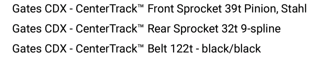

The number of teeth are mentioned in the bill of material, screendump attached.

The latest innovation is called “ANTISKIP”. This is a rear pulley that does not allow the belt to jump. Sounds crazy, but it's reality. Over the last 2 years we have developed a tooth geometry in which the belt hugs the pulley more and more under load.
A snubber (plastic jump protection) is no longer necessary. Wheel removal is simplified.
We are pleased to inform you that your bike is now equipped with this ANTISKIP pulley and hope you enjoy the bike
Kind regards...
So the ridges are there by design; interesting, and looks to be proprietary. May affect efficiency more than a snubber but who cares with an ebike. At 32T in the rear, would only really work with Pinion gearboxes and also 3X3 NINE, possibly. No go with Rohloff.
So what hub is used in the rear wheel and what standard is used to connect the sprocket? Shimano Surefit or Inter 5E or something else?
Nicolai already has the best belt tensioner out there and you can add this new rear sprocket to the list.
The new Hope Pro 5 hubs are installed there, in the rear in the powerful version for e-bikes. This means 54 engagement points instead of 108, but the locking blades are more robustly dimensioned.
The complete rear wheelset setup, taken from BOM:
"HOPE Rear - FORTUS 30W 29 - Pro 5 E-BIKE 32H - 148mm - HG STEEL"
It is Shimano HG freehub standard, 9-spline.

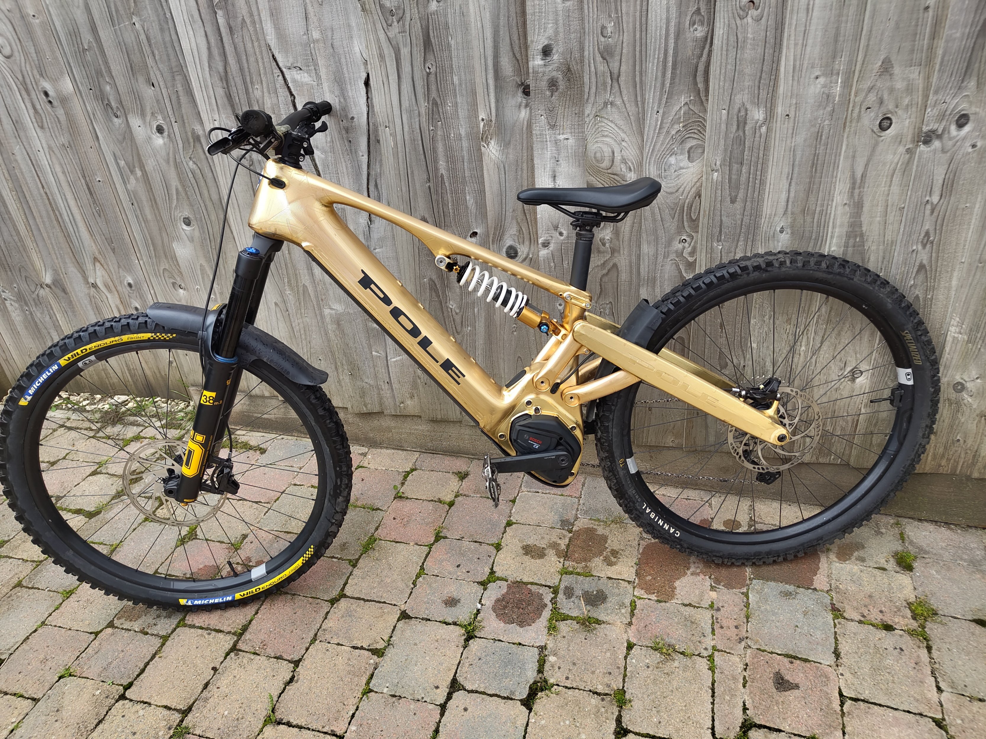

Think this will be my POLE Voima replacement...only thing that worries me a bit is the 160mm rear travel coming from 190.?
Pic for reference
