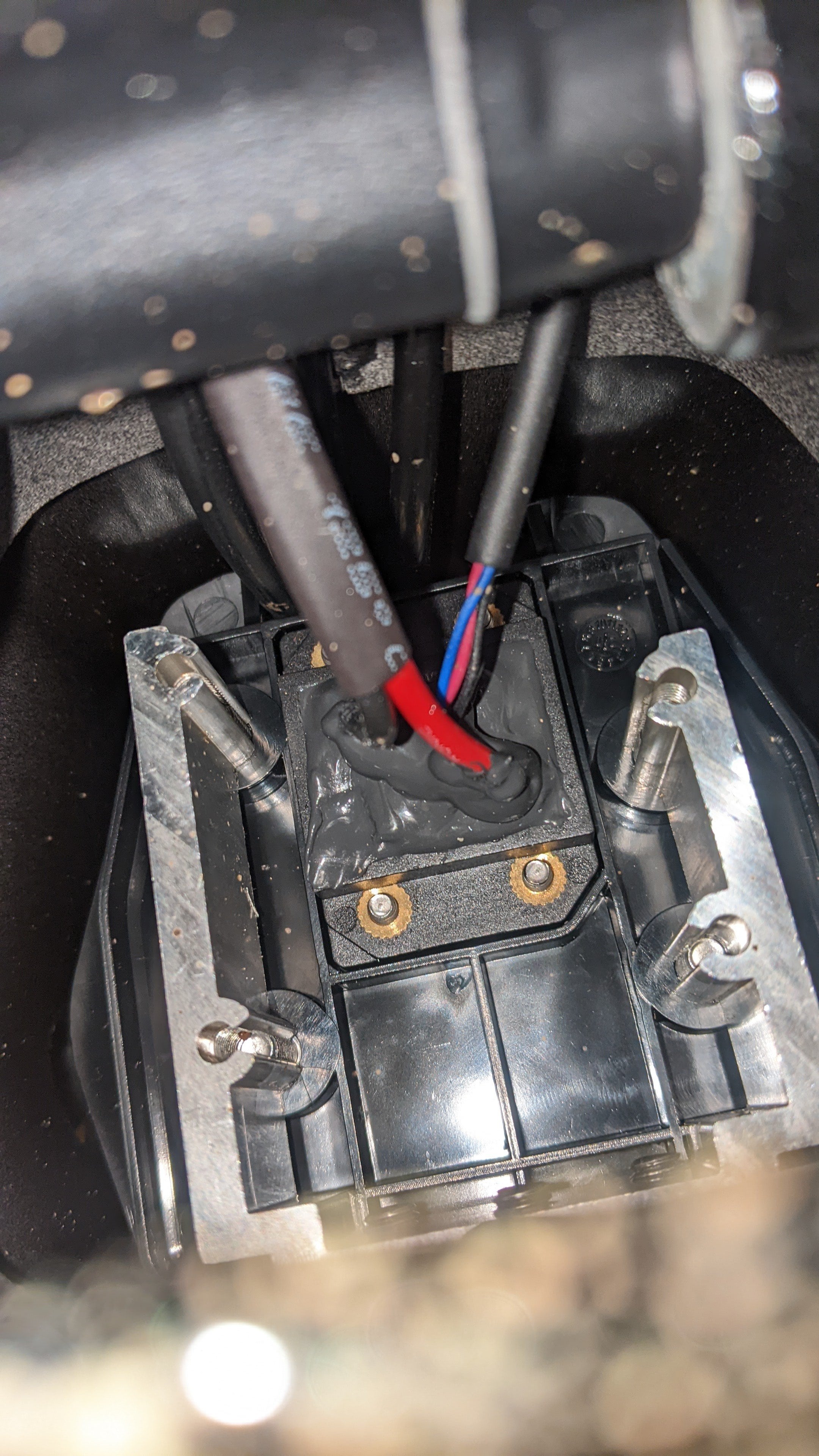

The battery itself: it has a RGB display and it's own power button. The light is Blue. If I hold it for 8 or so seconds it goes into a red mode. I can go back and forth from blue to red but can't get back to green. I read that there could be a sleep mode so that's why I tried holding the button for 8 seconds.

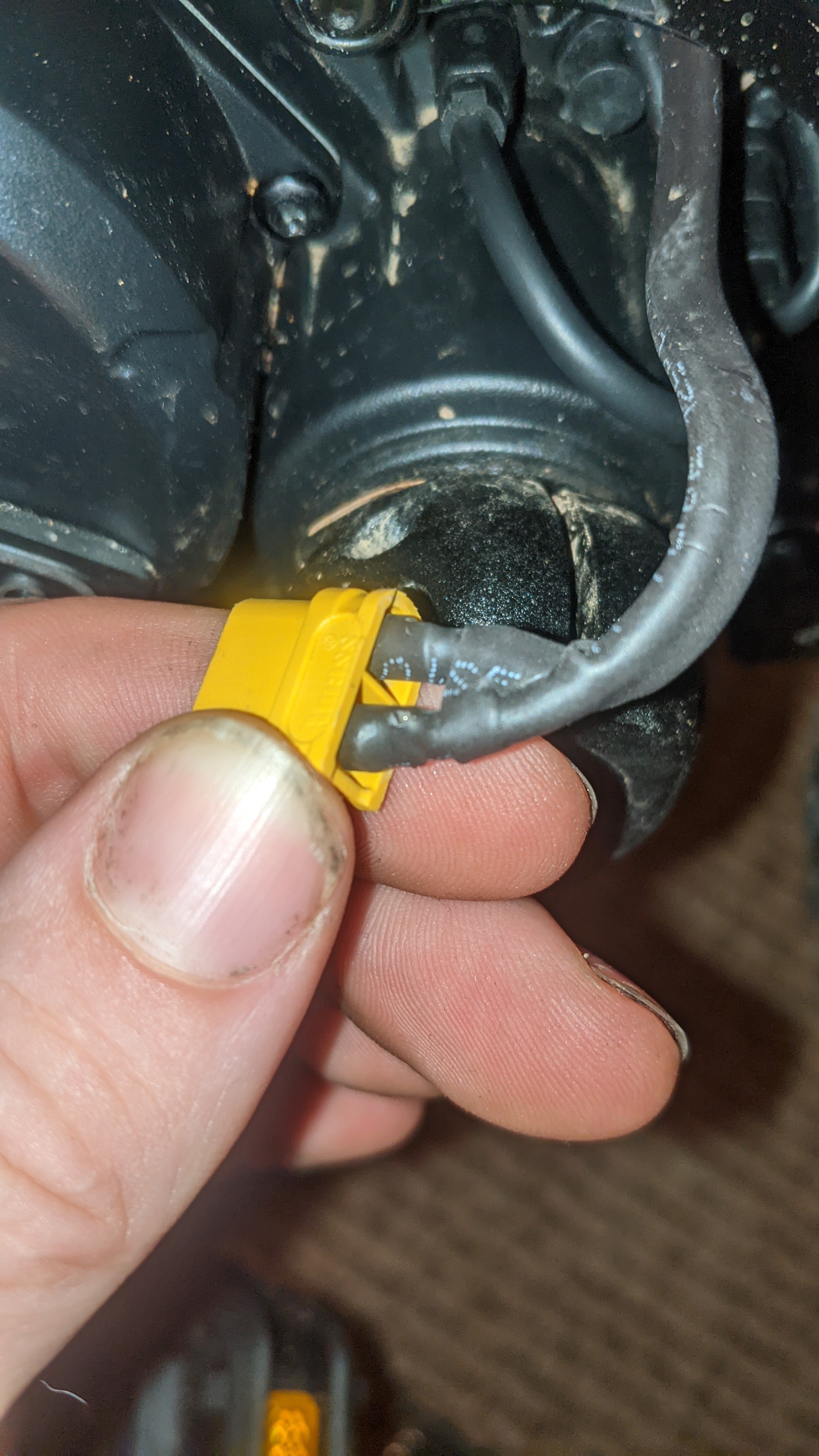

Hard to see but there does seem to be a tiny nick in the positive yellow cables heat shrink that exposes the pin.
The bike is my girlfriends and brand new. Will be contacting the seller as soon as I get her order details.

PXL_20230905_174558851.jpg PXL_20230905_174512234.jpg PXL_20230905_173854738.jpg PXL_20230905_173817995.jpg PXL_20230905_175628540.jpg PXL_20230905_175622914.jpg PXL_20230905_175029048.jpg

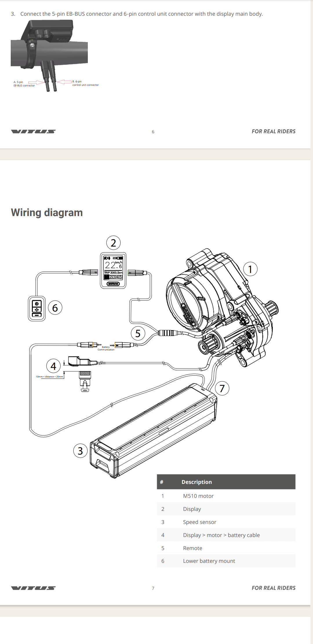

I've checked every connection to see if it's tight except for connection 5 In this diagram which I can't find. I suspect it's maybe inside the frame
I'm starting to believe that junction 5 doesn't exist?? It's not in the down tube. Remote plugs into display, then display runs into the frame, behind the battery and plugs directly into the motor. As far as I can tell. EDIT: junction 5 is on top of the motor tucked up into the seat tubes. There appears to be two connecters in there.

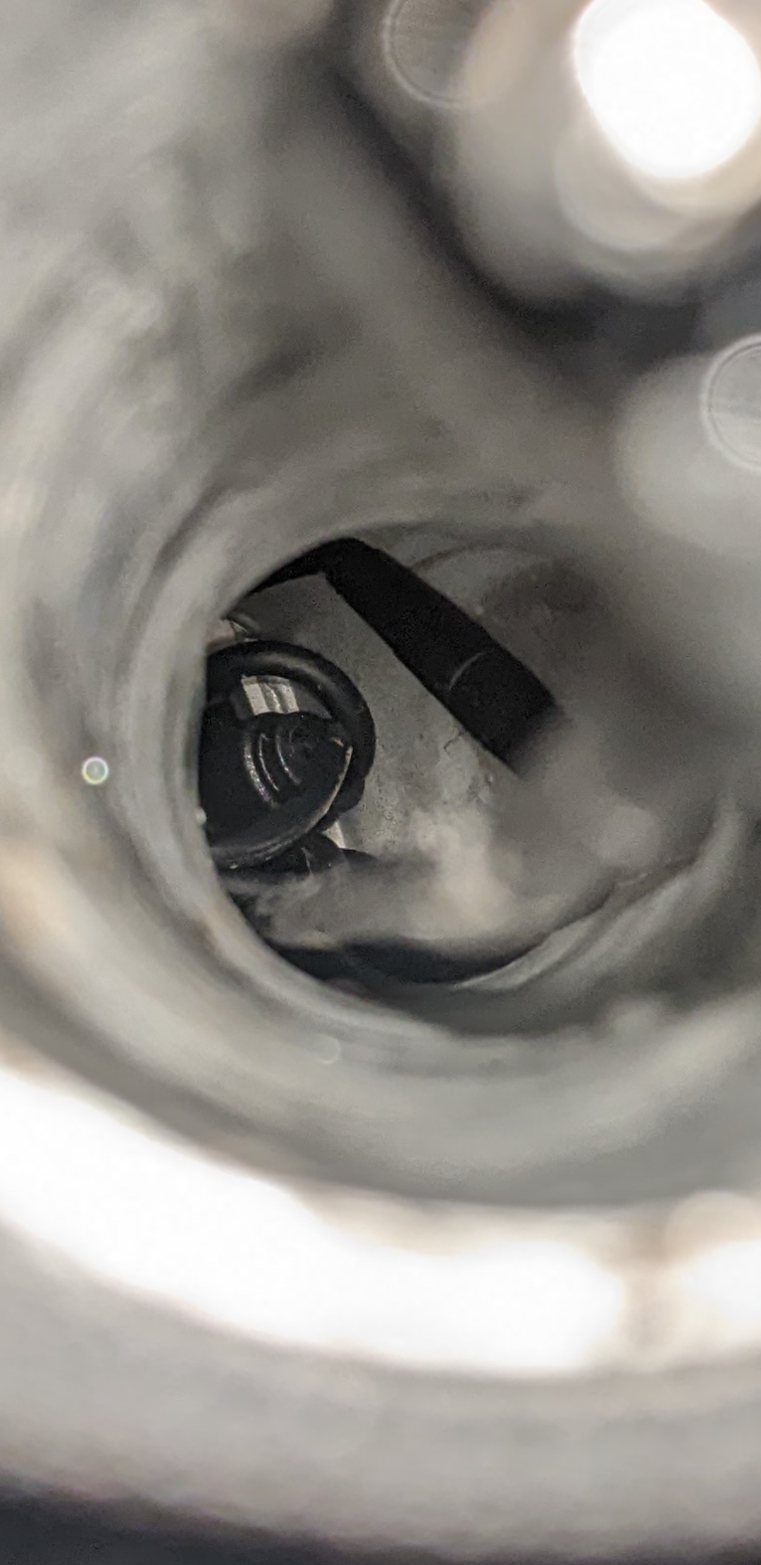

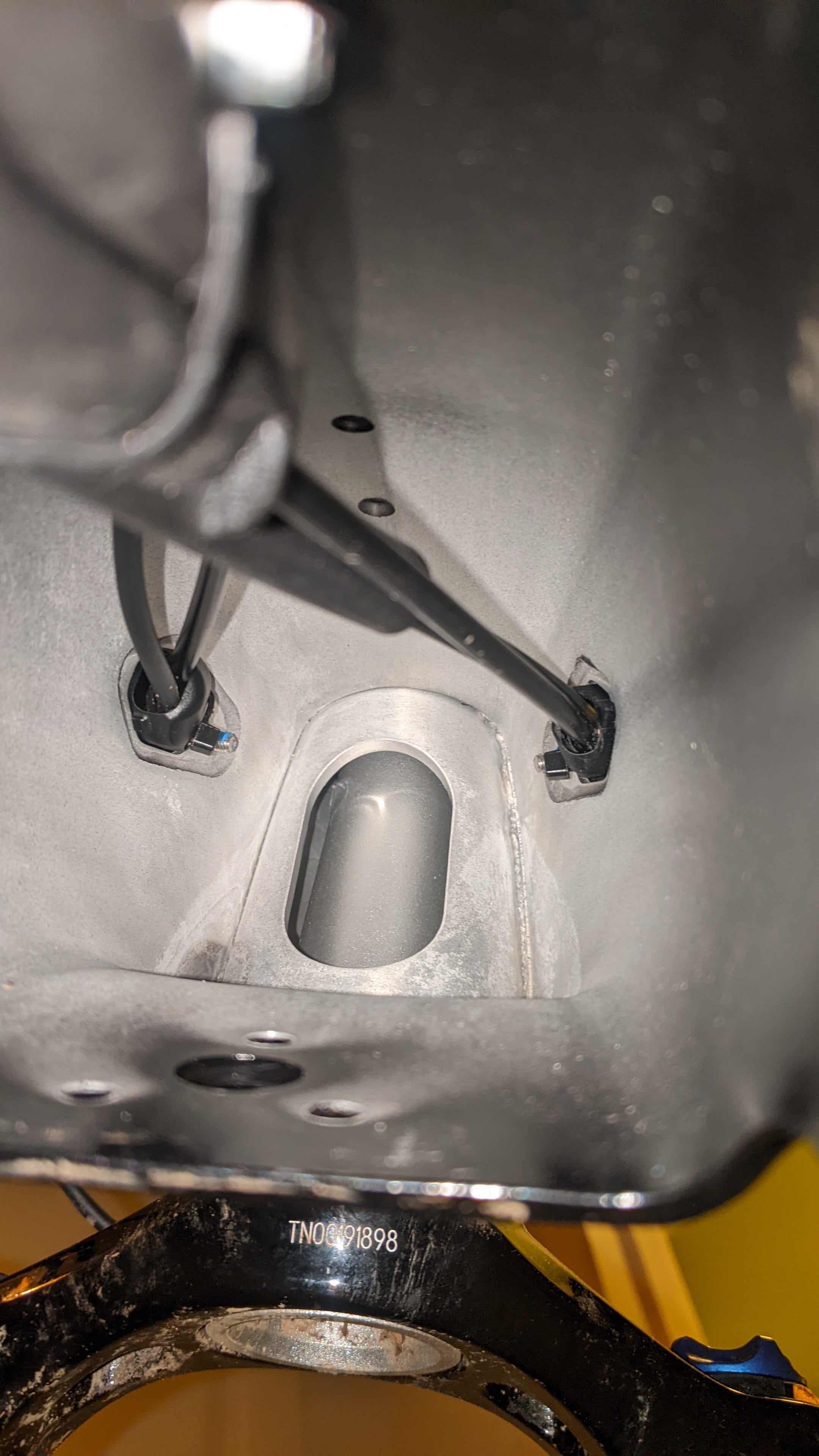

PXL_20230906_181106515.jpg PXL_20230906_181300190.jpg PXL_20230906_181156992.jpg Screenshot_20230906-194105.png
Do you think they might have been damaged by the dropper post ? There's quite a lot of space above the motor before you'd get to the dropper though.
It could just be something as simple as a faulty power button/that cable damaged.
I'm leaning towards it being the handlebar controller. Will have to go down the warranty route.

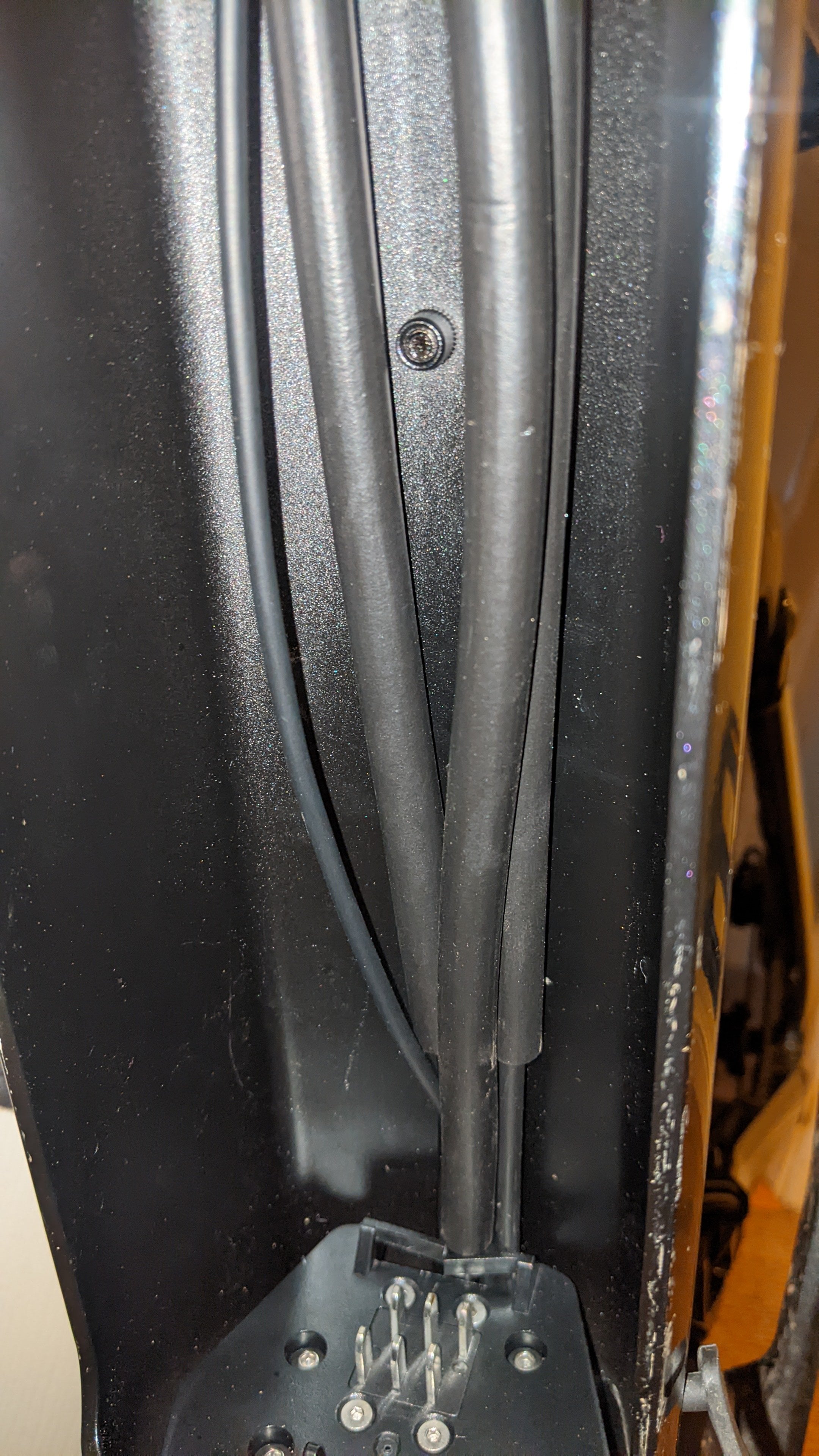

Yes, those connectors are pushed up the seat tube (I pulled my motor and took a look). Looks like there's quite a kink in the cable to going to the connector in your picture.
Can you pull the motor without removing the chainring?
Maybe it's possible (the only real issue is getting to the bolt that is behind the chain guide, which you have to get loose and rotate) , but I got a Park Tool BBT-18 (fits perfectly) to remove the chainring.
And if you don't have one of those then I think any Brose/Bosch 8 notch lockring tool will fit.

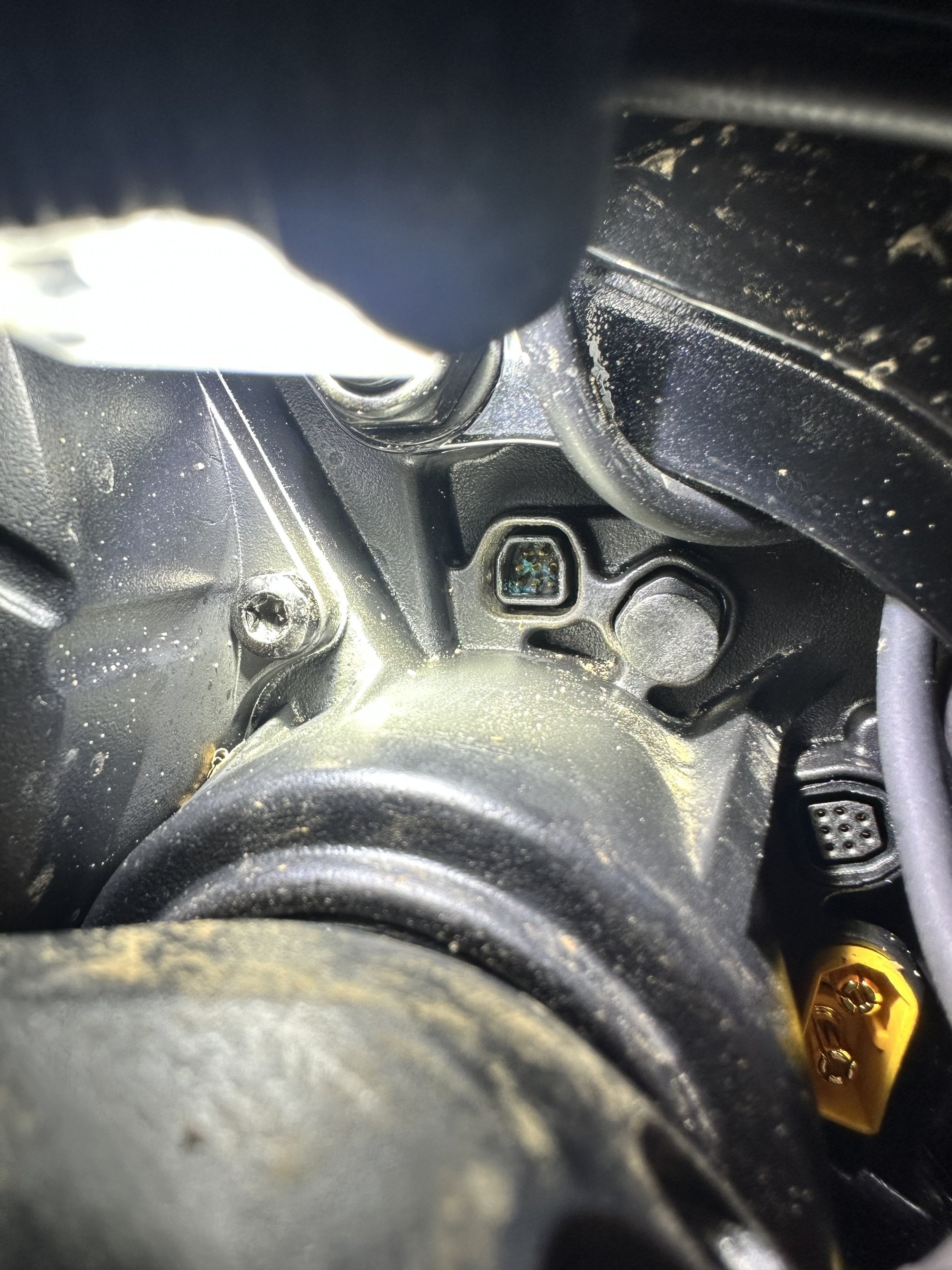

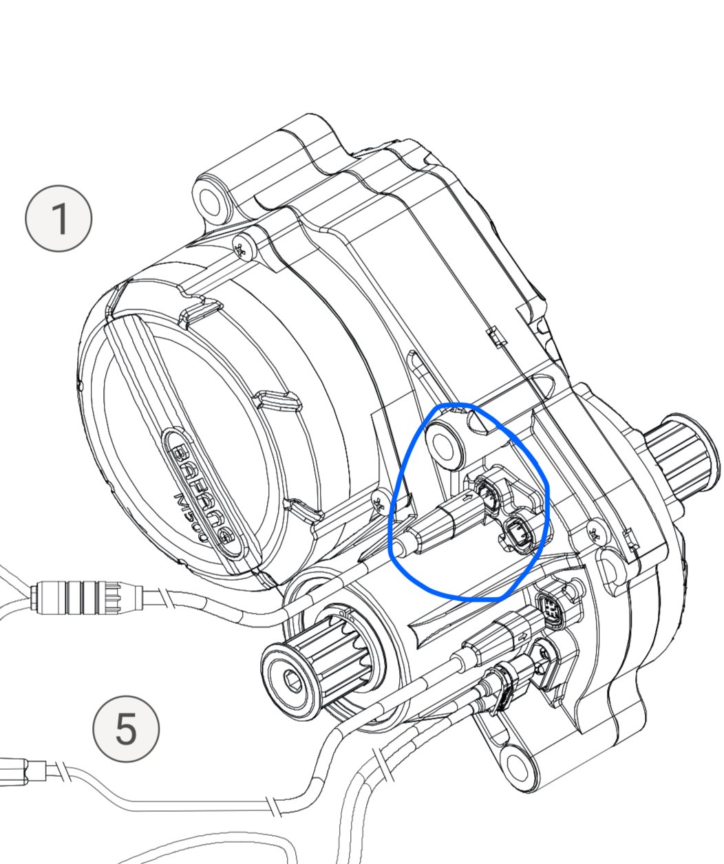

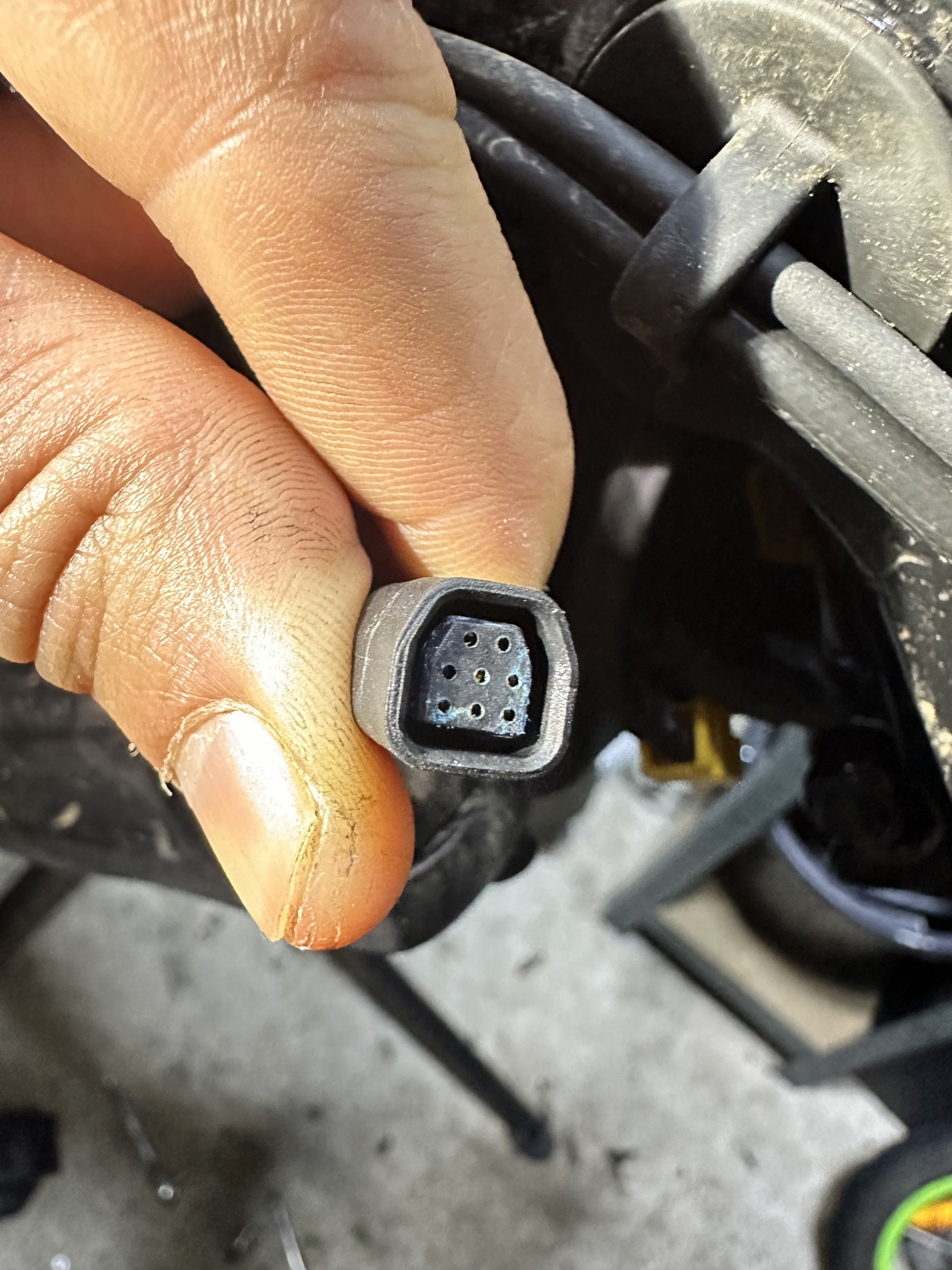

I did find corrosion in the connection from the motor to the switch which has since been cleaned out

This motor connector you have pictured, where is that located? Is it chain side or disc side? Is it easy to access just taking the top cover off or did you need to remove chain ring etc? I am mindful of warranties and don’t want to pull it all apart, equally if easy to access that motor plug I think that is a next step to try. Elec cleaner it and if it did get wet that would explain all the rest. Bike is dry now but would be good to check that connector
Left hand side from memory, remove the lower shield then 3 torx bolts to remove the cover
Initially, still didn’t have any difference. I put the cover back on and did same battery button thing but no display.
About an hour later I went back to it hoping for a miracle, I took battery off completely and clicked button. When I put the battery on the bike the display came on itself. I thought might be solved, for now. But nope.

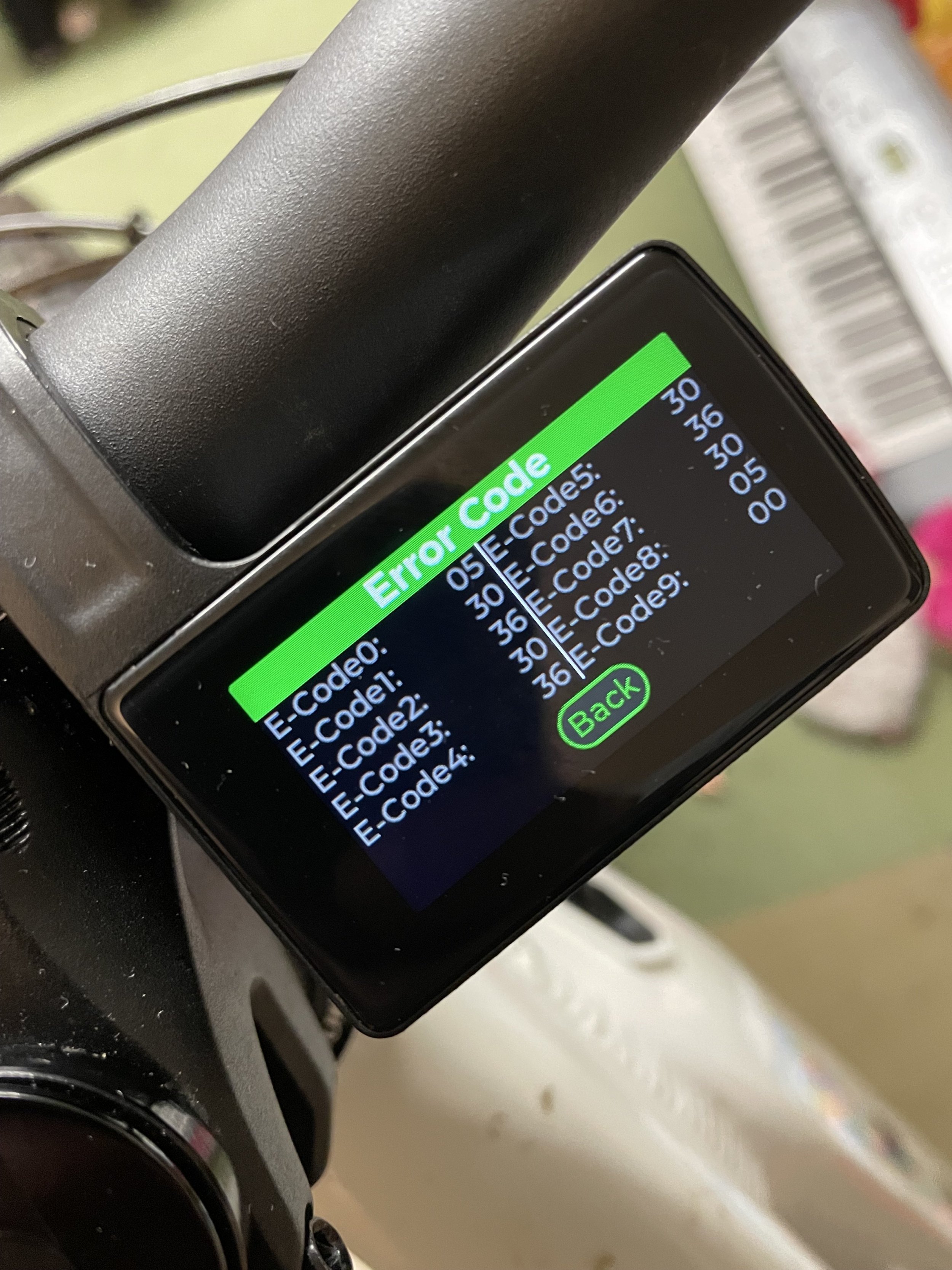

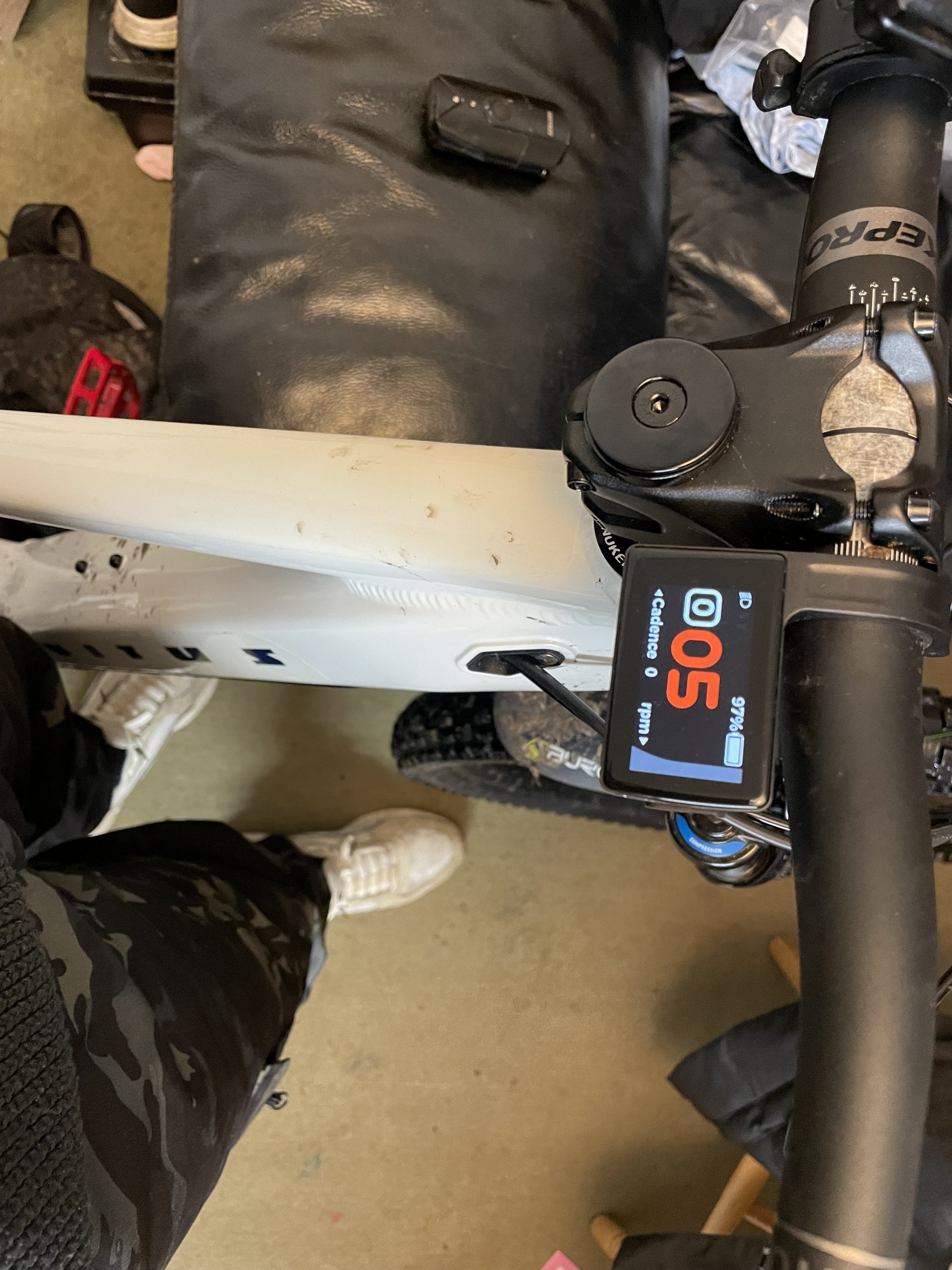

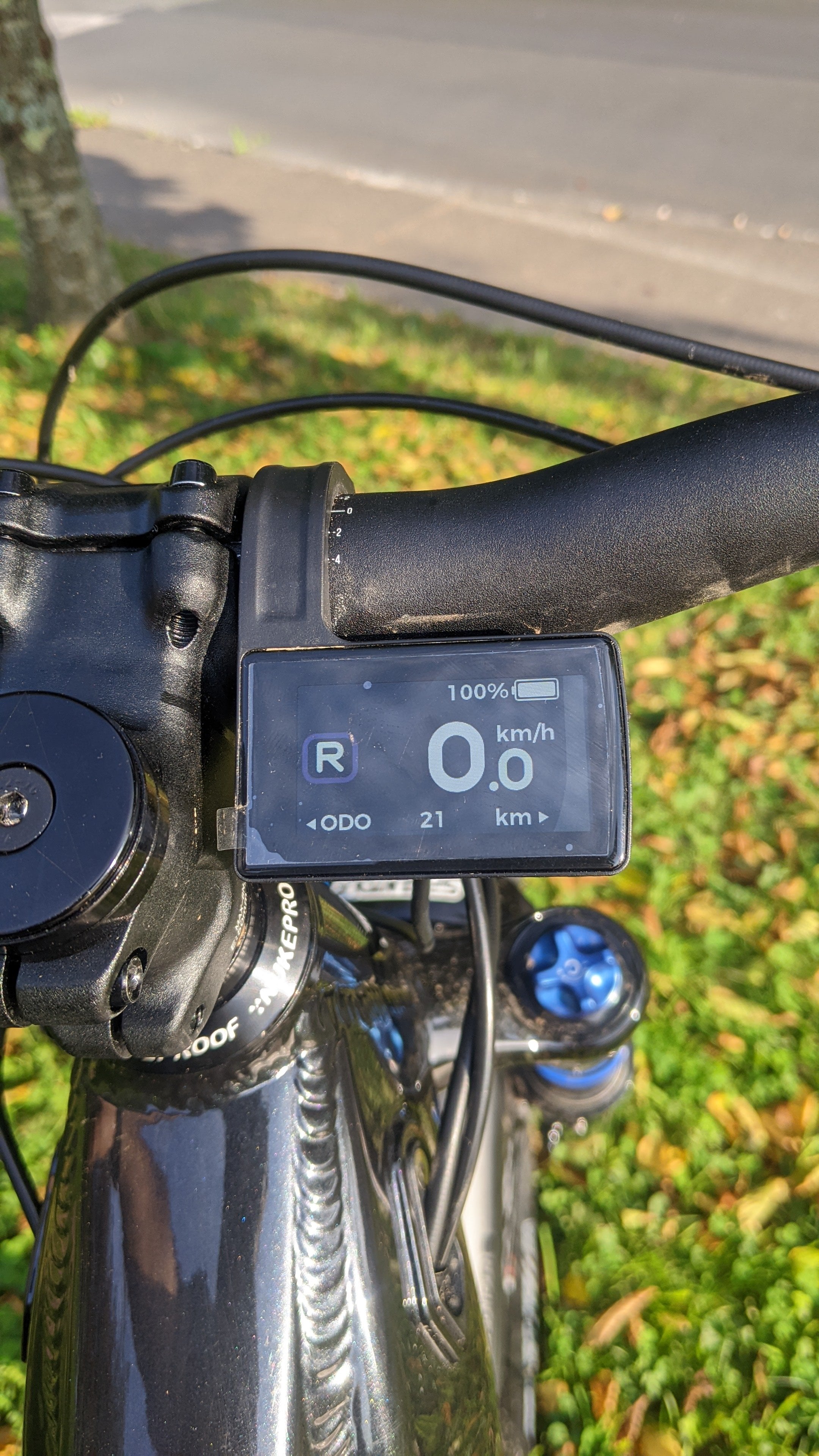

I now have a 05 where the speed would be. Bike clicks between eco and trail mode etc but no assistance from motor, as if bike is still off.
Speed is not being displayed as that 05 doesn’t go away.
I haven’t dared turn it off yet as know it won’t turn back on again..
Here’s the codes I’m getting now and the screen with 05 display.
All connections I can find are secure and ok that I can tell.
Think this is going to turn into a headache but open to any advice and pointers if anyone else has had this issue
