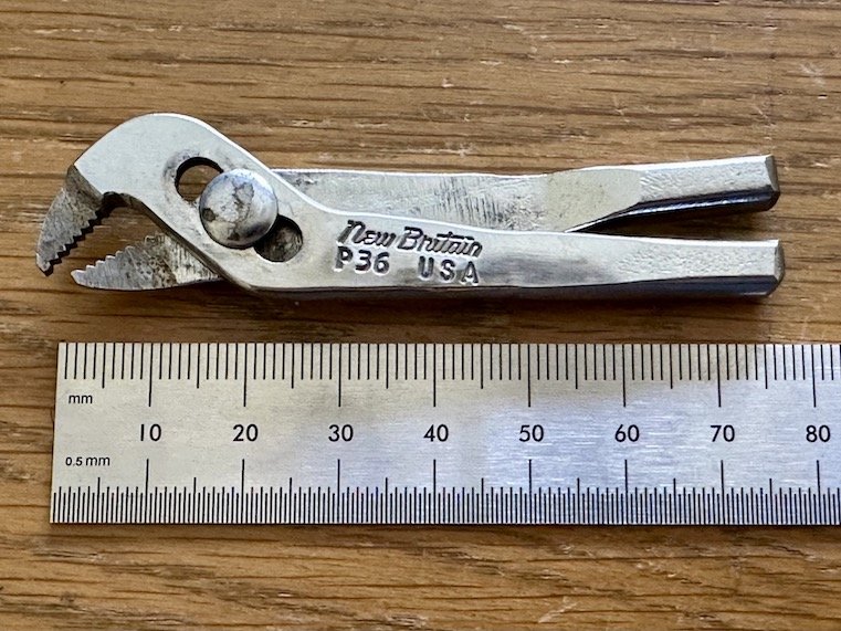

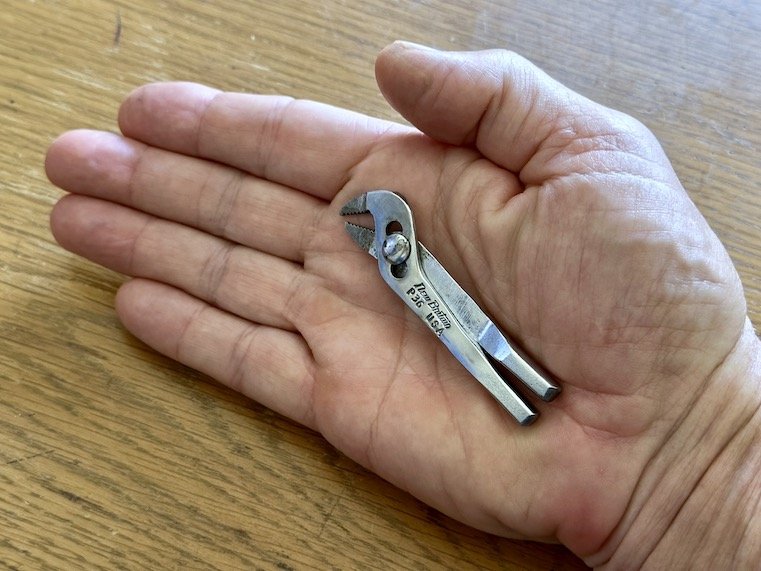

I normally don't carry such flamboyant luxuries, but epic rides require a more robust contingency plan. I had an old channellocks that weren't very useful, so I bobbed the handles and ground the jaws so they would fit inside a chain link. They fit in my tube pouch as if they're not even there. The weight is about that of two Gu Chews.

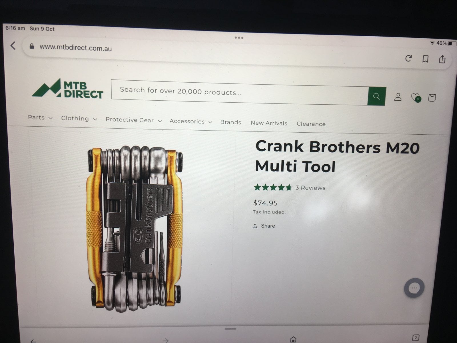

Best tool is crank brothers
