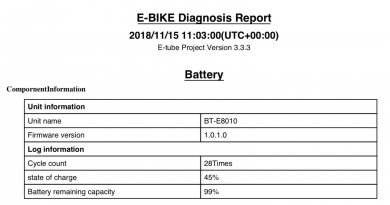

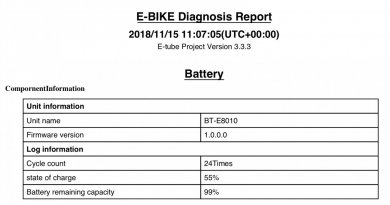

I was thinking we could compare the effects of the charging methods on the battery health and if any particular method is better or worth the 'extra mile' to preserve the battery capacity for longer. As far as I know, the battery diagnostic is possible by the user through the app on the Levo/Brose and the Shimano systems.
Here is mine:
2 batteries, 11 months, 24 and 28 charge cycles and 99% remaining capacity on both batteries.
After rides, I charge the battery to ~70-90% and before the next ride I top it off to 100%.
Here is mine:

Sounds like a sound strategy to me, though would not leave the pack as high as 90% betweeen uses myself, particularly if it was not going to be ridden for a few days - 70% is fine to protect against self discharge (which is a bit of a non-issue with Li batteries anyway). It certainly aligns with generally accepted best practice for the preservation of Lithium ion batteries...
