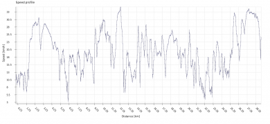

Took the first trip with new firmware. The rocks and roots were very slippery as it had been raining the whole day. I could say that the new torque adding effect is maybe not so exceptional. For this ride I had changed the new fork (Cane Creek Helm), new firmware, lowered the handlebar (1 knockblock ring) and the trail was slippery so there was many changes compared to previous rides.
My trip was only 28km long and speed was not much beyond the 25kmh limit. The Volspeed was installed before the update and I didn't remove it for the update. Have to admit that the Volspeed has brought the speed and joyfullness to riding in parts where you would hit the 25kmh "limiter".
No error codes now or in the past. Will report my experiences when I get more kilometers.

Hi Twallis, out of curiosity, how much battery did you go through for a ride like that? (and how many Wh is your battery?) Cheers
Nearly fully depleted 625 battery I had it in turbo most of the time.which eats battery quicker too. The last couple of miles I did increase to 27mph as I knew I would get home.
