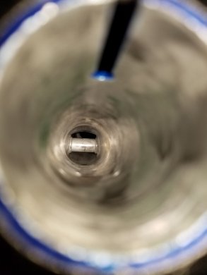

You inspired me. I have been able to run a small nylon strap between the motor connector and the seat tube with the help of a vacuum applied to the top of the seat tube. So I have a good path.
Oldcrank, did they run the cable through that little rubber plug that already has three cables/hoses going into it on the left side of the frame or the unused plug on the right side?
