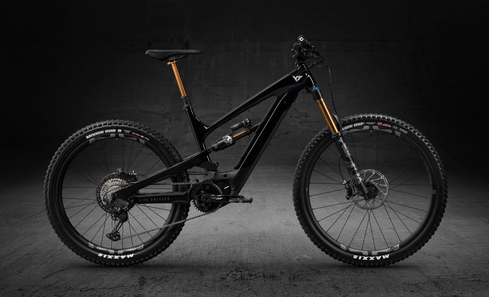

2020 YT Decoy PRESS RELEASE
2020 YT Decoy Comp, Dune Grey
2020 YT Decoy Pro Race, Titan Silver
2020 YT Pro Race, Black Magic
YT Industries sent shockwaves and turned heads in 2019 by releasing its first E-MTB. The DECOY redefines the common perception of E-MTBs and raises the bar when it comes to an agile and good- looking ride with a built-in lift.
The DECOY has uncaged gravity genes and the relentless mullet build offers the best of both wheels. This unstoppable enduro bike tackles every trail and even puts a smile on your face when you head back up technical trails to drop back in again for a second helping of gravity madness.
Offered in frame sizes S to XXL the Pro Race delivers a high-end spec to go with a full carbon frame whereas the Comp model has top-of-the-range components to round off the carbon front and aluminum rear triangle. Build updates for 2020 include the high-powered 12-speed Shimano drivetrain.

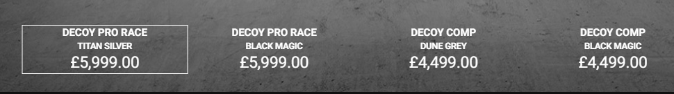

Only two models but three colour schemes for 2020 and a bump in price for the entry level model?!

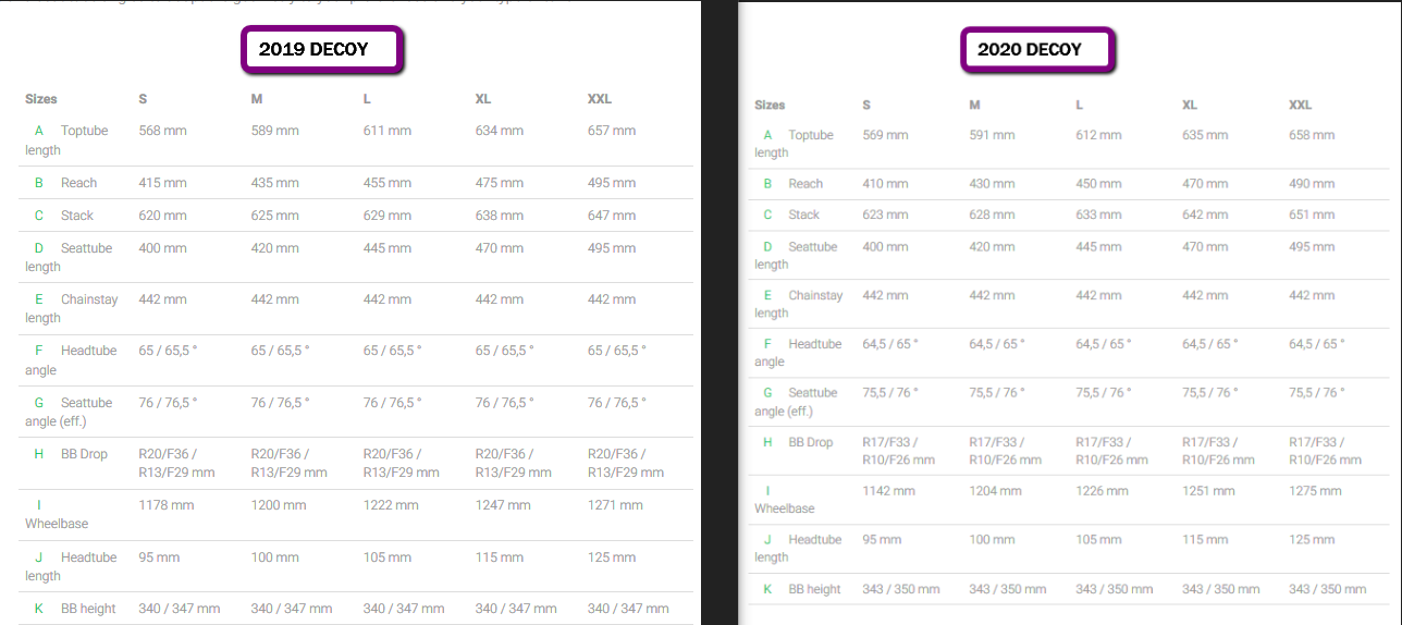

I find the changes modest but not overly surprising (except for the lack of a larger battery)
170 mm fork comments:
I tried every possible option to upgrade my 160mm version to 170mm :confused: and hit a dead end as it was not possible as the Fox36 E-bike optimized "chassis" fork uses a Fox 34 air spring (which maxes travel out to 160) due to 2mm thicker stanchions.
The response I received from my suspension tuner (through Fox) was (regarding a 170mm e-bike fox fork I located or even the existence of a 170mm e-bike fork):
Response from Fox: "Yep that's correct. That's the SKU for a complete fork from what I can tell. I found the tune ID (DY62). It seems to be described as for an e-bike but is a regular 36 in effect"
So did YT change the e-bike optimized Fox 36 (with the more ridged chassis and thicker stanchions) to a REGULAR Fox 36 (regular chassis) to accommodate switching to a 170mm option :unsure: . I need to find out :geek:
Longer stem Length :
Noticed also the stem is now 50mm in length vs 40mm (from 2019) .. perhaps to offset the higher front end from the 170 mm fork. Also the handlebar rise states 35mm instead of 30mm .. on CDN site ( I do not think Renthal makes a 35mm rise V2 Fatbar .. could be a typo?)
