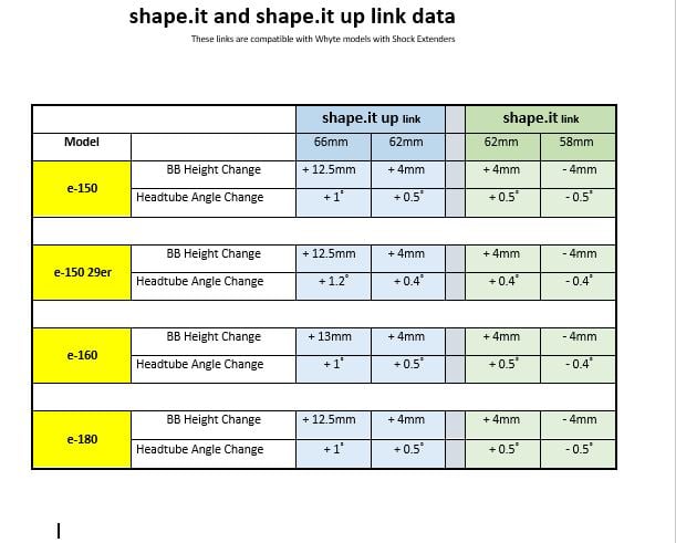

The Whyte website gives a guide for data , for the e150 with the 66mm link, it shows a BB height change of + 12.5mm with a head angle change of +1 degree.
I know eMTB reviews are full of stats and fiugures, most of which go right over my head, but will I notice this 1 degree increase in head angle? It would be slower, but much?
IMO - yes you'd notice a 1 degree increase in head angle and definitely the 12mm increase in bottom bracket height, not sure why you'd want to increase BB height and head angle though, I guess it will give marginally less pedal strikes but at the expense of downhill ability. If I had a problem with pedal strikes I'd be fitting shorter crank arms or learning to time pedal strokes better,or just living with it, I wouldnt be compromising downhill ability by steepening the head angle and lifting the BB.
Steeper head angle would be very slightly quicker/twitchier (steering).
I assume the benefit of one of these is you'd be able to adjust the geo back to as it was designed after you've fitted a fork with more travel like @1Squadr0n said. Can't get my head around what happens to the rear if you jack the bottom bracket up 12mm though ?

Bottom bracket heightmassively affects stability, cornering and braking.
I think the only reason to fit one of those links that raises the bb would be to compensate for lowering the bb too much(and hence head angle) by fitting a smaller back wheel

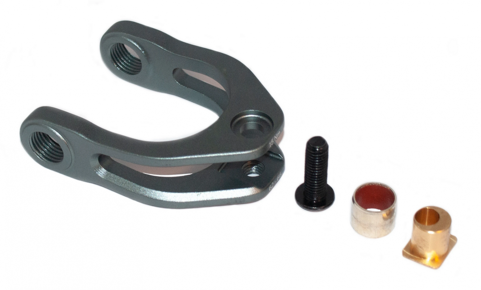

Are they adjustable then ? Some sort of offset bushing?
Yeah, you can see it here.
My take on this is it allows you to adjust a 2020 Whyte eBike to 2021 geo - about 10mm higher BB, you can run a 10mm longer fork. All you're missing is the extra 5mm travel at the rear.

It will be easy to fit, I would recommend using a torque wrench as they are alloy components/ threads. The only awkward bit is if the eye bush needs replacing.
