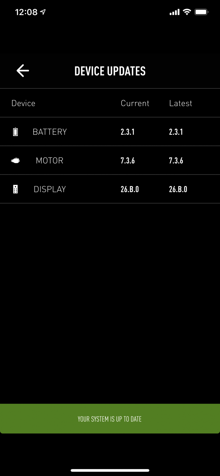

Had the update today, I was out the shop in ten minutes ? As usual great service from my local Specialized Concept store in Harrogate ? No charge although it is where I bought the bike from.

More information to help those who are asking: just had a motor replaced this week under warranty that developed sounds typical of a belt that is about to go, and the torque sensor was not working correctly with multiple surges of 100% assist throughout every ride, had about 1050 miles with frequent very steep sustained climbs in turbo with sections steep enough that crank cadence bogged down but could still power through and regain cadence, which is probably the cause of the failure. As an aside, I'm now going to stop and get off to avoid bogging down in the future to help the motor last.
Replacement motor was built 6/19/20 so it is a new motor with the improvements. I am happy to report that it is quieter than the first motor significantly quieter, seems to have just as much power, and I don't really notice any drop off in the assist on very steep sections compared to initial motor.
This motor does have all of the latest updates to the motor/display/battery. I am really quite happy with this improvement. Walk assist mode does not engage immediately but does so after about 10 seconds. I'm sure Specialized will sort this out. I am usually able to push the bike up just about anything and don't use walk mode much anyway so it doesn't bother me.
Mainly wanted to get it out there that I did not see any drop off in power assist with the updates, however this is not a 2019 motor.
I don't remember earlier in this thread if @Specialized Rider Care stated that all 2021 bikes that are being sold have the motor improvements even if they were built in 2019? That seems to be the relevant question at this point. Anyone remember?
