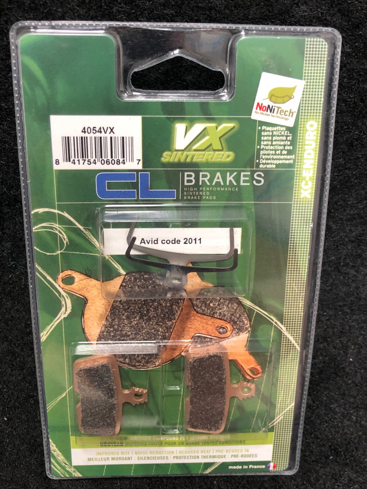

Hi Guys, I'm the importer for CL Brakes (Motorsport) in the UK, I have a 2019 Levo myself and the Guide RE were ok, but a bit mushy and the brake lever travel a bit excessive for me, I really like an aggressive set up. Ive put the CL Pads in and the difference in lever was dramatic right away and a few minutes up and down the road the pads bedded right in, power is also improved.
I am looking to put stock in next month, I've put a couple of sets out there with other people and results have been the same.
So initial stock may have a lag until i get a handle on it, and production starts, Price should be £19.95 to your door.
We will go online soon with sales, but initially its email or phone.
Cheers Paul.
CL Braking UK Sole Distributor of Carbone Lorraine Brake Pads...Paul Chance +44 (0)7974 153967

I put them in my Previous Cube Hardtail on Deore 2 pots, and they brought that brake system to life too..
