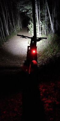

I would be so nice if there was a lamp on the market like picture below. 22 watts and 2600 lumens. Lupine sl sf is neat in the streets but beam is a bit limited to the trails. No scattered light at all.
Rob, kudos on your solution. I went the opposite way and purchased the Lupine SL SF (the new light) and it works great, in spite of the concerns of Dave from Lupine. I have to say it is the most elegant and usable solution, however it's significantly more expensive than your option. If you are willing to spend the cash, it's well worth it. Anyone interested reach out to me directly and I'll give you some tips that will make the install a little easier for you than it was to me.

I took my inaugural night ride with the Lupine SL SF system tonight. Worked seamlessly, plenty of light, though not quite as much as my $400 Serfas True 1500+ system.... Started out with a little light and the light automatically ran as DRL, then as I got into the woods, it automatically switched to Low Beam.... switching back and forth was really easy with the handlebar controls... So much better than having to remember to charge and install the Serfas system, and having the opportunity to end up unintentionally riding into dark, which is very easy this time of year. I give it five stars!
