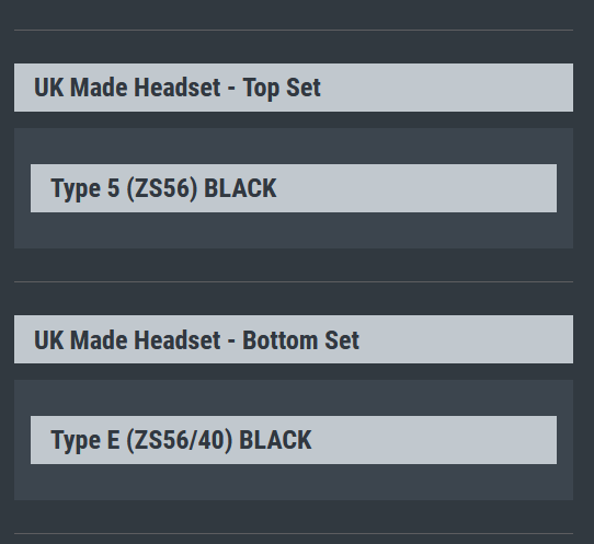

Hi scjgreen
I've only been out once with new headset but all is good. My stereo hybrid 160 tm is 2020.
I'm not sure of the size or your headset, it may differ model - model and year of bike. If you compare the specs of my bike with yours on the cube website and they are the same spec then the headset in the previous post will fit.
Please check it first.

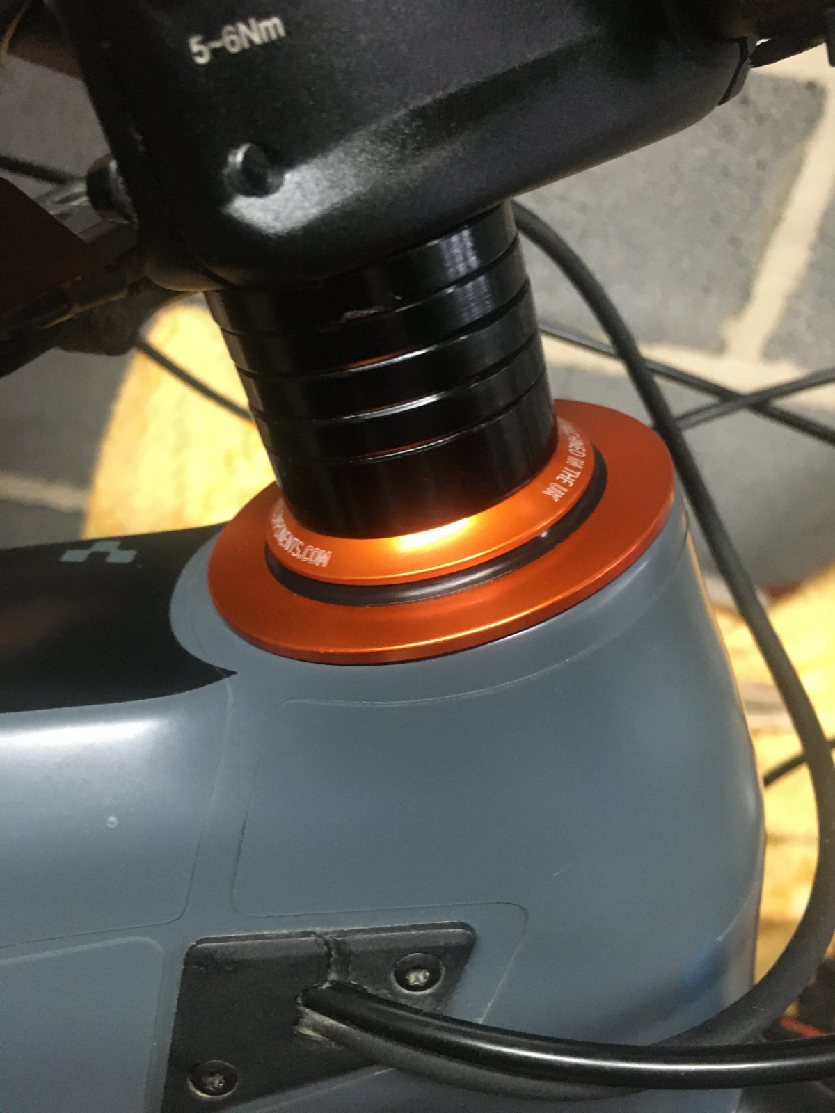

I have just fitted the Superstar headset as @Ski-nut has done (the same as @scjgreen lists above).
The difference is astounding. The bearings are a nice fit with no play, which meant that on setting the compression, very little tightening of the bolt was needed.
Haven't actually test ridden yet but so far I'm really pleased with it.

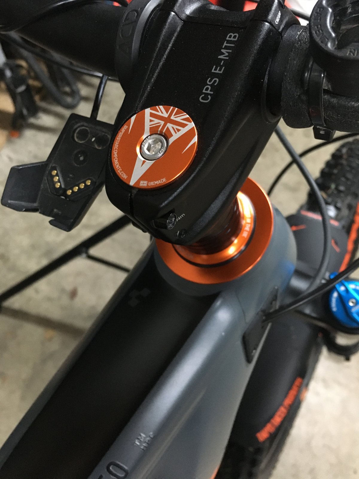

Ok finally got my superstars headset and put it on with the horizon stem and bars looks and feels great.
Unable to ride it yet due to the weather here at the moment.

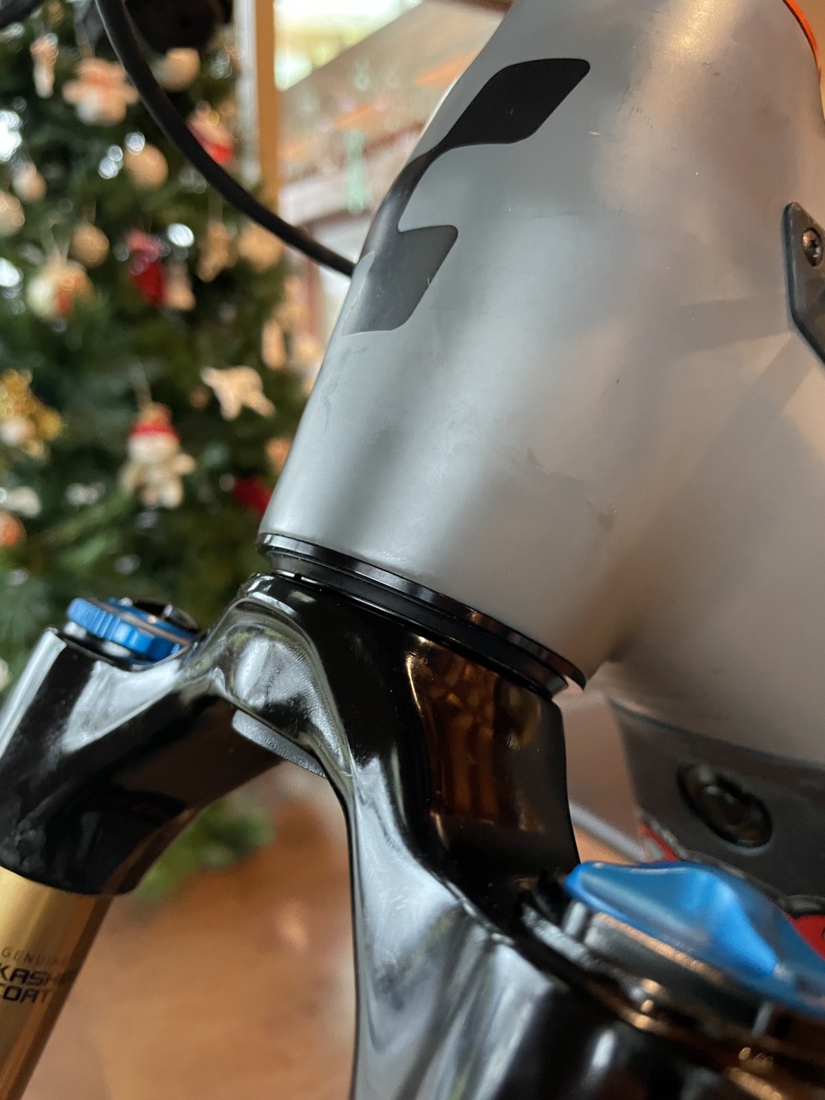

This is the first Fox fork I've owned and was surprised that there wasn't some form of cut-out on the fork crown.
Every other fork I've had has had a little cut-out where you can get a flat screwdriver under the crown race to start it off.
But, as with the cups. go gently and you'll be fine.

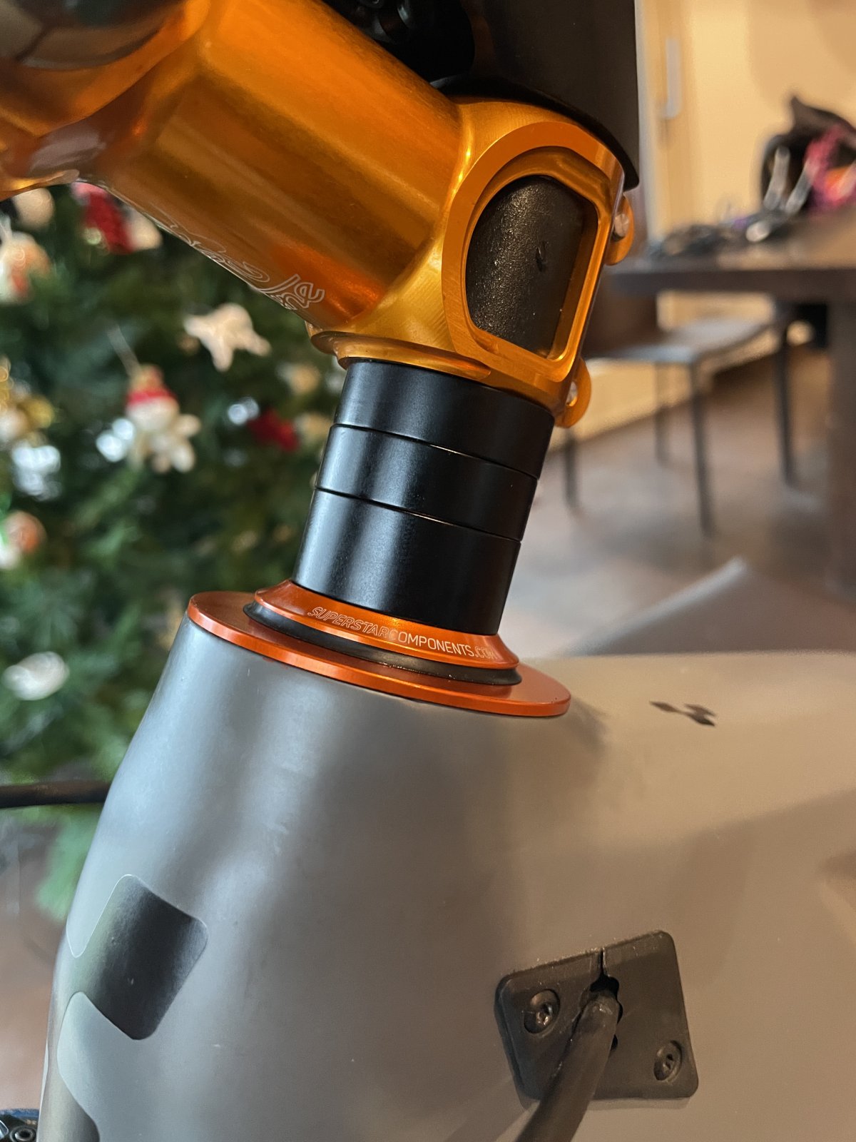

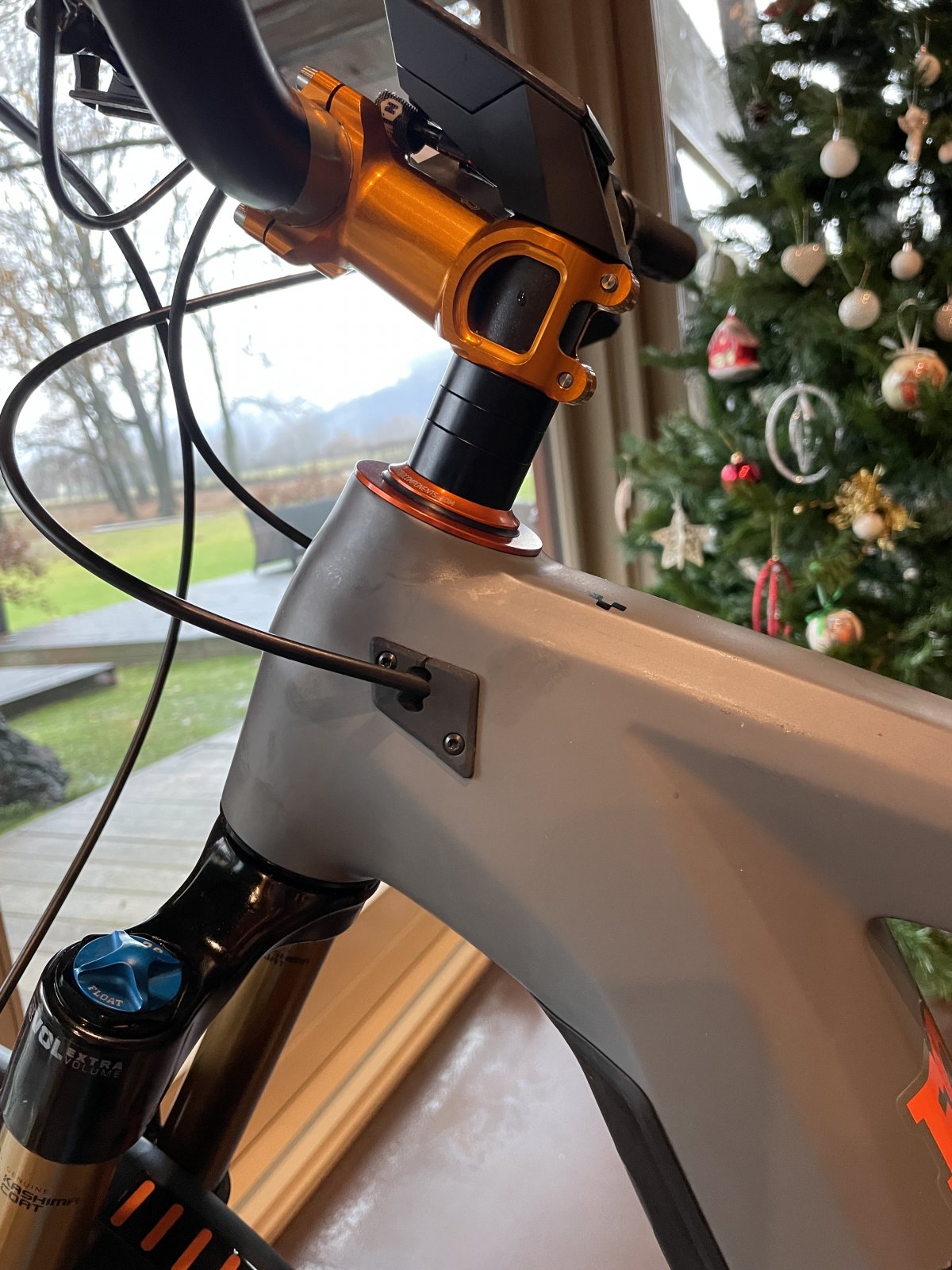

Hi guys and thanks once again. for this great topic.
Here the superstar, mounted on my cube, excellent product. Waiting for the first ride :)

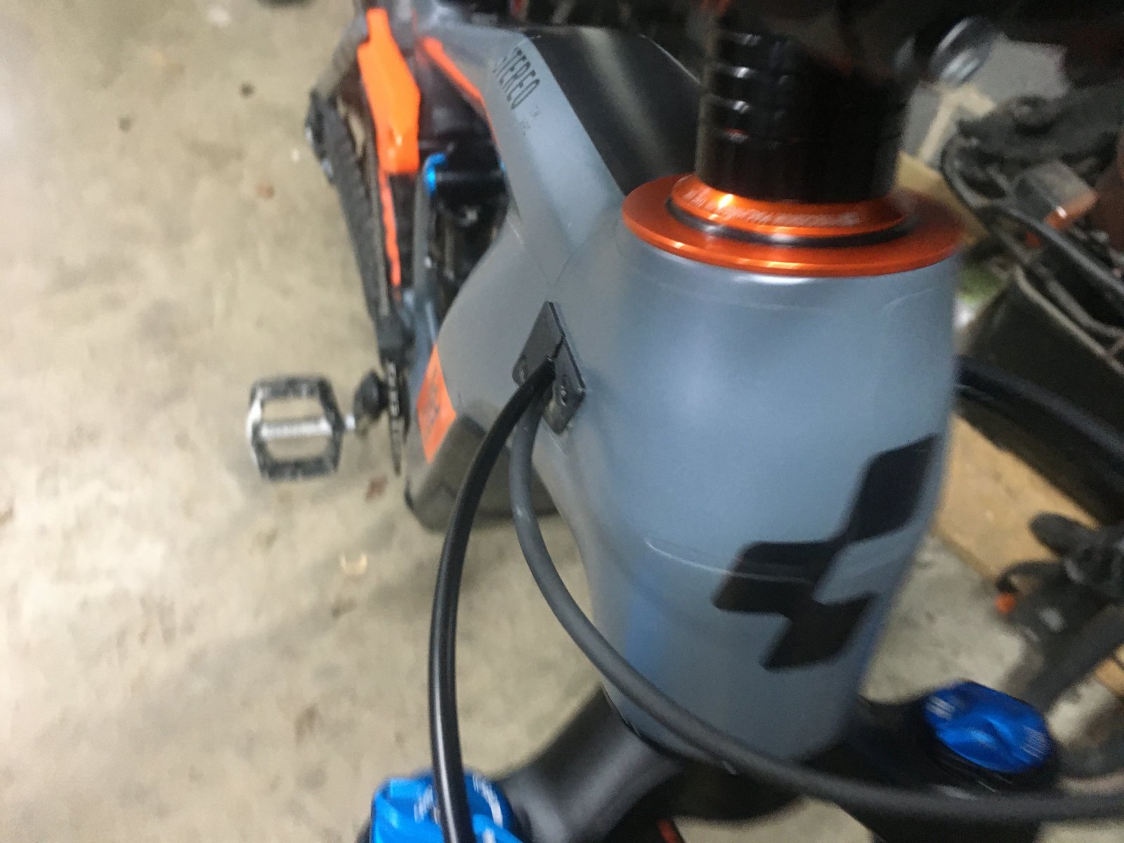

Just fitted the Superstar headset. It was the easiest headset change I've ever done. The cups almost went in with thumb pressure?
It is a beautiful piece of kit, but what a piece of crap the original FSA orbit was. How did Cube justify putting such a poor component in a nearly 4 grand bike?
I see they have changed them on the 2021 bikes t Across.
