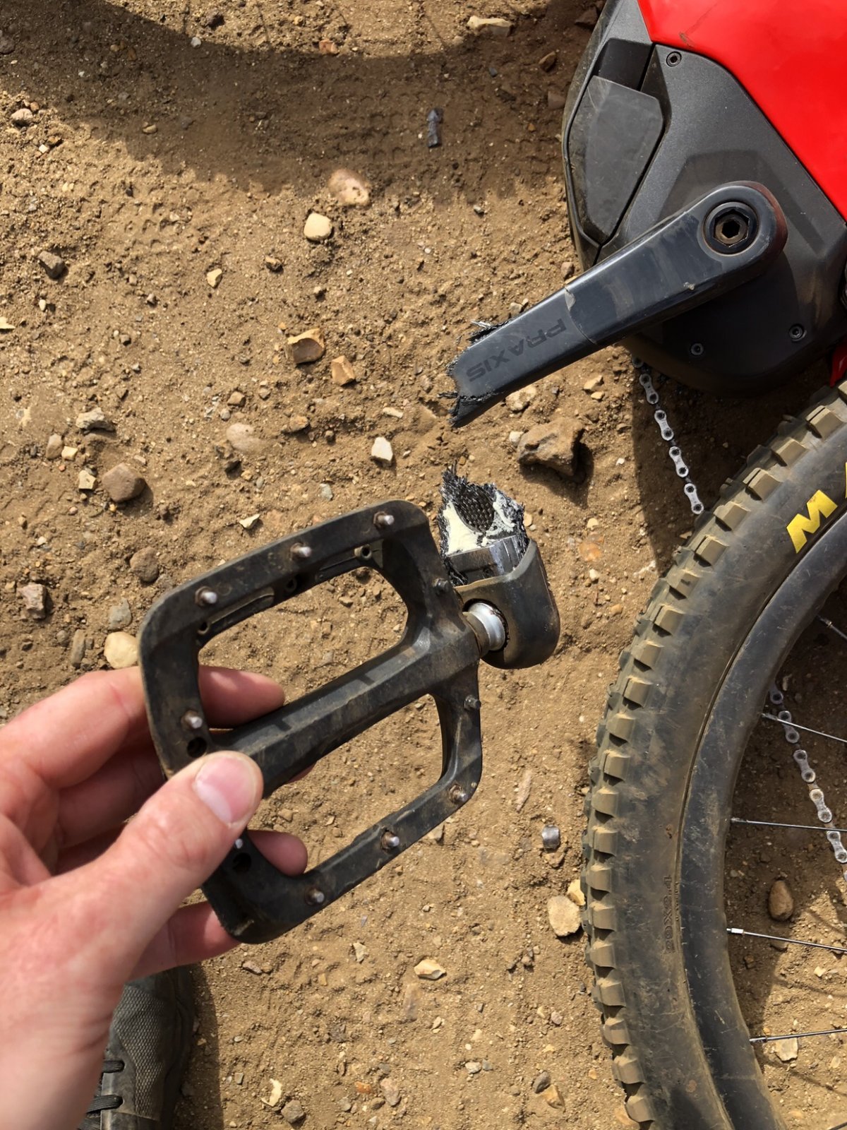

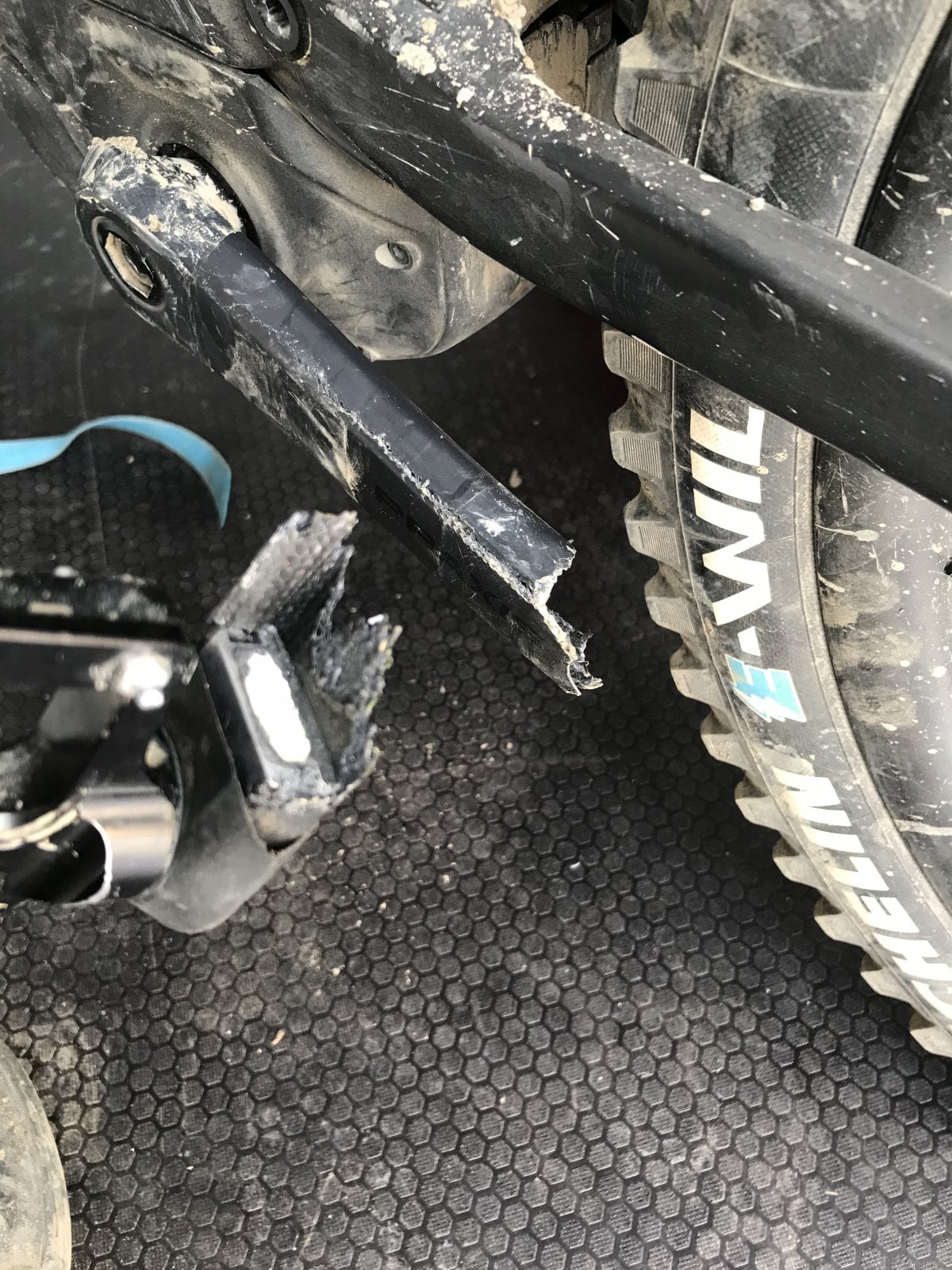

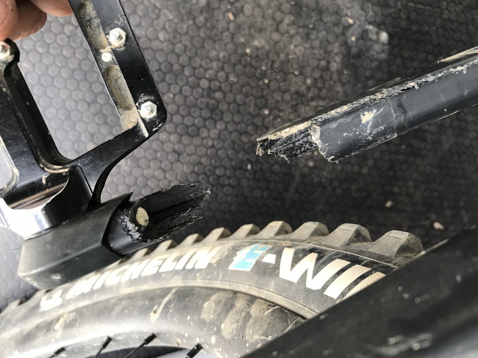

Hi all, has anyone had any issues with breaking carbon cranks on their e-bikes? I have a new 2019 S-Works and within the first 20 mins of riding it, for the very first time, the end snapped off the end of the crank following a minor pedal strike. I was riding up a mild gradient that was winding and quite rocky. It was a relatively mild pedal strike on the end of the pedal, insignificant enough for me to not give it another thought. Unfortunately this meant that when I went for the next push down the pedal was no longer under foot and I went over the handle bars. More than a bit embarrassing! When I picked myself up and worked out what had happened, the guy that I was riding with (on a Giant e-bike) and just stood and looked at each other in shock. The end of the crank had snapped clean off as per the photos attached.
I pushed the bike back out of the forest and straight into the supplying Specialized dealer (who luckily are right outside the forest). They too were shocked and took photos of all the damage.
To cut a long story short, the cranks were sent back to Praxxis with the pedal and they say there was no manufacturing fault and it was due to the nature of the pedal strike. Both I, and the LBS believe that if that is the case, how can they be fit for purpose?

That's a pretty serious pedal strike though by the pedal.

I think hitting the outside of the pedal leverages the impact forces on the crank. It exerts its power on the mid of the crank instead on the crankshaft (perhaps, luckily so). I've had a Miranda Alu crank totally bent inwards, and it wasn't even the sort of impact that would deadstop my pedalling. You just hit it on the weakest possible point.

I've beaten the hell out of carbon cranks without issue, hundreds of direct rock stikes at least. You should see the pedals I used to ride lol. I used to be a test rider, so that was part of the gig, see what it takes to break stuff. That is definitely a defective part. Praxxis should have replaced them asap just to keep you from spreading those images.

That’s interesting that you think the pedal show a serious pedal strike? I think it shows that it was actually minor and glancing (which it was)?

That was my thoughts, and that of the guys in the local bike shop.

My Sram carbon cranks look like crap at the ends from strikes. I had a friend with the same Sram cranks, fairly new like yours and broke just like yours. Sram warranties it no questioned ask, and replacement cranks have been solid.

Hmmm....dear mr praxis, can I please have my cranks back so I can have them independently tested , and then advertise the results of what you consider acceptable construction?
Oh, and dear specialized ....praxis thinks this is acceptable - do you?

I didn’t get mine back either. To make matters worse, one of the fork CSUs was damaged in the crash. As they refused to cover the cost I decided to get the shop to replace it anyway. They ordered the correct E-bike specific part but when it arrived, it turns out that the forks fitted to my bike are not the E-bike version at all, they are the standard fork. It even has the E marking on the leg. The shop have had to send it back and get the standard CSU as the piston and valving won’t fit. I am waiting for a reply from Specialized regarding that one!

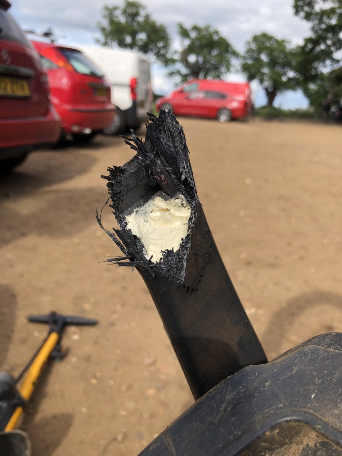

I snapped a carbon Praxis crank arm a few weeks back. Looks to be almost identical to yours. View attachment 14830 View attachment 14831
I would say that one has delaminated .....no way the carbon laminate should not be stuck to the foam core. I am surprised looking at the pics of broken cranks that no form of sandwich is used in the layup. Also the rectangular shape would normally be reinforced on the corners with a stronger laminate ......dont like the construction method at all!
