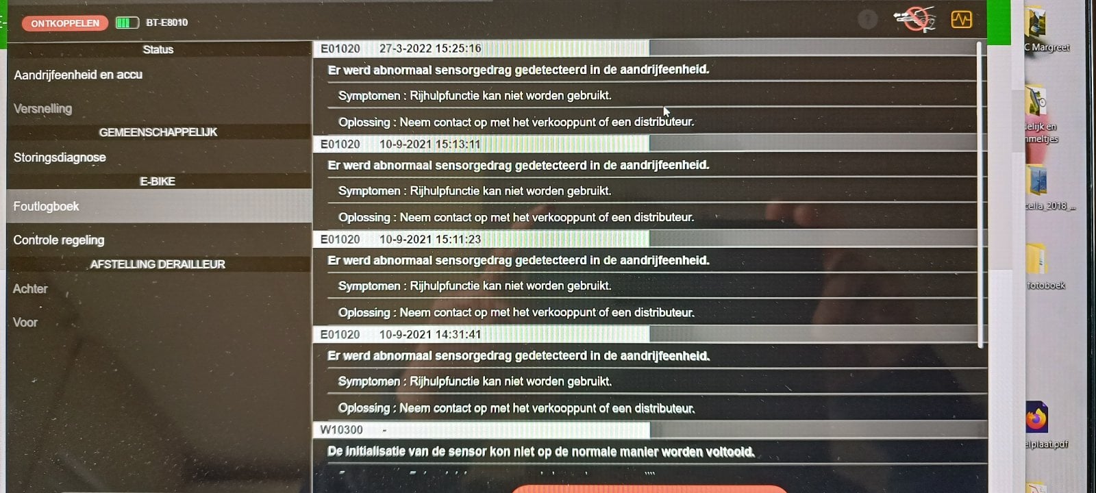

Sadly my bike is beginning to develop E010 errors...
First time that happened was in september 2021, turning the bike off and on again several times gave no result. Fortunately this happened during a short pause on the last downhill of a week of biking in the Italian Alps (holiday). So I got down without assist (that was easy :)) to the small village we stayed in, had a drink, did nothing to the bike and powered it on again. The error was gone, and it was trouble-free until three weeks ago when I got the E010 error again, this time while pedaling. At first the assist was a bit irregular for a few seconds and then it cut out completely. Turning the bike off and on again didn't help so I cycled back to the car without assist.
Put the bike in the car, drove home and then the problem was gone... without doing anything to the bike.
First time in the Alps the motor had almost 5.000km on it.
Last time the odometer showed about 5.600km.
The bike is a Merida eOne-sixty 900 which I bought (new) in june 2018, so almost four years old now.
I bought the SM-PCE02 unit to link the bike to my pc and the error log file looked like this:
For those who don't read Dutch ;): "abnormal sensor behaviour was detected in the drive unit".
I suspect the torque sensor in the motor to be the cause. Contacts are clean, battery holder is adjusted correctly, I try to avoid riding in muddy conditions (I use another bike when there's a lot of mud) and I don't wash the bike often.
I haven't tried to contact Merida or Shimano because the bike is almost four years old and way over the warranty of two years. Maybe I'll give it a try anyway after having read the first message :)
But I do think that less than 6.000km is way to soon for a motor to die. For some that means less then one year of cyling! (I have other bikes too so don't ride the Merida every week).
Because I like riding the eOne-sixty very much and I can't sell it for a good price anyway with these errors I ordered a new motor through eBay. Hopefully that'll last for at least another four years!
