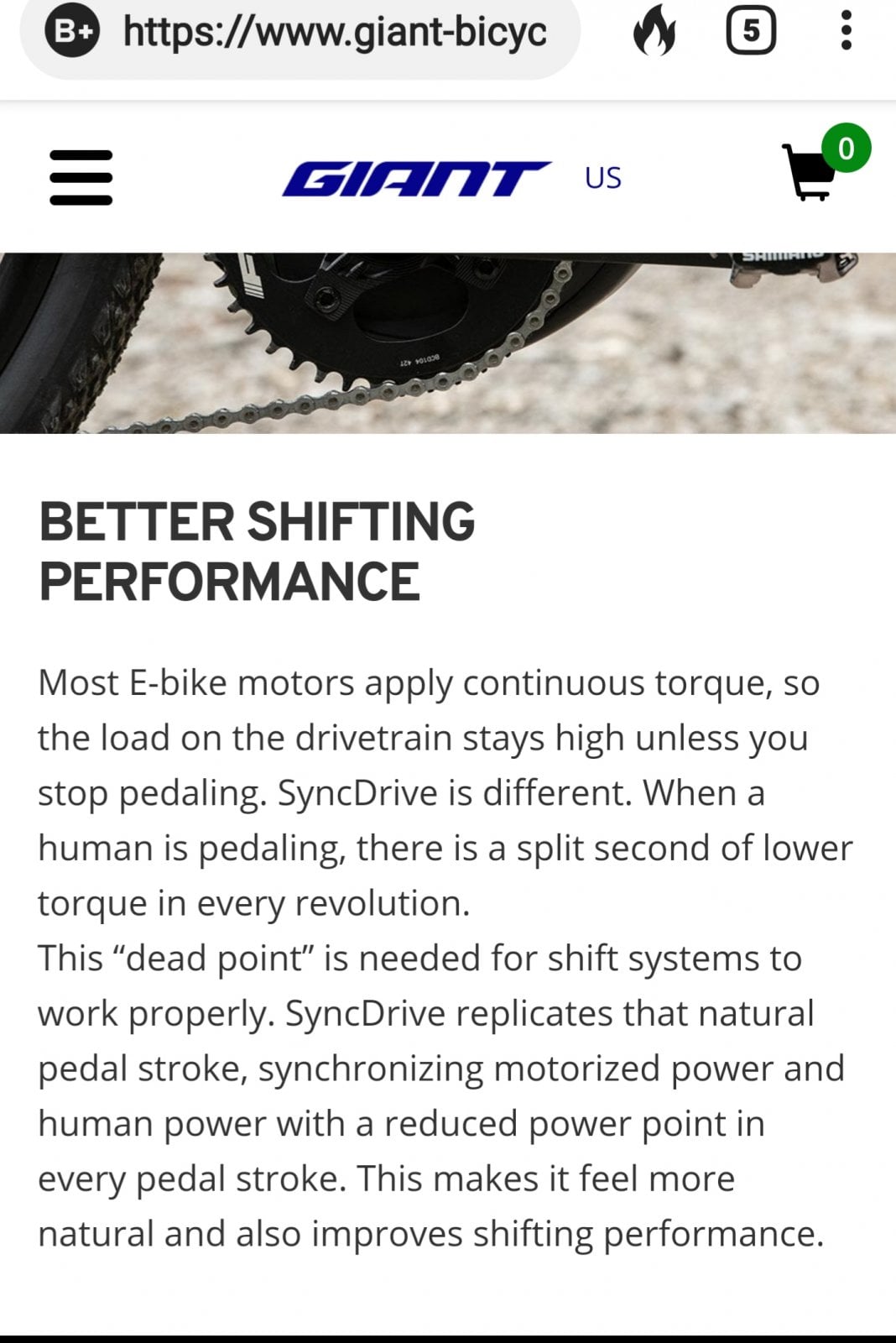

Giant has a somewhat unique approach to output power, not often mentioned, that could also be contributing to the power pulses we feel. Even with a perfectly aligned magnet, there are moments on both my giants (2019&2021), when power drops significantly for a few 100ths of a second, and then resumes normally. Read below and see what you think?

Based on what I experienced, when experimenting with two magnets on consecutive spokes, I know that if the magnetic pulse is broken in two, the motor will suspend support for what seems like an entire rotation of the wheel, then surge and repeat. It was immediately unbearable, and I removed the second magnet after one trip down the drive.
I'm speculating a bad speed sensor assembly, failing intermittently, would break up the pulse. But, unfortunately so would a bad motor controller board interpreting the signal. ?
