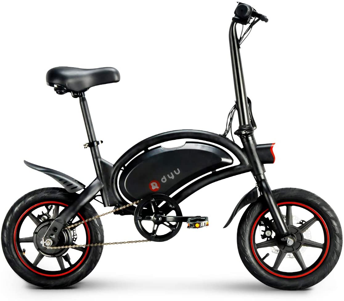

Tricky one….it’s gonna be a case of suck things and see….I should perhaps have worded that better ?
It's an M-Team isn't it ? I'll tell you what. I'll take it off your hands before you have to goto all this trouble. I'll keep it completely standard so as not to abuse your generosity and thoroughly enjoy myself at the same time - meanwhile - to sweeten the deal, I guarantee I'll get at least 10 KOM's in the first week to prove it's completely fine and if not I'll give you the value of the bike back in cash and you can keep the Rampage bike below.
To make things fair, I'll buy you this :
It has much better than 27.5 wheels back AND front ! This thing can Whip ! No worries on BB with no motor there to hit. Very very short chainstay and wheelbase for optimum handling. Centrally mounted energy storage system, again for optimum handling. Comfortable saddle. Very high front bars, so it's virtually impossible to go over the bars. Sporty 63 degree head angle. HUGE Disk brakes which are 50% the size of the wheels ! Steep seat tube for good climbing. Very very very poppy ! Straight through seat tube for limitless dropper post length !
Absolutely no worries or concerns when choosing or changing front or rear suspension, meanwhile everything about it is SHOCK !
Built in anti theft design.
Deal ?
