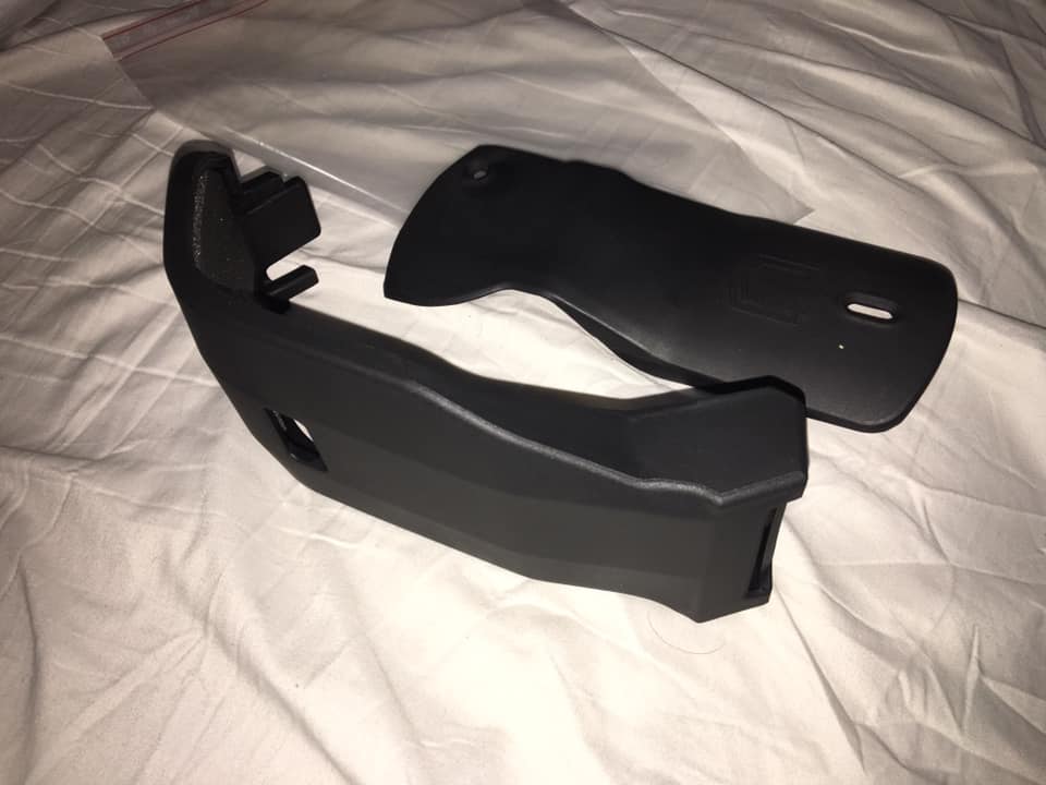

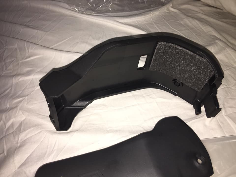

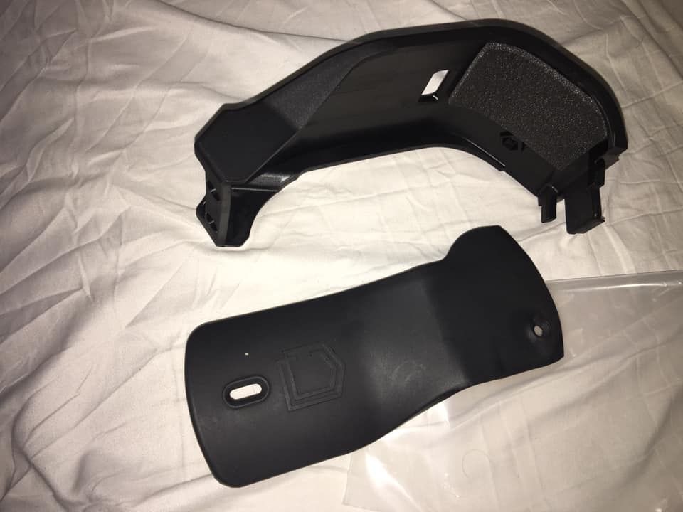

The new beefed up motor protector is available for the Meta Power, but the bad news is that it's two piece design and it will cost 2x40€

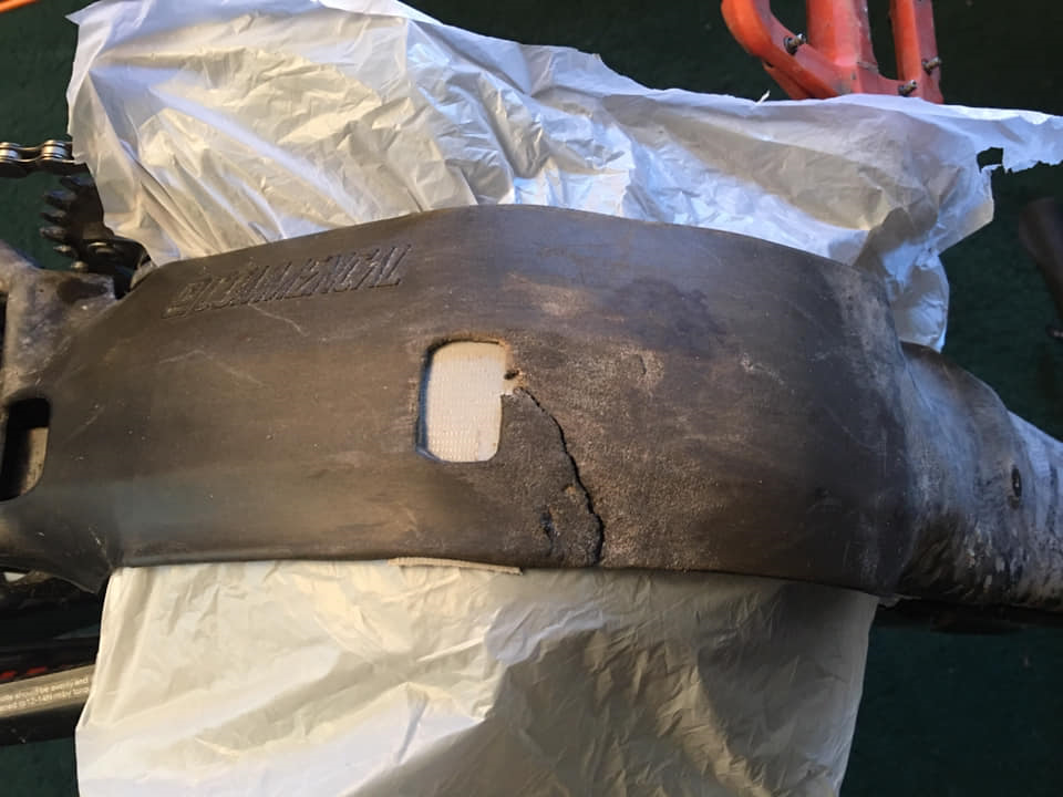

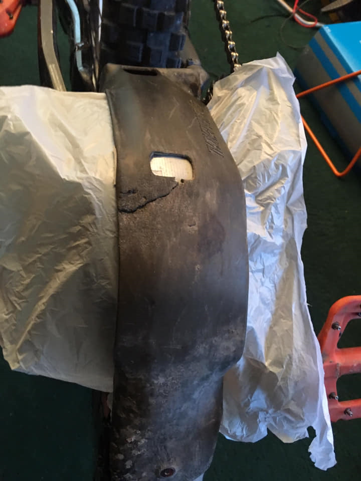

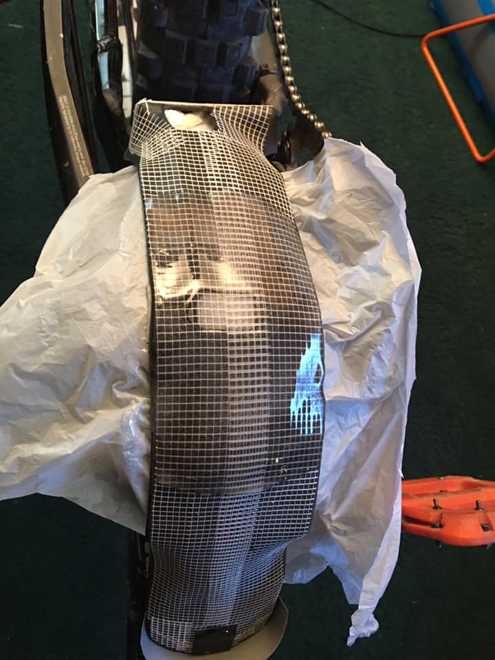

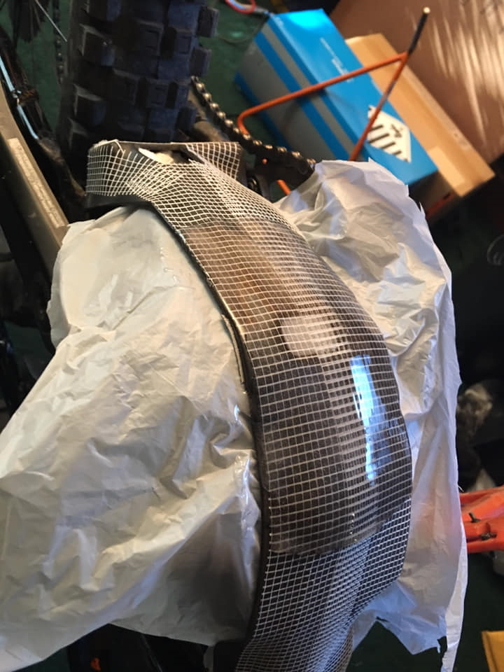

I'm on my second one, which only lasted 3 months before it started tearing. I used self adhesive fiberglass drywall tape and resin on the bottom damaged area, and removed the unused tape, was going to do the whole guard, but was told it might crack, so just make a plate for the bottom. I didn't think it was going to hold. but is working well. Should hold me till I can think of a better solution. Was told by Commencal Europe that those that request one, should be able to get an upgraded one. I am in the US, so don't have the same CS as you'all.

This is a good idea. I have a modification that might be even better. Rather than fiberglass tape, Big box home improvement stores sell structural fiberglass mat for cheap as well as the resin and harden for around $20usd. I'm going to bank off your idea and give it a go. I think I can get the fiberglass flexible by adding less resin, and do both sides. Some Matt black spray paint will make it pretty again

Sounds good! Post up your results. Thanks

Yea, Commencal France came through. I'm in the US, I had messaged Commencal about the bashguard problem back in May. Was told they were working on it and if I gave my name and address. I would be put on the list when version 2 came out. I had given up hope when the Mailman knocked on my door today with a package from Commencal France with the new 2 piece protector. Thanks!!! Commencal. Thick hard plastic, should fair better than version 1.

I can attest to the strength and durability of the new bashguard. Mine has taken some HUGE hits and other than some deep gouges it's still in one piece. If I had the old one I'd definitely buy and install the new one. That motor is WAY too fragile and expensive to risk it.

I have a 2019 Meta Power Race with one of these, to be honest I'm not that impressed, the top section (the smaller of the two pieces) pulls through the retaining bolt at the top and flaps around. I've installed a big washer to stop it reoccurring but it looks sh1te. Needs a better bolt with a bigger head and a rounded profile.

That front fixing bolt is inadequate for a heavier guard , I guess a few tie wraps around the tube would do the job , or a nice mtbstapon strap

Yes, I noticed that when installing, thought I was missing a washer. I'll go ahead and add one before it pulls through. Paint it black so its not too noticeable

Same issue with the upper guard as well. I just added thread locker to the bolt and didn’t reef it down. Been fine since. Upper bolt just keeps it vertical.

The bottom actually snaps in place, so there is no weight on the flap piece on top. I'm just gonna file the sides of a small washer flat to fit in the slot where the bolt is. Should look stealthy

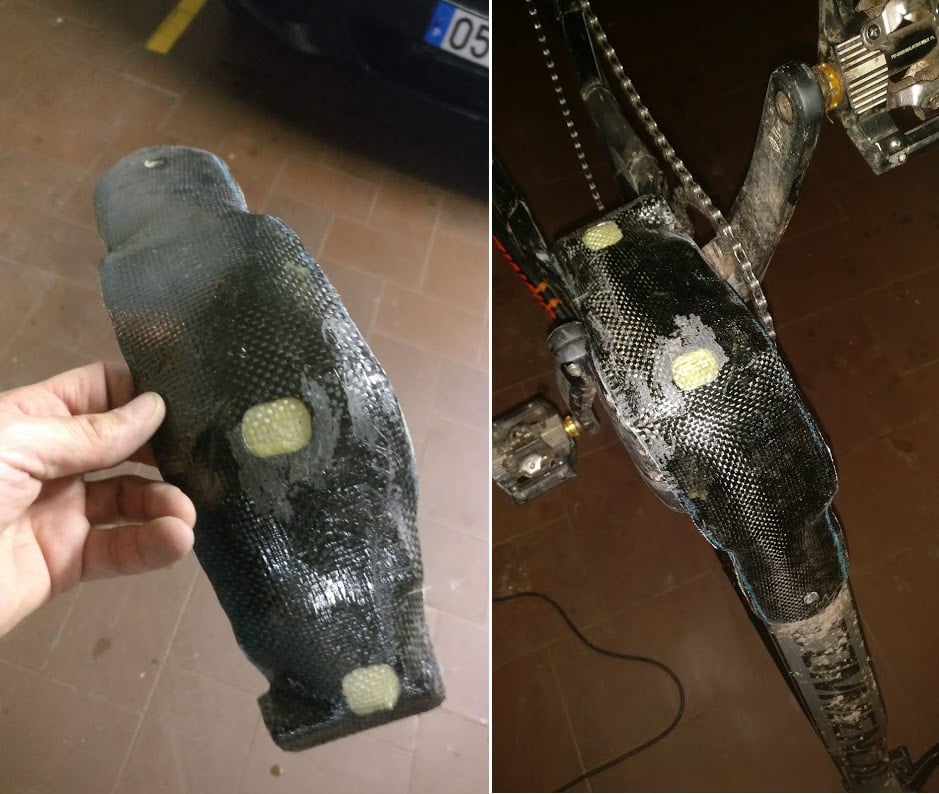

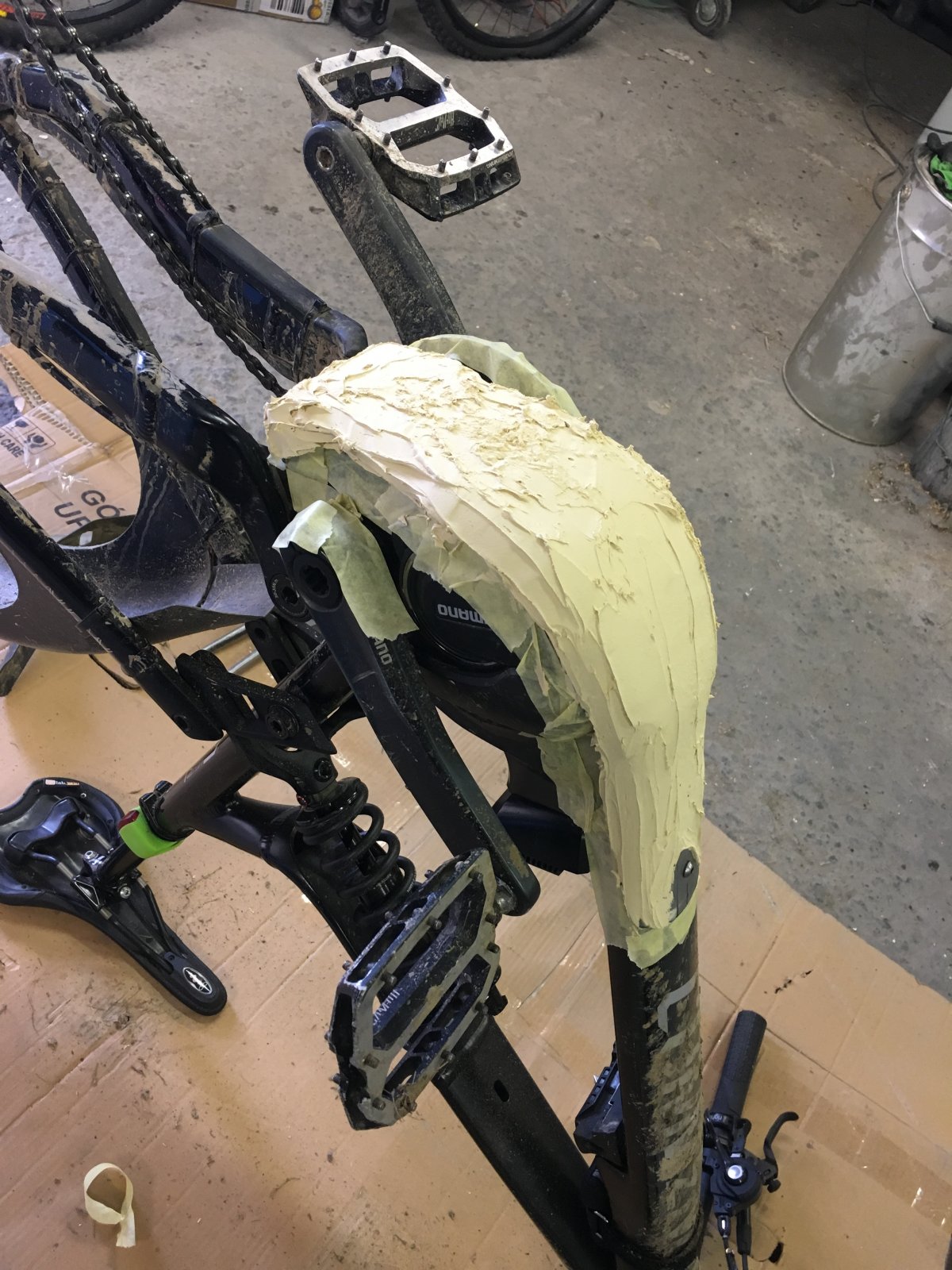

Yes. I didn't have enough carbon fiber to make it 100% carbon. I did 2 layers of carbon fibre on the outside and 2 layers of glass fibre on the inside. After 24h curing at room temperature I "cooked" for 2h at 150°C in my kitchen oven. It's rock solid now ?
