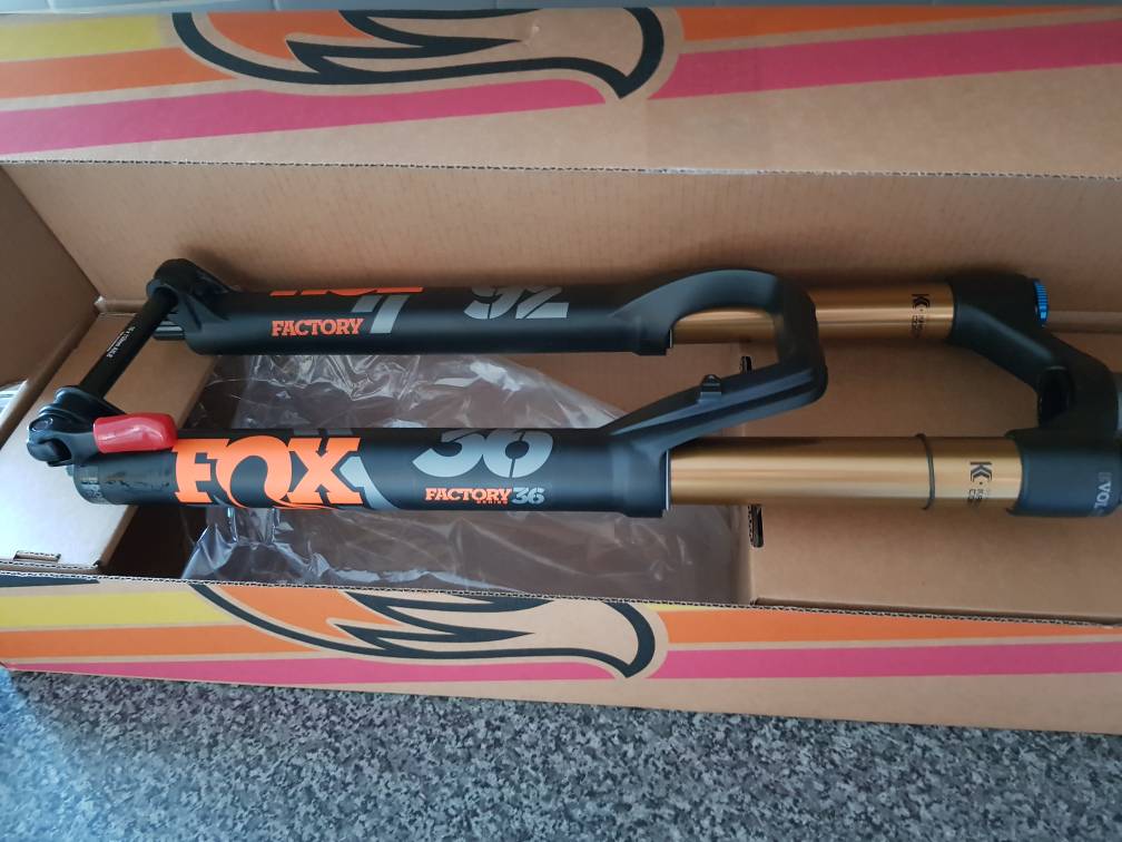

On top of what RC said you'll need tapered ones, 51mm offset.
I just got these the other day..
