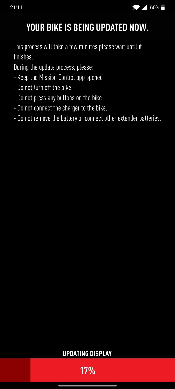

My Android phone says I have MC v2.3.0 from 19th May but today I supprisingly found out this version allows to check current and latest versions of motor, battery and display (TCU) firmware and lets you perform OTA update of the TCU. It took more than 5min to update, but I already see at least one difference, now all bars goes down to zero bars when shutting off the bike, making way more clear that bike is shutting down. Anyone noticed any other useful/nice features?

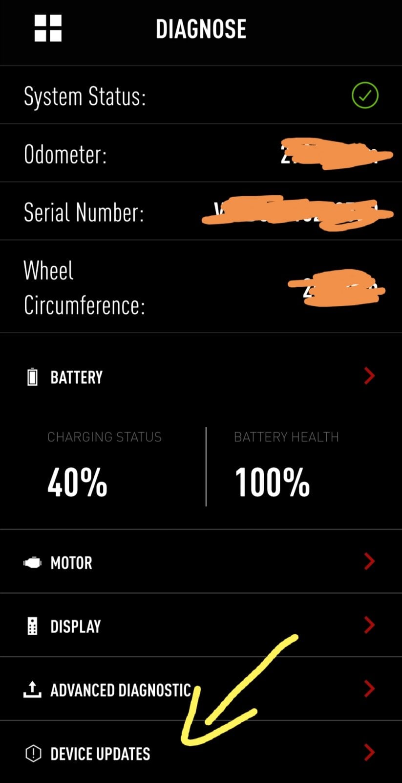

Not regional and no new app download should be required. This was quietly enabled on our back-end for specific bikes/FW bundles only - see the top of this thread for more info and why there's no in-app message to draw attention to it.
@ebikeZA which bike do you have and which motor FW are you running currently? If you see a blank screen when clicking on DIAGNOSE / DEVICE UPDATES it's likely that there isn't a remote update available for your bike due to you running early motor firmware (perhaps the first 2019 Levos shipped to retailers in late 2018). Therefore only available via retailer - sorry about that.
User experience if an update IS available for your bike is working as planned, however for scenarios where this isn't available for specific bikes the user experience isn't clear enough yet. Working on that, hence the soft-launch.

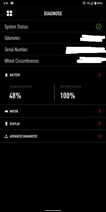

Where are you guys seeing the option to update?
I have a 2020 levo expert and app version 2.3.0 on an android phone.
I've looked in mission control, but haven't noticed anything new.
Current firmware versions:
Battery: 2.4.4
Motor: 6.1.0
Display: 25.B.0

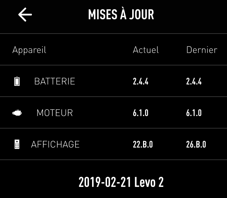

I’ve tried to update my display firmware from 22b to 26b as suggested by Mission, the whole process runs well. At the end, when the bike is reconnected, it’s still on 22b version. It’s the IOS application.
tks in advance for your support

I have iOS mission Control 2.3.0.
Motor firmware 6.1.0
Levo 2019 purchased in January 2020.
But I do not see the additional firmware update menu item in the diagnose section.
Do I need to delete and reinstall mission Control to see if that resolves the issue?
