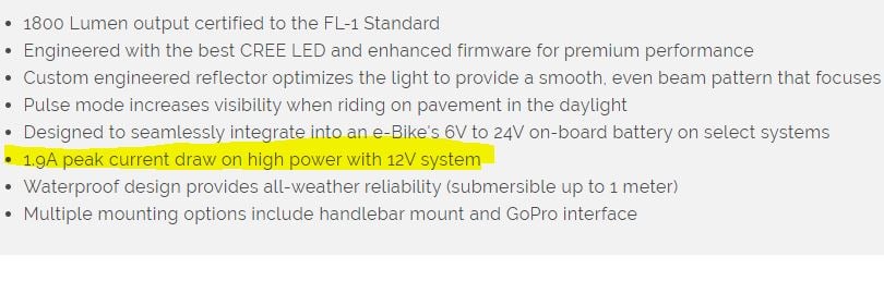

Just installed this compact front light on my Nutrail, cost was only £59.99 from Merlin Cycles who also activated the light option for me, the required loom was about £11 from eBay plus a couple of heat shrink connectors.
Really happy with the set-up. View attachment 10822
Does the motor needs an update if I install one? Or is it just something that need to get activated?

Do I need to buy an additional bosch light cable? In the description there is no saying If you need a cable or not
Oded
Jul 27, 2020
35
135
Israel
Depends on the bike. Some (KTM) come with a pre-routed cable. Some need the Bosch plug that fits the motor light port. The light itself comes with a double core cable without any plug at the end.
