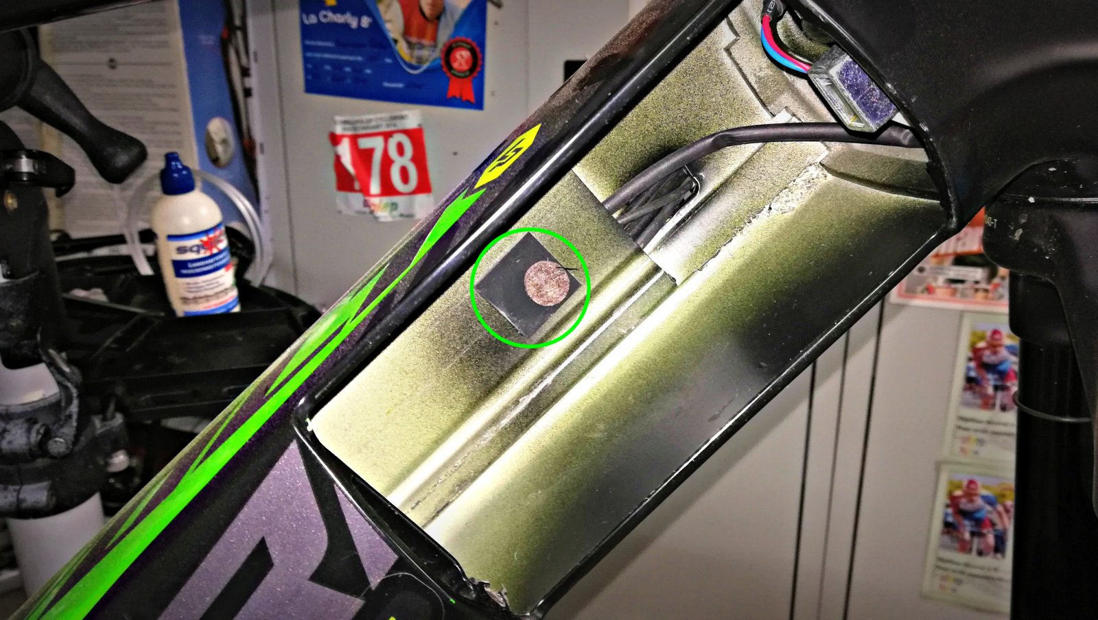

Yes Sir. It was a phenomena that I fixed/hacked simply by gluing a small furniture felt pad on the battery (to the topmost side of the "highest" battery section, close to the frame opening) and also wrapped few slices of old inner tube inside the cover of the battery opening (at the "root" of the tab that the lock attaches to). 2 minute job, hard to explain, but I can post a photo later if needed.
The rattle was really scary , but since the "bodge" I have enjoyed 2000 totally rattle free kilometers (got this on September, huge aid for my femur recovery process).
Edit: the rattle was much less pronounced on my first Overvolt, which was totaled during the accident last March, but nevertheless the rattle was there too. Manufacturing tolerances... and should have been solved by the manufacturer in the first place IMHO. Never bothered to complain though, as the fix was so easy and cost less than two cents. Otherwise the bike has been really faultless, deeply in love, passionately :)

Here you can see the furniture felt pads on both of my two batteries and the battery cover with few strips of old latex inner tube at the root of the locking tab:
The felt glued on top of the factory rubber opposite the battery opening is another, even simpler option. Tested that today, no rattle:

Thanks for the pictures.
We did some similar modifications today and got rid of the rattle.

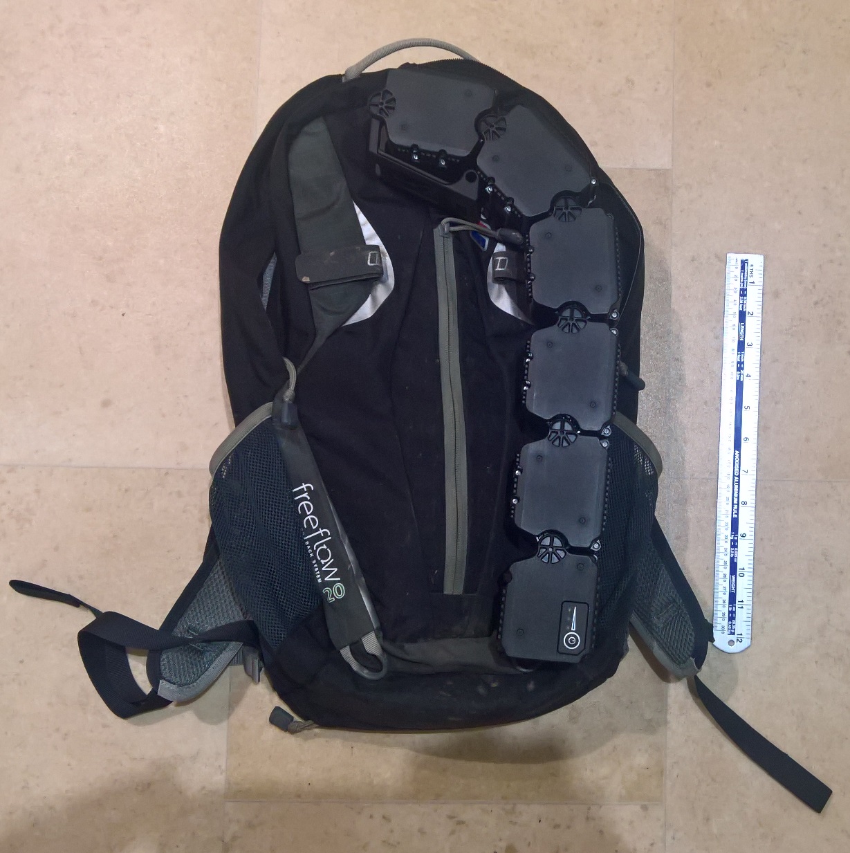

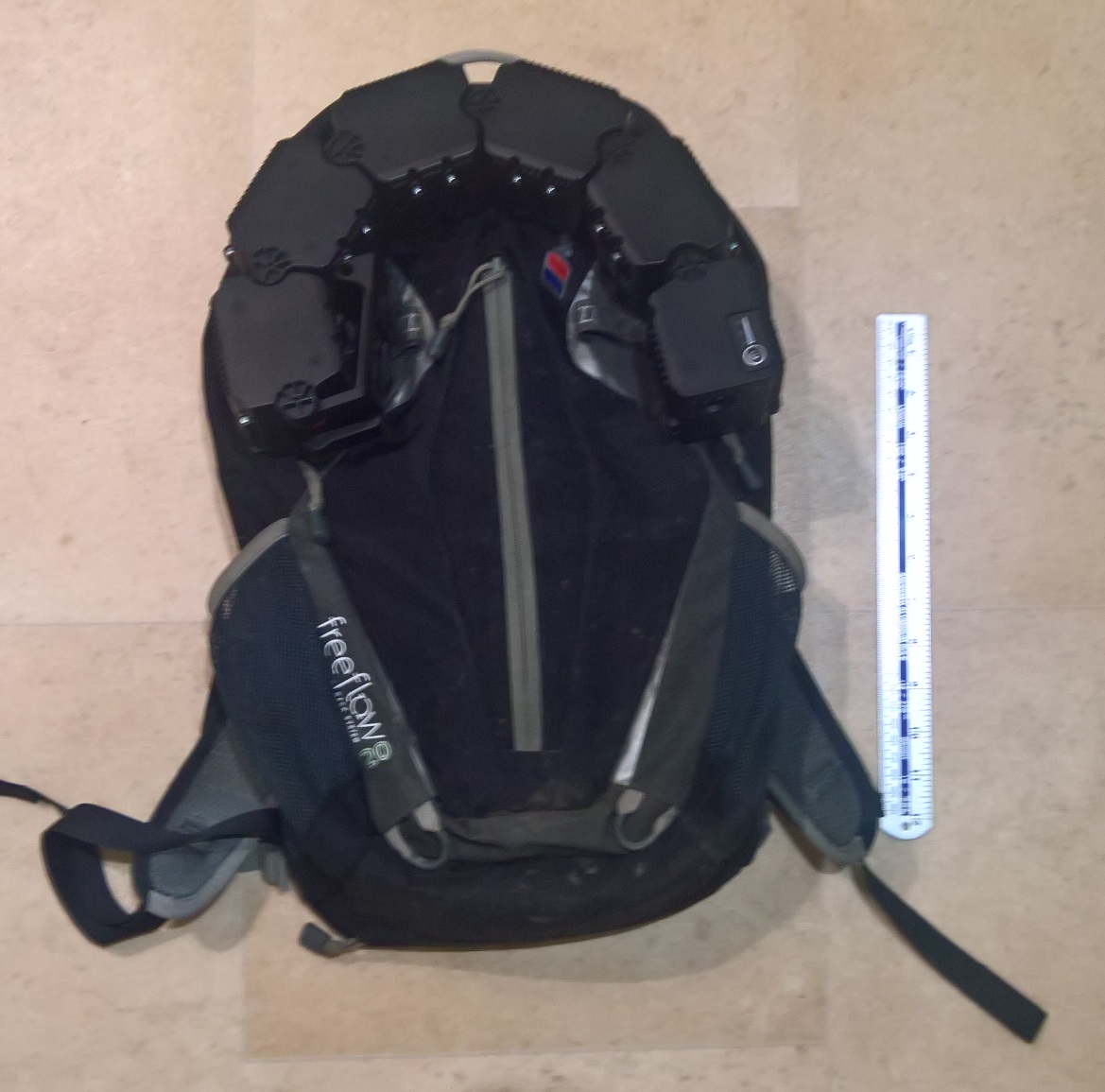

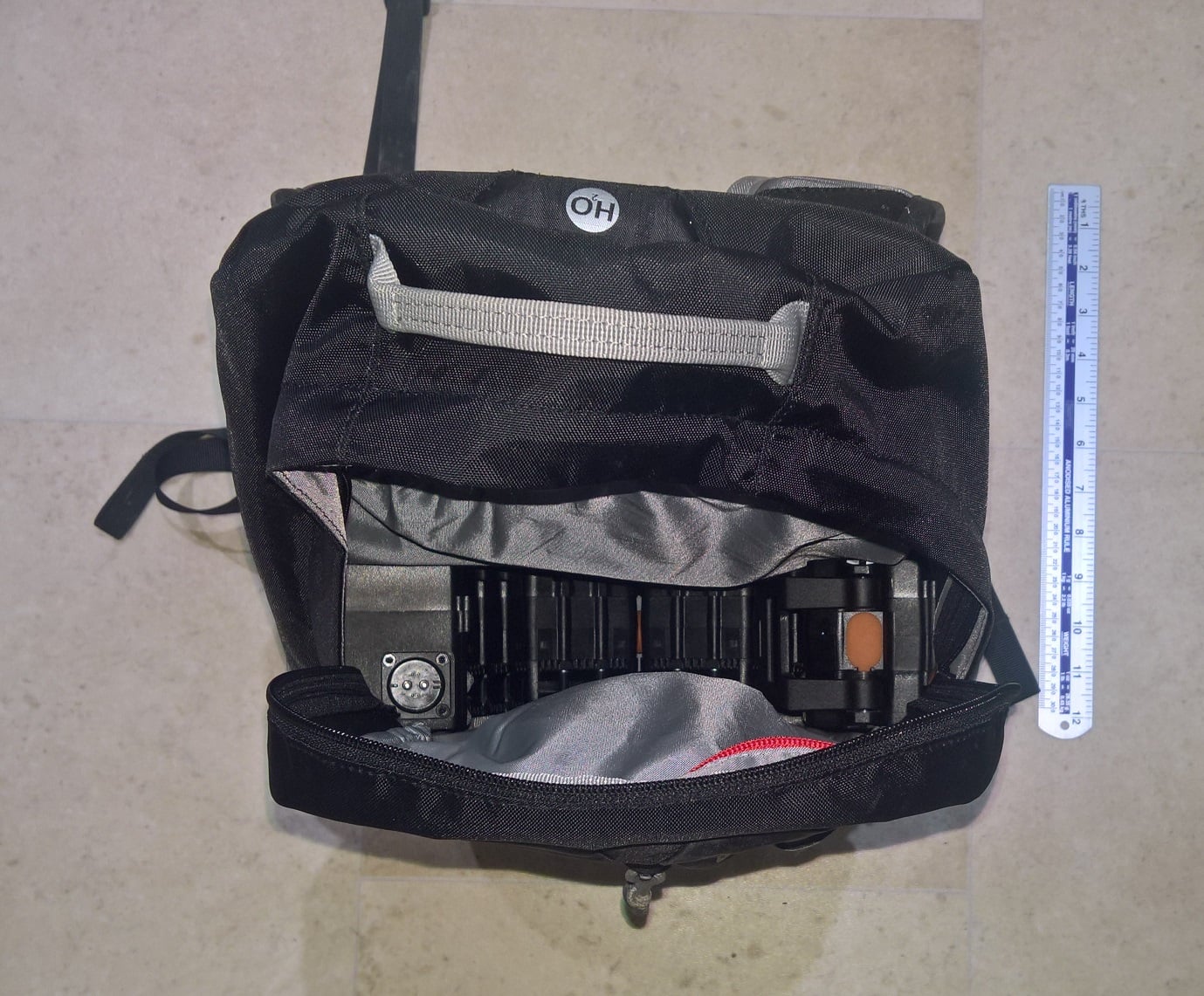

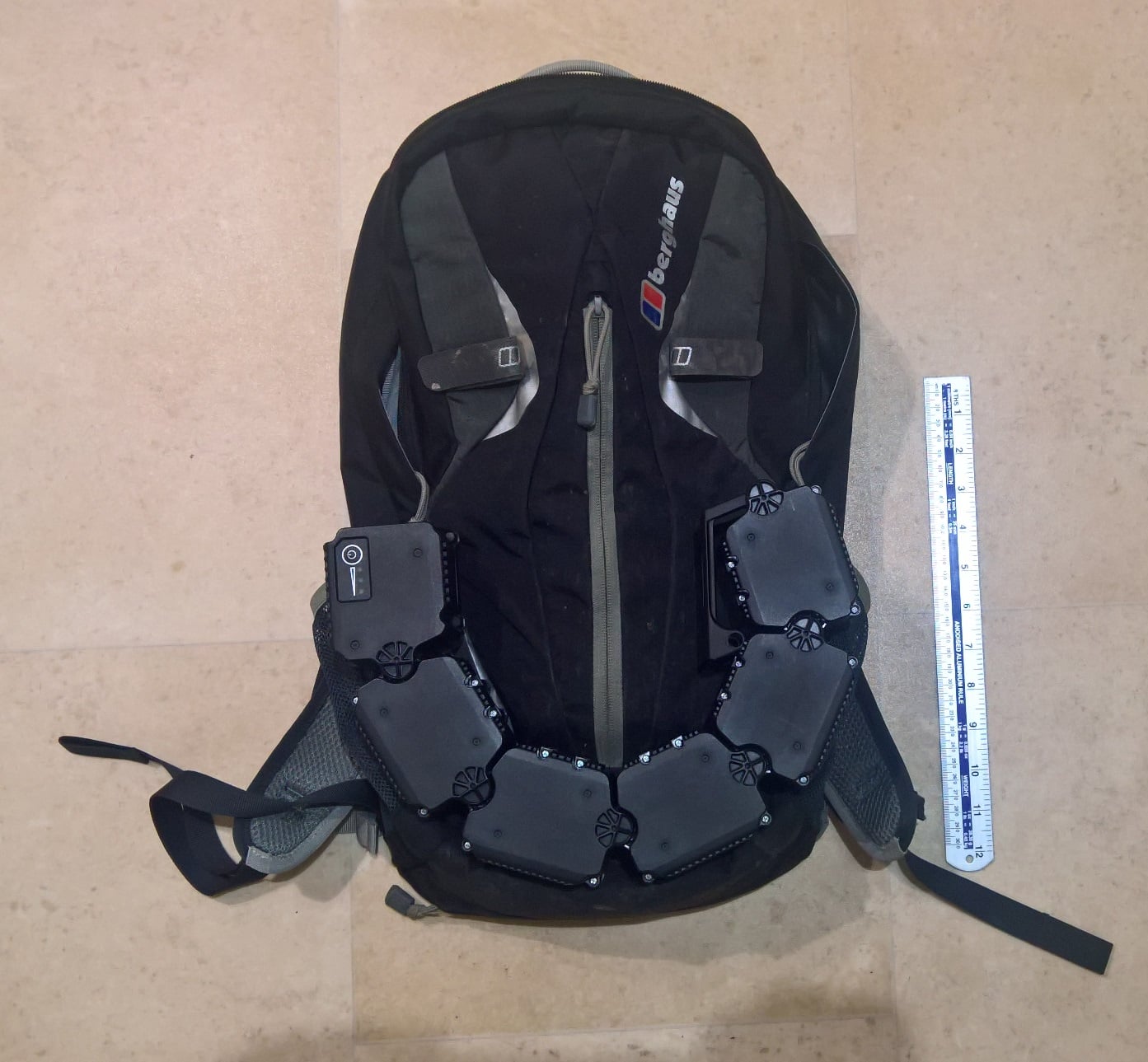

Fits easily for me - I can post some pics later but just going out for the day ...
I either curl the spare battery up at the bottom of the backpack like a "U", or put it vertically down one side and curled over at the top. Or you could put it curled over at the top like a "n".
On my XL frame I've found it can actually fit curled up inside the bike frame triangle too, so I might get a frame bag to carry it, so there is less weight in the backpack.

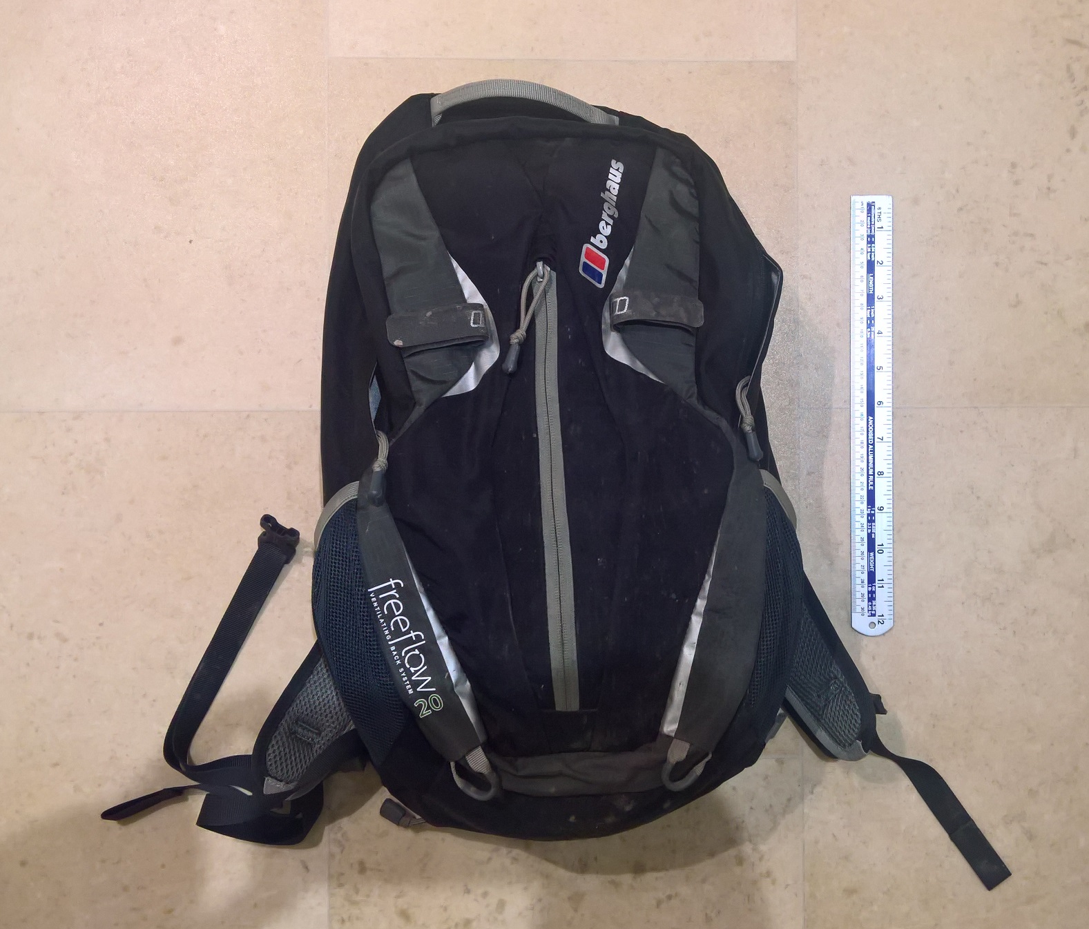

Here are some pics of the battery and rucksack I use (it's a 20L one and I've put a ruler next to it so you can see the size).
Battery is inside at the bottom:
Like this:
Laying on top in the different positions I described:
