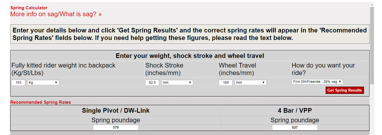

https://www.tftuned.com/spring-calculator
Is 103KG your riding weight, with pack etc? If so, you need a spring of 600lbs to 650lbs depending on how much sag you want.
