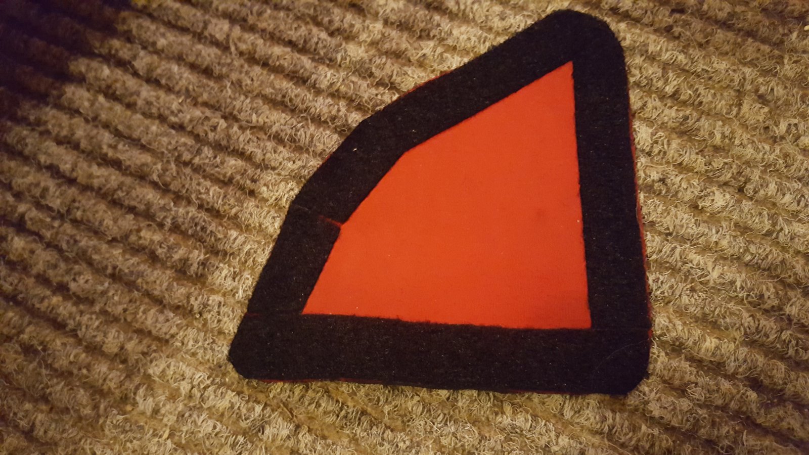

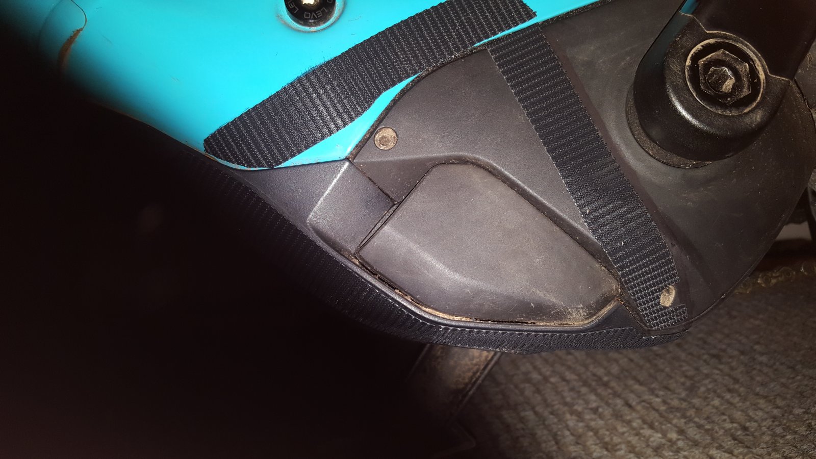

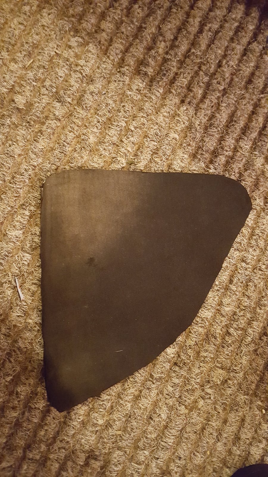

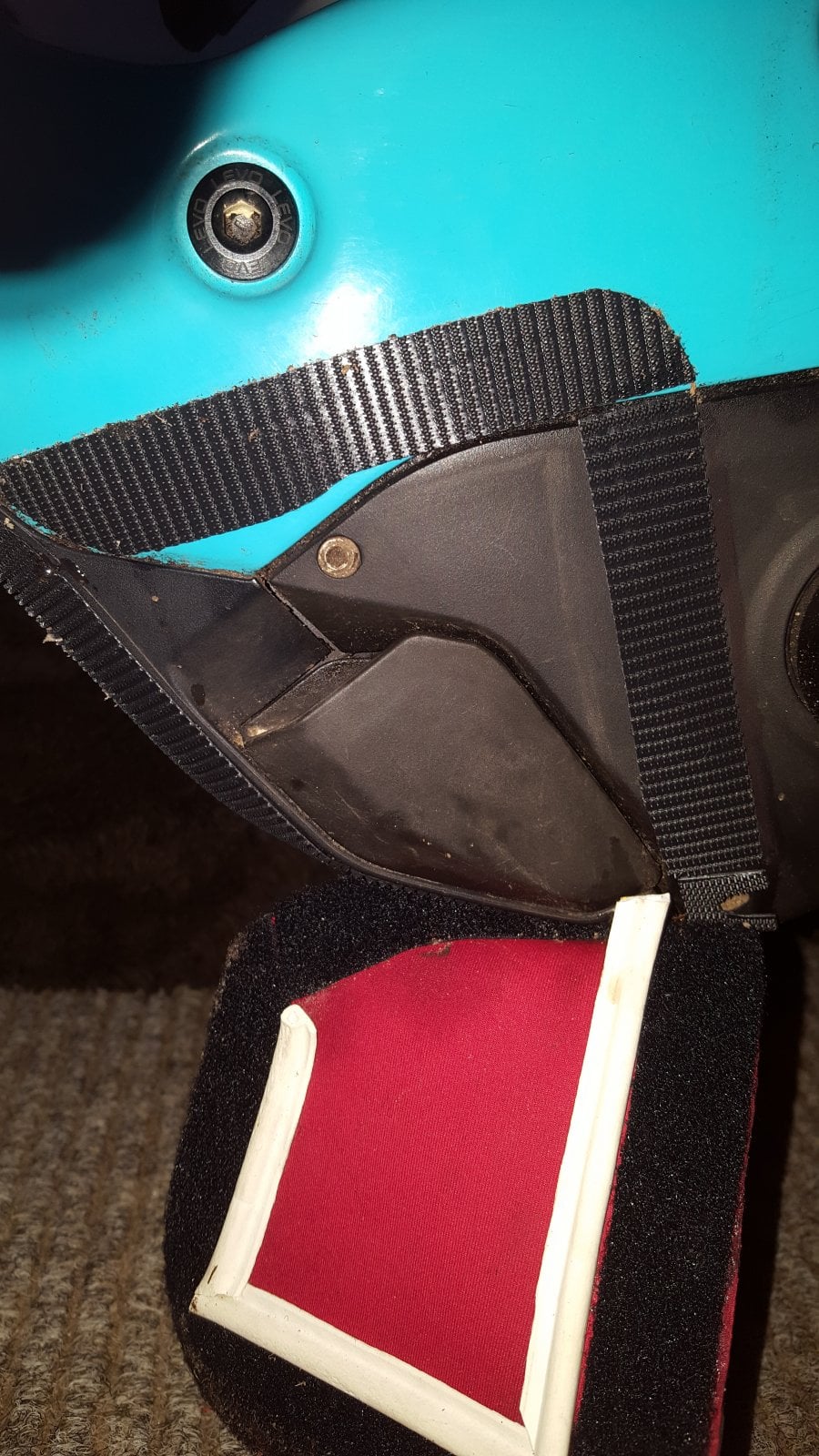

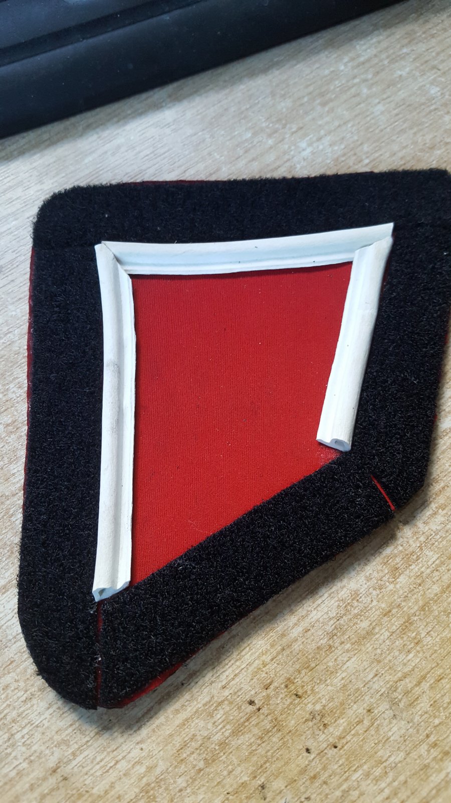

Untested as yet but if it stays on it will help keep the connection clean. Materials were neoprene and heavy duty adhesive velcro. The velcro does not stick very well to neoprene so I used fabric glue. I made 2 velcro covers so a clean one can be fitted whilst the dirty one is washed.

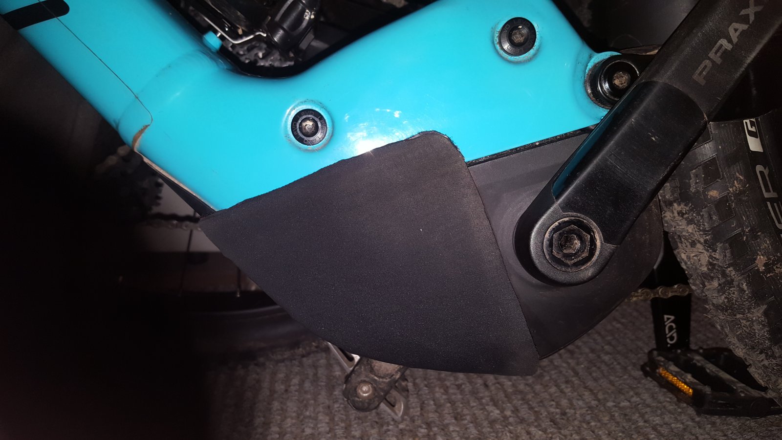

Don't think so. I sometimes use neoprene overshoes in very wet conditions....my shoes stay clean and dry. In fact I am not that worried about water. The plug is well protected from water ingress because I keep the O ring seal well lubed and use grease on the mating surface. I am more interested in keeping mud and dust away from it so I do not have to be constantly cleaning it.

What fabric glue are you using Mike? is it flexible?
I've been working on a neoprene bike cover during the storms and discovered like yourself, it does not stick well at all, snd can't be machine stitches either :(

Looks like it needs to be a strong bond. For your project I would use Aquasure to bond Neoprene together.

Yep...as I said...use Aquasure. The neoprene will rip before the bond.

Just as an update, I have used this design of neoprene cover for a year now. No water, mud or dust has penetrated the cover. I made 2 of the covers so I can wash and dry one when it gets plastered in mud.
As an extra bonus it also protects the edge of the battery guard which can be damaged by sticks etc in muddy terrain. That happened to my mate on a ride together. The stick got into the gap between the roseberger plug and the battery guard and the rotating crank then hit it and it snapped a corner off the battery guard.

Its not just a bout water ingress. My mate has twice had the plug pulled out by sticks on the trail, on one occasion breaking as well his battery bash guard. The cover also keeps the plug area clean.

Not sure what you are asking. There are only 3 materials. The neoprene, the velcro and the white stuff is draught excluder used for doors and windows....which you can get from B and Q etc.

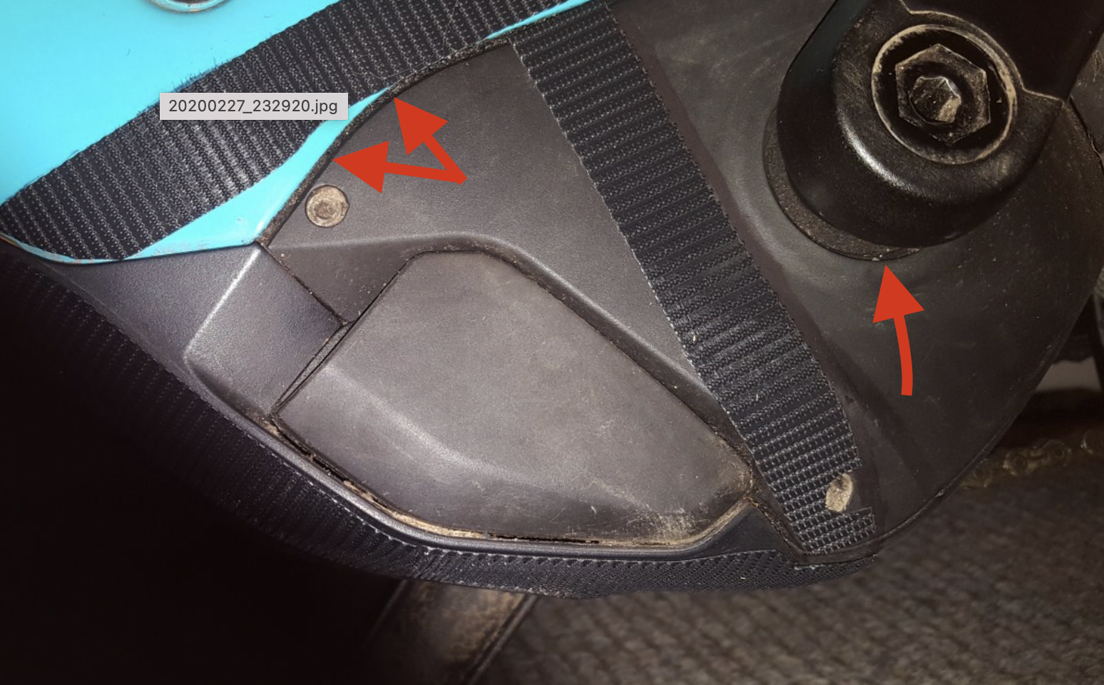

No, the cover construction is well explained.
I was talking about some sort of seals (marked them with arrows).

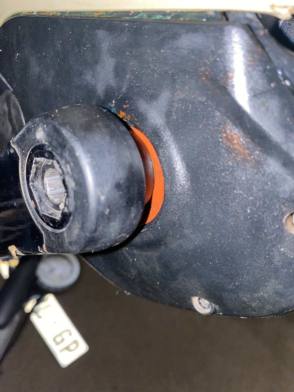

For the Crank spindle I have put a Enduro seal that I had left over from my analog days ... it was the seal that came with en enduro BB bearings ....fits perfect and is flush agains the motor and forms a nice seal on the spindle ... will post a pic later when I get back home

Which one of these?
1Nixxxo
Nov 29, 2019
66
33
Russia
Yes those ... works perfectly on the left side... don’t have a tool to remove the crank spider so have not been able to check that side.
Thanks! Now I'll try to find dead BB to strip it )))
On the drive side there a shim, which is greased and permanently pressed when new motor is assembled in frame, so there's no way to extract it or replace it.
