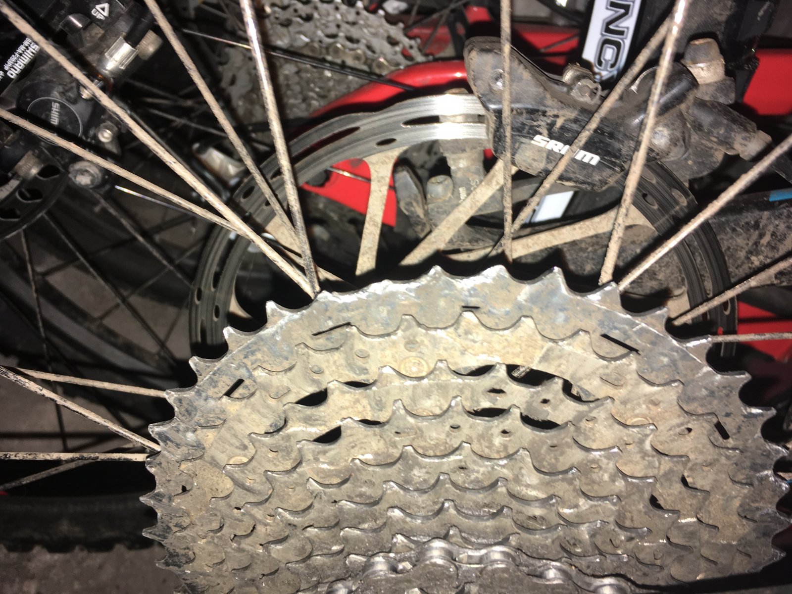

got around 1500miles out of mine and it was still working but was missing a number of teeth, and I was due for a big weekend away so changed it
https://www.flickr.com/gp/15253377@N00/P4452o IMG_6566.JPG
