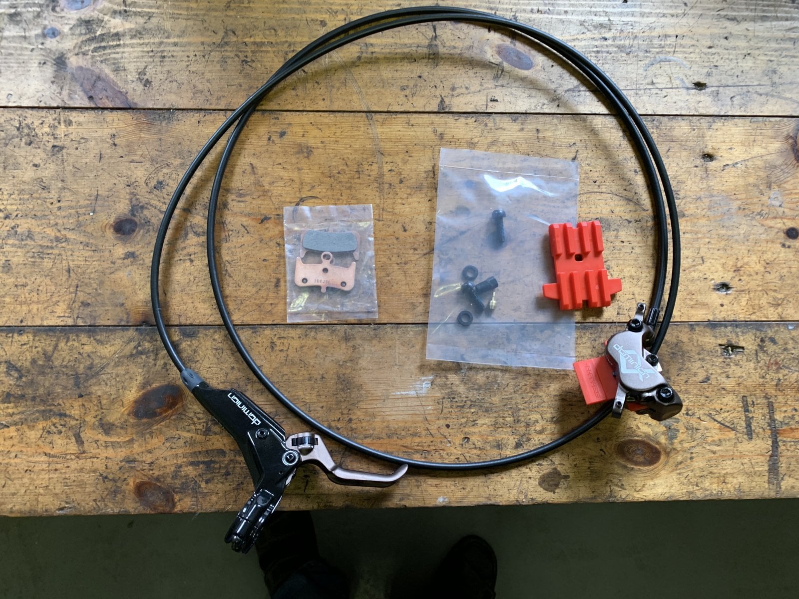

As seen in the top picture they come assembled together with a few bits and pieces and most importantly, a kit to shorten the brake lines. That you will all need unless you ride a tandem or have a XXXL frame, anyway most rear brakes are internally routed so you will have to cut it anyway to feed the brake line inside the frame. Installation itself is like any other brakes and not that complicated at all. Here is a few random pictures from my 2018 Turbo Levo FSR

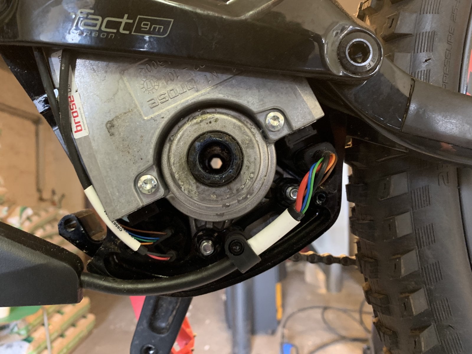

Routing the brake line for the rear brake is quite easy but you will have to cut both old and new brake line to get it through the holes in the frame - Taking the non-drive side motor cover off is a must in order to route the line over the motor:

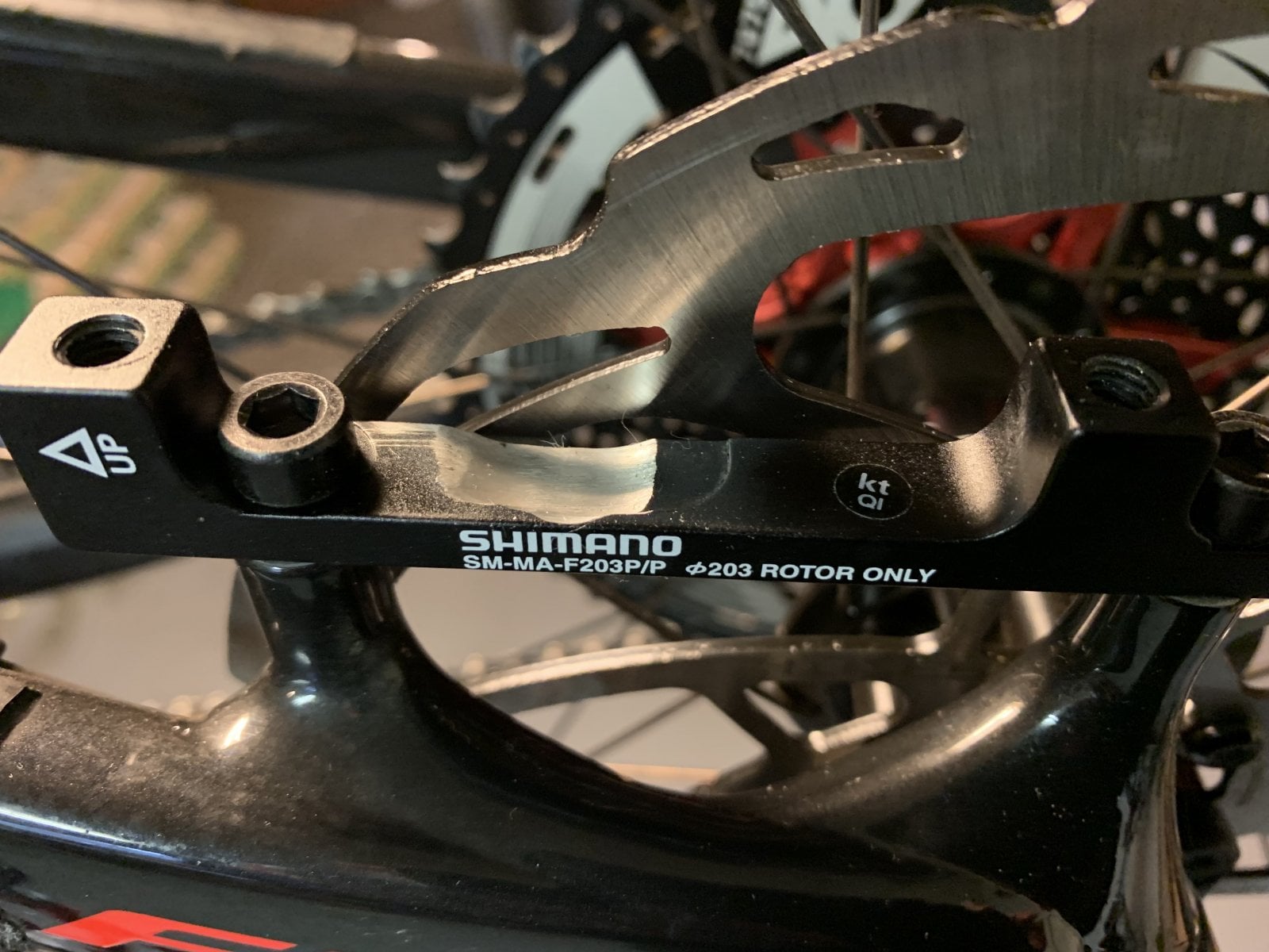

Another challenge was the rear adapter for the calliper, based on another thread here I found a Shimano part number for the Levo but it did not fit perfectly as calliper was sitting 1.5 mm too low. Also, The Dominion calliper is very big so I had to modify the adapter with a Dremel in order to avoid contact. this will do for now but I will try to find a Hayes specific adapter:

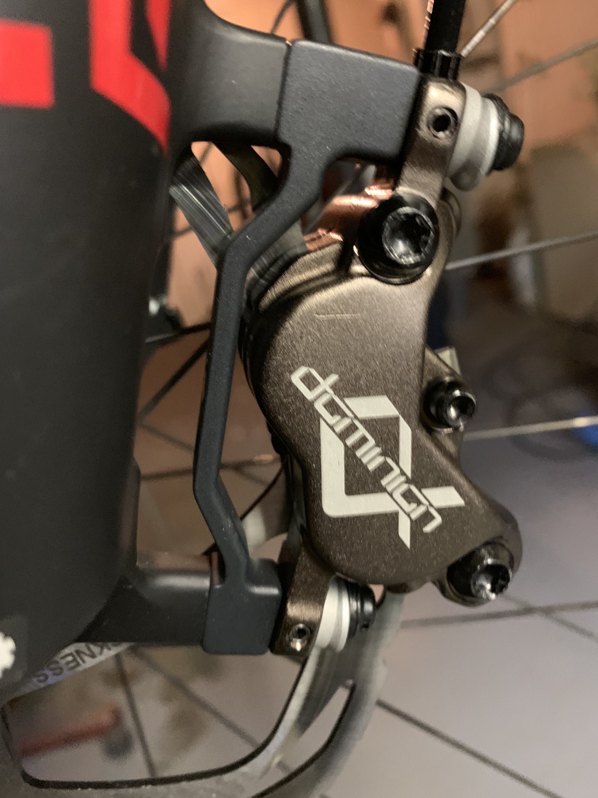

This is the front adapter I used and it fits perfectly on a 2018 Pike fork:

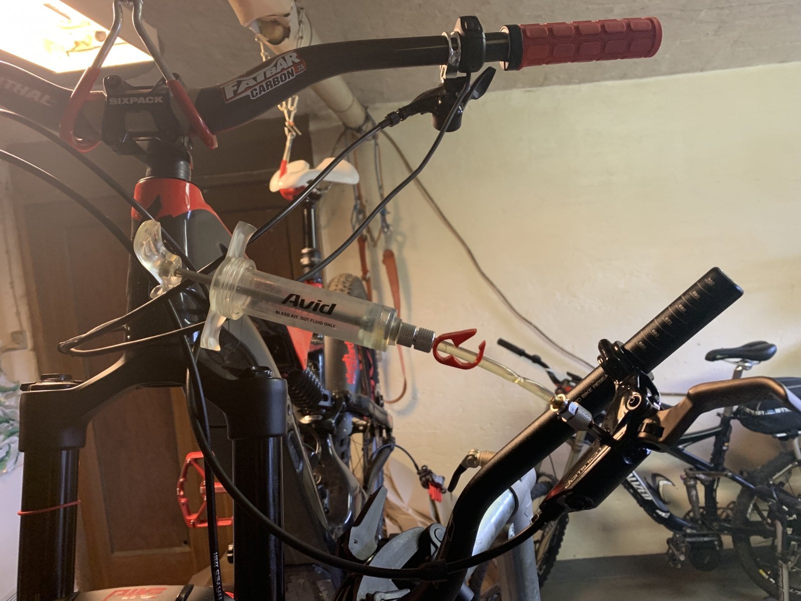

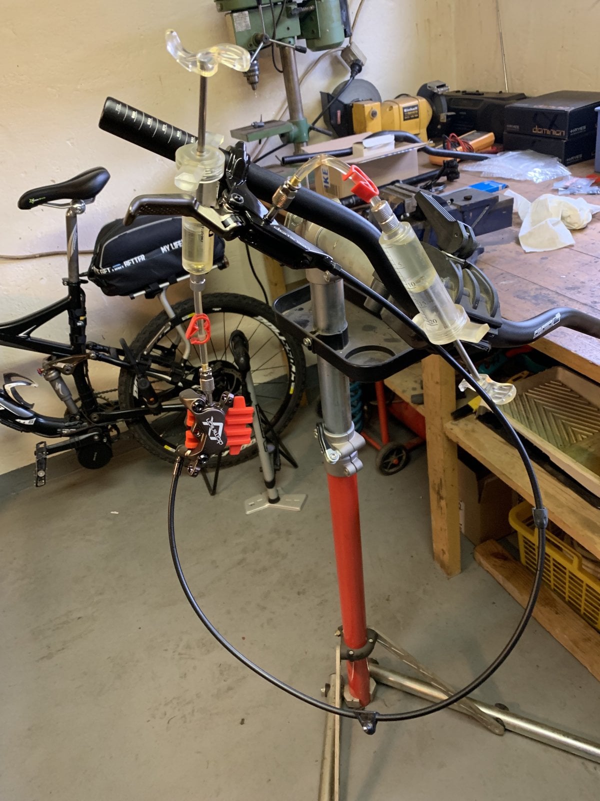

Bleeding:

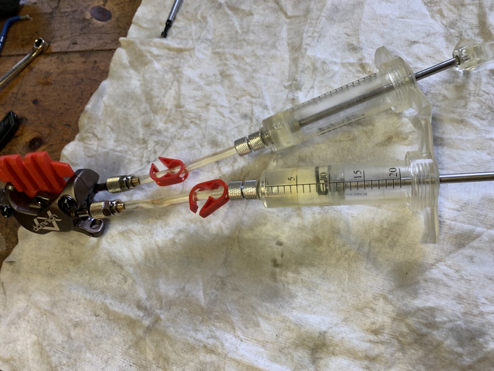

Now to the bleeding part and that is a bit different to most of the other brakes that I have had, Hayes have a good video here and I strongly recommend to follow it closely or you will not get all air out - Compared to Shimano and SRAM it is a bit more complicated. Regarding bleeding tools you can either use the Hayes bleeding kit that cost €45 or buy a cheep Avid bleeding kit from Ebay. The fitting you will need is a metric 5 mm and that is the same as the older SRAM/Avid.
Here is the Hayes Bleeding guide: Hayes Bleeding guide
The front brake is not that difficult as you can do it away from the bike but the rear brake is different if you have internal routing - Here is a few random pictures from my bleeding process and it is not very smart to design a bleed port on the master that demands a dual 45 degrees angle and I found out the hard way during the initial bleed, that it is indeed necessary:

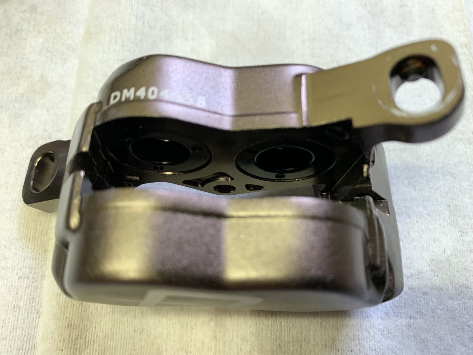

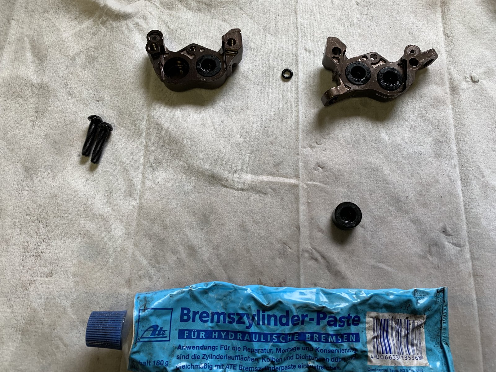

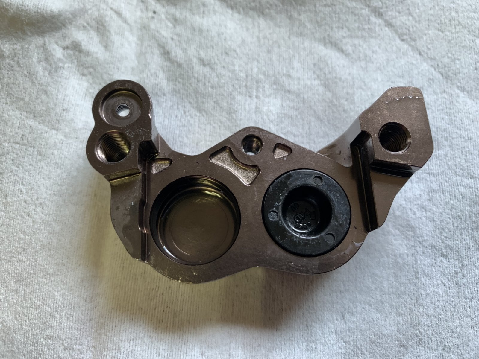

Just home from work last night I today decided to give it a last try as I got an Idea that the callipers could have been assembled dry and lying for a long time before they were made into a kit with brake lines etc.
Sure enough, the pistons were sticking so much in the calliper housing that I had to apply 8 bars with my compressor in order to get them out, after some cleaning and some special brake piston pasta I now have a new brake set that works perfectly:

Finally got around to fitting one of these as my rear brake - much easier doing it for the second one!
For reference I used a Hope brake mount and it handles the extra size of the caliper perfectly. It was type C from this PDF: https://www.hopetech.com/_repository/1/documents/Brakemounts2019.pdf
Thanks for the brake mount heads up, after my initial hassle my Dominions are working as intended. Only thing I’m yet to get fully used to is the lack of dead stroke, I’m used to ride with a finger always on the lever but one cannot do that here. The smallest bump and you will brake unintentionally. I tried to adjust the dead stroke but can’t feel any difference what so ever.

On my 2018 Levo it was an easy task to route the rear brake line with the battery and left side cover off, I simply cut the old line and pushed the new line forward. I’m using the sintered pads and the brake force is significantly stronger compared to my old REs and with the same good modulation.
