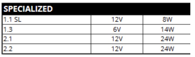

Hi. Anybody hard wired front lights to 1.1 motor on the SL? I have turbo Levo comp and successfully installed Lupine brose lights. easy with unused ports on the brose motor. But can’t seem to find any tech info on the Specialized 1.1 motor in the SL. I think it’s manufactured by Mahle

I picked this up here (sorry I don't remember the original sender, but props for him/her).

Thanks. Thats great news. Meaning the 1.1 SL has 12v output. So I can probably use my Lupine SF light. But I need to find the correct cable. Guess I have to open up the motor cover to see if there are any unused ports or other connections available. Don’t want to do anything that voids warranty :)

Just read tech info on Lupine sf light and it accepts both 6v and 12v. Only concern now is if 8w draw is enough? Will give it a try and see if I can connect it somehow with the included Brose connector or if I need a different connector or cable

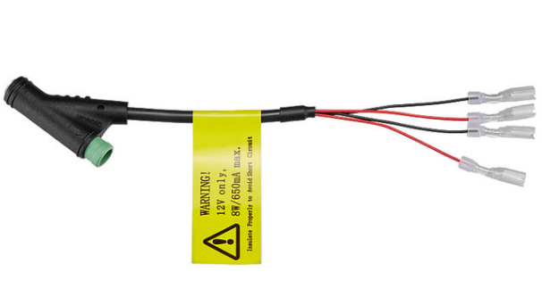

Great. I never saw which model exactly is this.
There is also no possibility to buy a cable for SL bikes on their page.

I have a stupid question. Why is this cable limited to 8w. Does the BMS limit the output? What will happen if I connect a 14w headlight via this connector?
