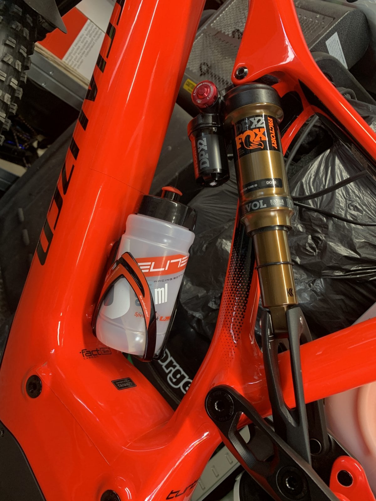

Rich-Baillon
Jul 19, 2019
70
77
Simple question but with the DPX2 fitted can you still run a bottle in the cage. I run the F36 and DPX2 on my Yeti and would love to upgrade to the same on my FSR Expert.
Rich-Baillon
Jul 19, 2019
70
77
Im struggling to find a bottle small enough to fit with the dpx2 on my levo.
I was in Liesure Lakes on Sunday and they had some quite small bottles in there, probably half the normal full size. I don’t mind a pack for longer rides but much prefer a bottle option for shorter local rides.

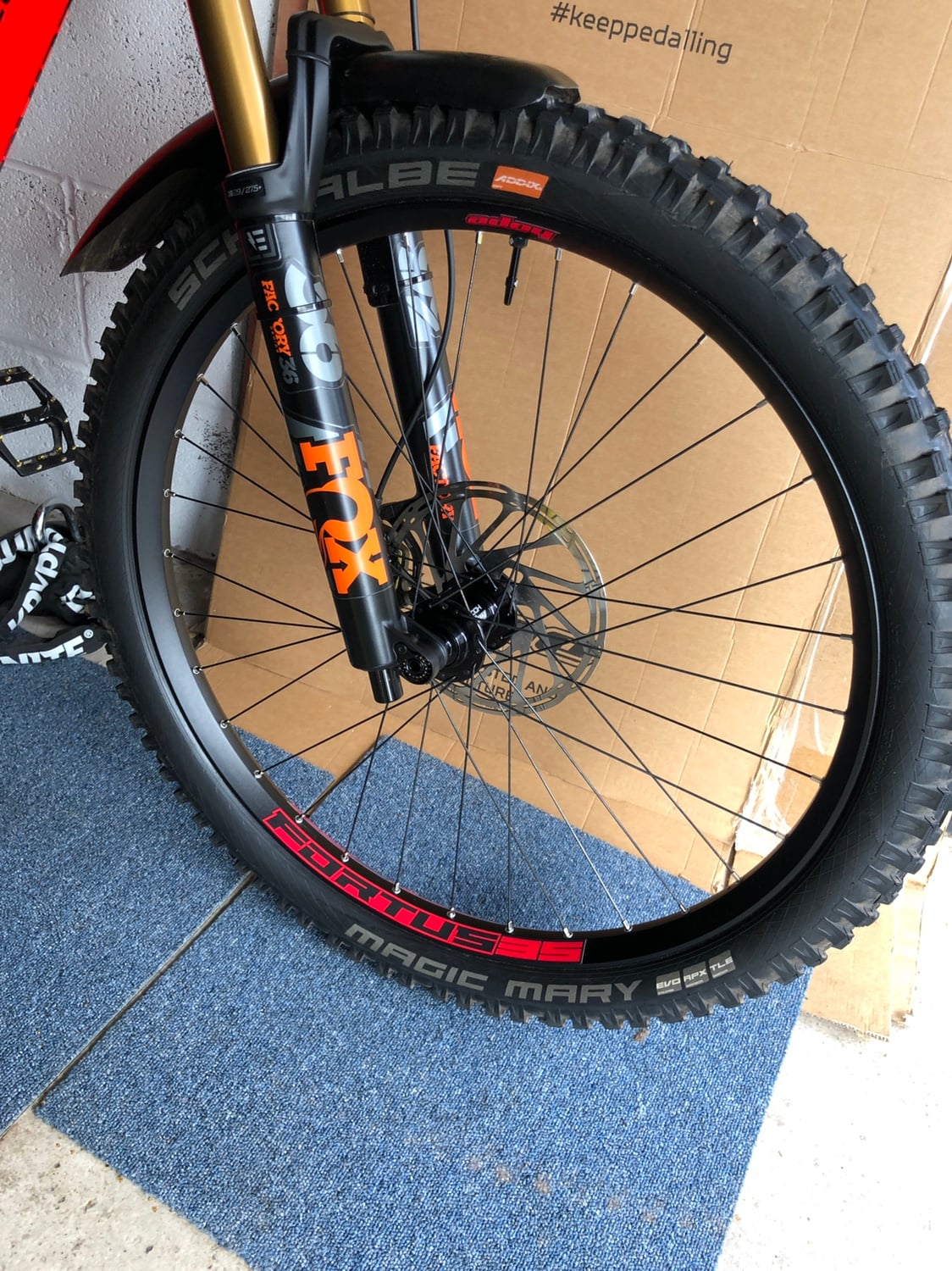

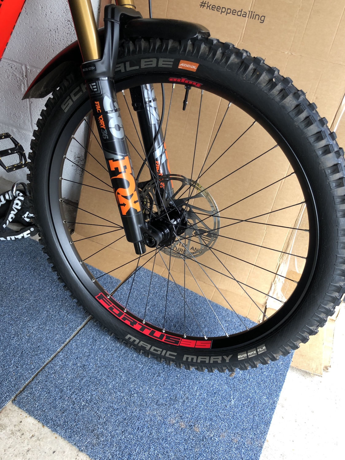

Mattwilko92
Aug 22, 2018
229
188
Staffordshire, UK
LBS saying still waiting on spokes which are having to come from Holland :unsure: Im guessing another week or so wait but its driving me mad not been able to use it.
Im considering ordering the new Hope Fortus 35s but need some help. Choices of steel or aluminium freehub, or XD freehub. Which one do I need anyone know ?
Im running the Steel hub option
