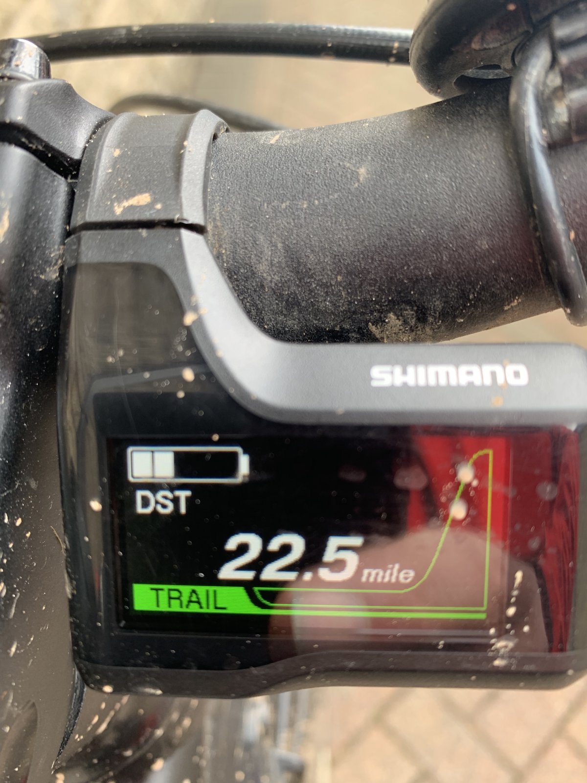

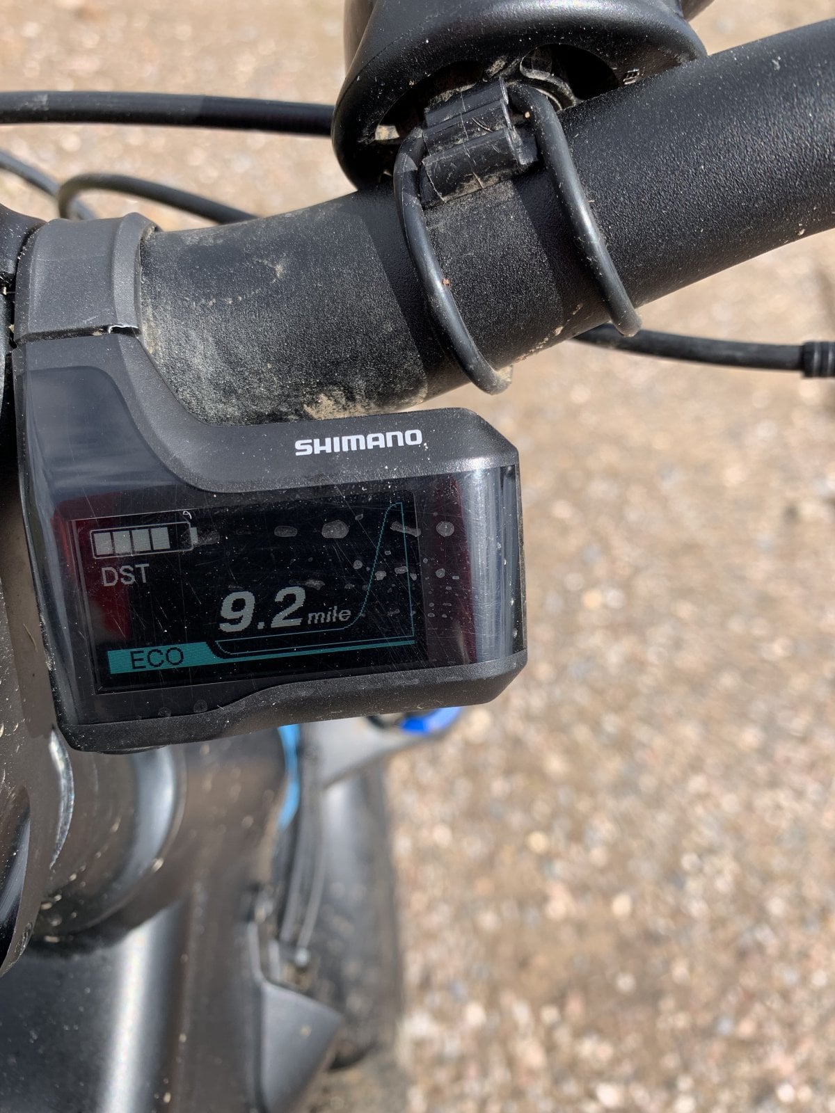

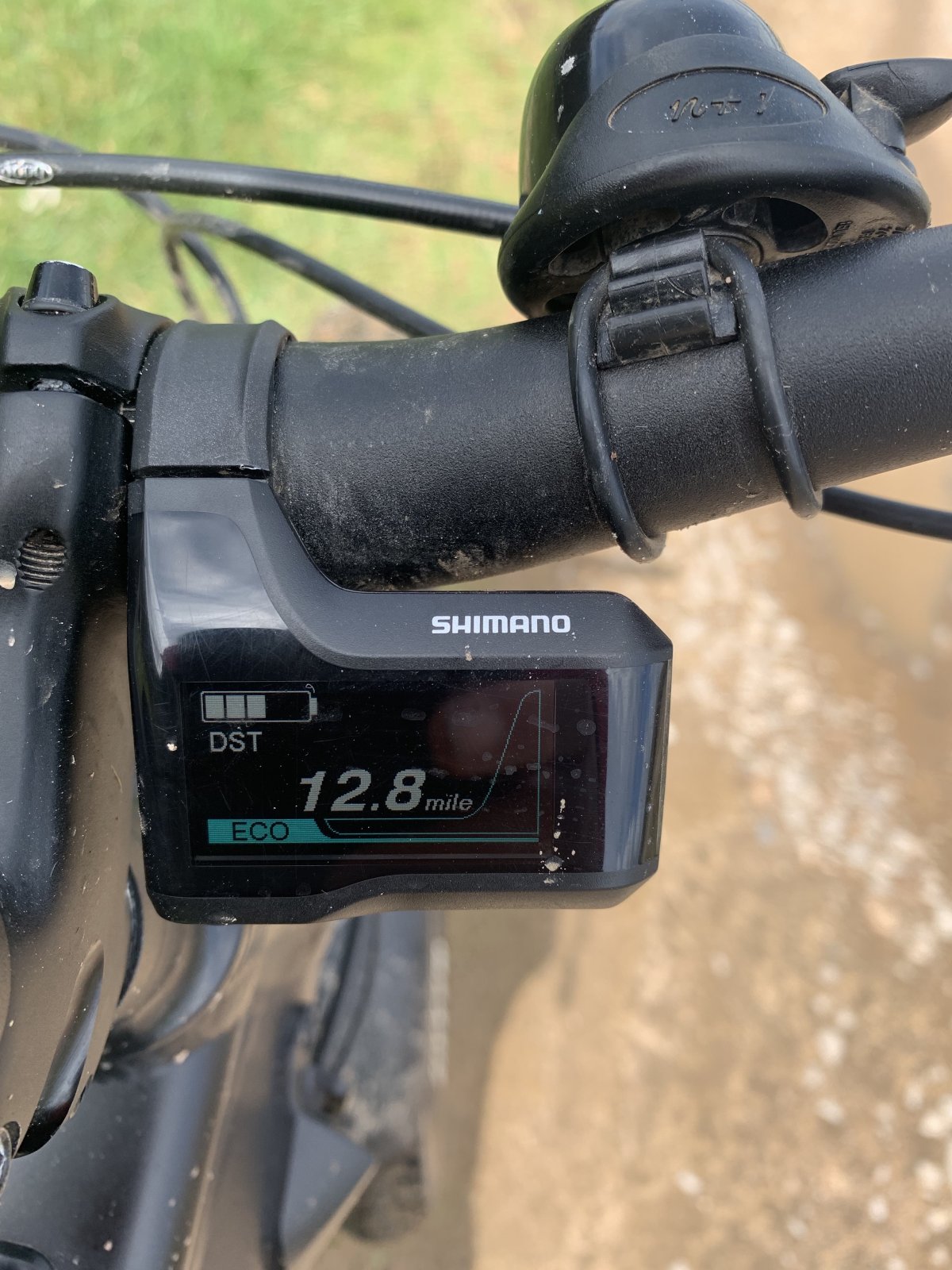

Update 23.04.19
Hi all, I went out for a ride today here on the Isle of Wight.
Ryde to Ventnor Radar Station, (St Boniface Down if anyone knows it?)
It's the highest point on the island.
If I had more time available, l could have gone much further.
Ride stats - bike retuned as mentioned earlier:
25.5 miles - 2296 ft climbing.
At the end of the ride I had
3 bars of battery remaining- probably more like 45-50%.
19 miles of Eco remaining.
14 miles of Trail, and 9 miles of Boost.
Great ride, but a fair bit of effort required when in my new lower Eco setting, but I'm more than happy to put this effort in.
I did exactly the same ride before I retuned my bike (so it was on the Shimano factory settings), and the battery died completely about 400 metres from home.
I don't feel the need for a TEC pack anymore, and if you're looking to increase the range of your Jam2 by approx 50% and are happy to pedal, you can ride far and fast, even with the power turned down.

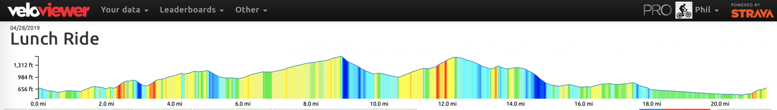

First try, so i'm 59, weigh 15 stone, recovering from bulging L4 disc with muscle spasm in right thigh and mainly dead knee. So i'm recovering, not at my fitness levels and need to keep pressure off my thigh muscle while try to slowly rebuild. Bike is 10speed with 2.8 Recons.
First setting, no change to boost as i don't really use it. Trail 80-45 Eco 30-30.
I ride mainly in eco and this ride was mostly eco other than a few short climbs in trail.
I could certainly tell i was working harder, higher heart rate and was working right thigh and good free the muscle working but it felt OK.
I would usually come home with a red last bar nursing the last few miles, with these settings I still had 3 bars about a mile from home.
