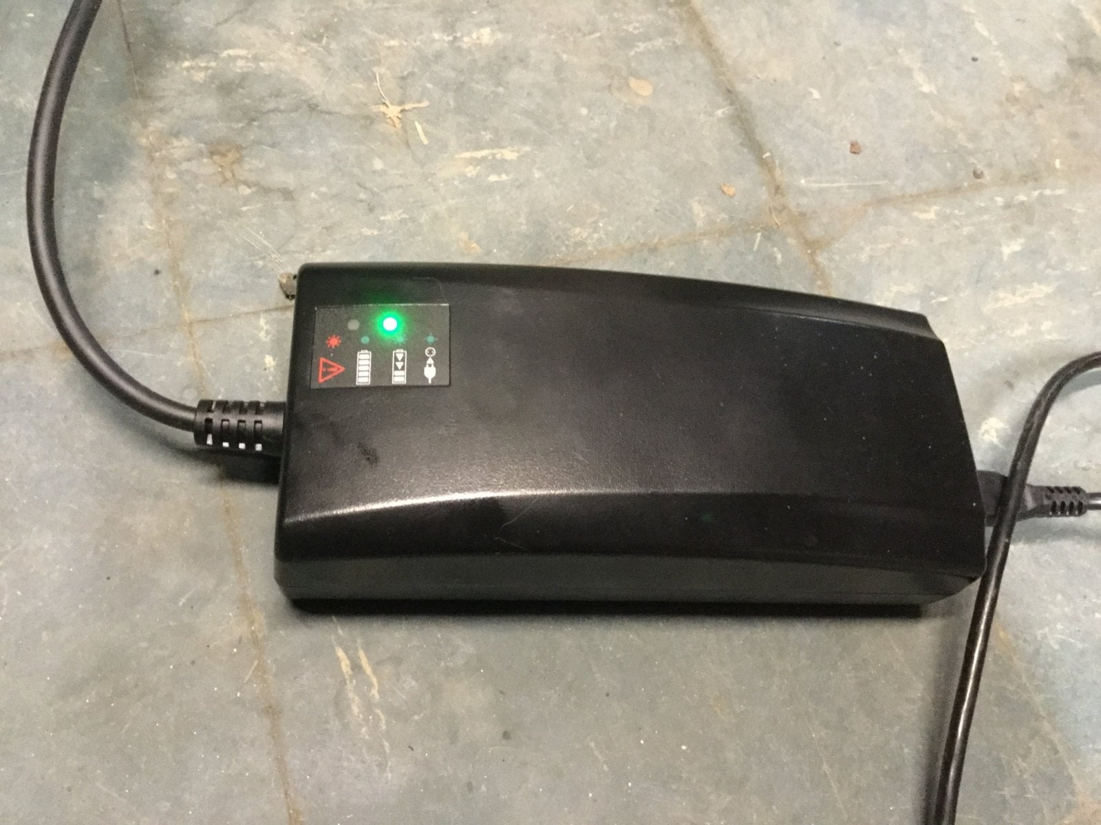

Has any one had a changing problem?
I had it happen 3 times:
On all 3 rides it was wet and muddy or a snow ride and the battery was used down below 25% .
What happens is you plug the charger in and you hear the relay in the charger click, and then you hear it click again and it stopped charging.
So I thought it was related to moisture, but now I’m not so sure, last night I tried charging and it wouldn’t charge and then I plugged the charger into the wall socket and left it for 45 minutes to let it warm up then I plugged it into the bike and it started charging perfectly ?
I have made sure the charging port is dry and not wet I also have the little magnetic cover on it when I’m riding .
Has anybody had any issues charging similar to this ?
Thanks and look forward to your replies

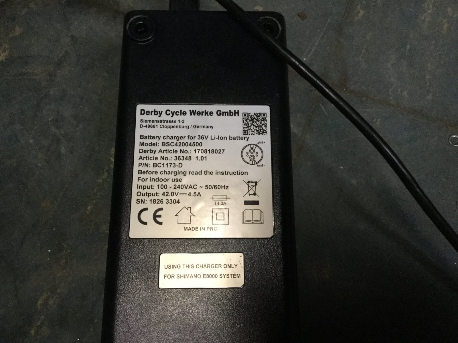

Here’s my charger below

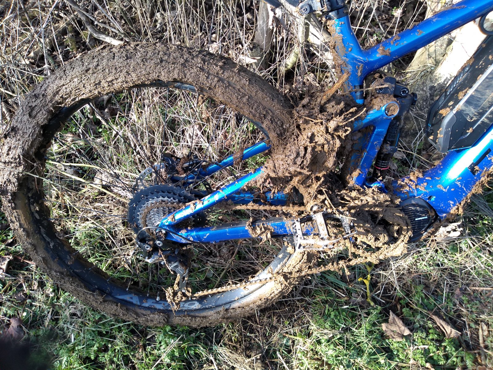

Have you ever done a really wet ride, has that affected your bike in anyway ?

No problems with mine. Have you tried turning it off at the mains whilst plugged in to the bike ? Leave it a few mins then turn it on again ?

What seems to work is if I plug the charger in the wall socket for a half hour and then plug it into the bike it seems to charge but I have to try that again to see if it works consistently

Same charger as mine which is silent. Both rides this weekend have been in snow so both wet and cold but charging afterwards was instant. Are you able to borrow another charger to confirm if its the charger or bike?

I had a similar problem. The charger worked fine except when the frame battery was drained to the point where it switched the motor off.
It was weird it wouldn't charge the frame battery but it would charge the TEC pack. Then I read the manual and it said that it would not charge at full rate when the battery was at 23V or lower. In which case it would only trickle charge. Like yours it started off flashing (as normal) and then switched itself off. After initially suspecting the battery, once I read that, my suspicion switched to the charger. I suspected that the trickle charging functuion was inactive, but not the 23V trigger! I borrowed another charger and it worked fine. So I now have a warranty claim being pursued for me by the retailer.
I later drained the TEC pack down to one bar in the red (ie not so that the motor switched off) and the charger wouldn't charge that either.
PS: My charger is exactly the same as yours, serial number ending in 4500, with a 4.5A max charging current. The charger I borrowed ended in 4000 and had a max charging current of 4.0A. I told the retailer that I had no idea whether the max charging current was an important difference or not, I'd let Focus sort that out.
I think you hit the nail on the head.
That’s must be happening with mine.
Have you left your original charger hooked up when it appears nothing is happening, and after a 1/2 hour unplug everything and try to to charge the battery to see if green light stays on?

@BigFoot : No errors shown. I left the charger on for a couple of hours and then switched it off and checked the state of the battery, just in case it had been trickle charging without any lights showing. It hadn't. I also tried repeatedly switching it on, waiting for the flashing green light (indicating charging) to stop after the usual 15-20 seconds, then switching off and then on again. I was hoping that the battery would get some charge and if I did this often enough, the fault would clear. I ran out of patience before I could detect any change at all.
The retailer (JE James in the UK) accepted there was a fault with the charger and agreed to pursue a warranty claim. After I found the same fault on a low charged TEC pack, I'll be ringing them tomorrow to report that and to enquire as to progress with the warranty claim.

In summary, don't jet wash your bike, use a bucket and brush and you'll be fine! :)

I finally got a response from JE James in Sheffield. They have got hold of a new replacement charger and will be posting it to me this coming Monday. :)

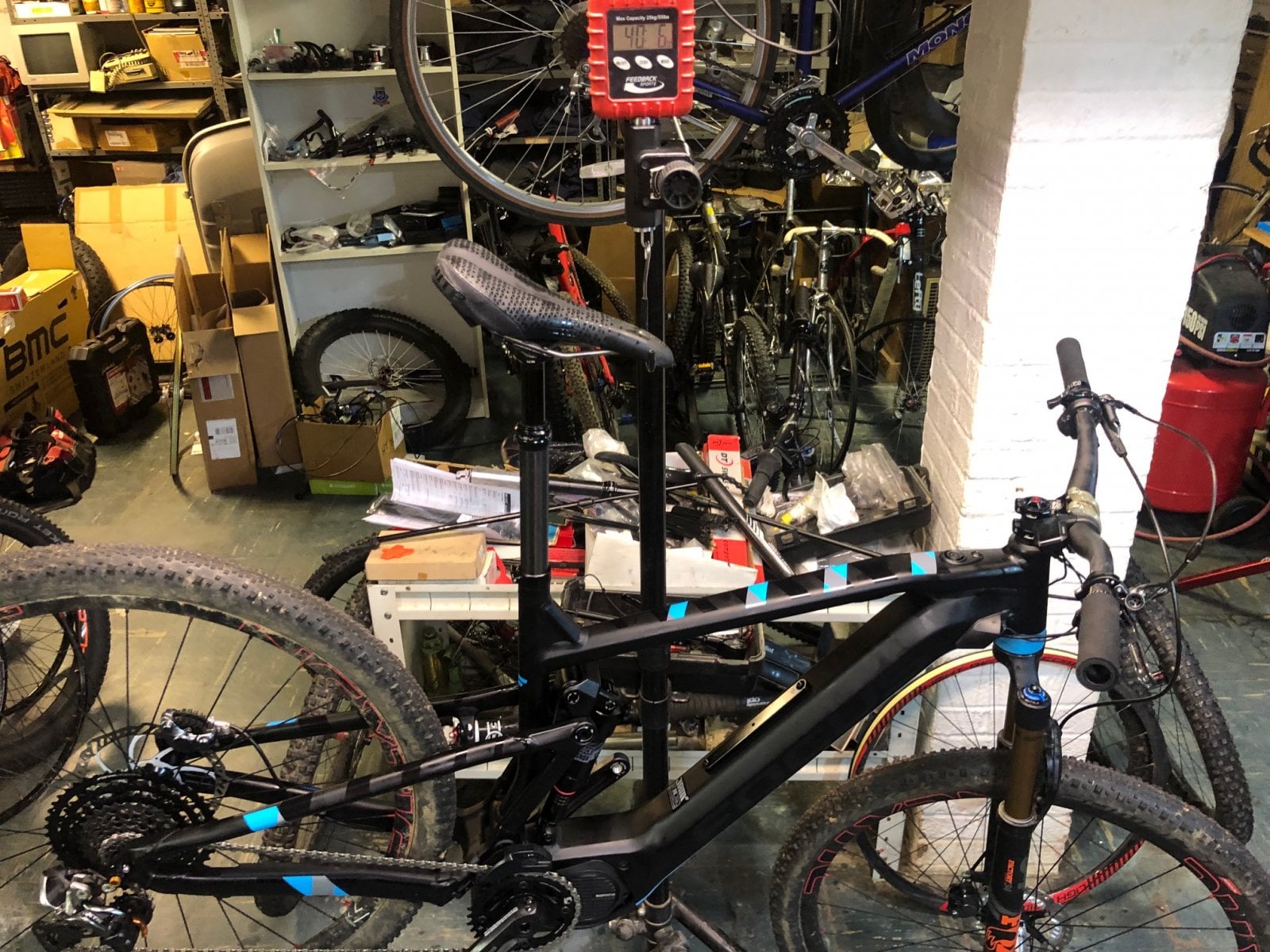

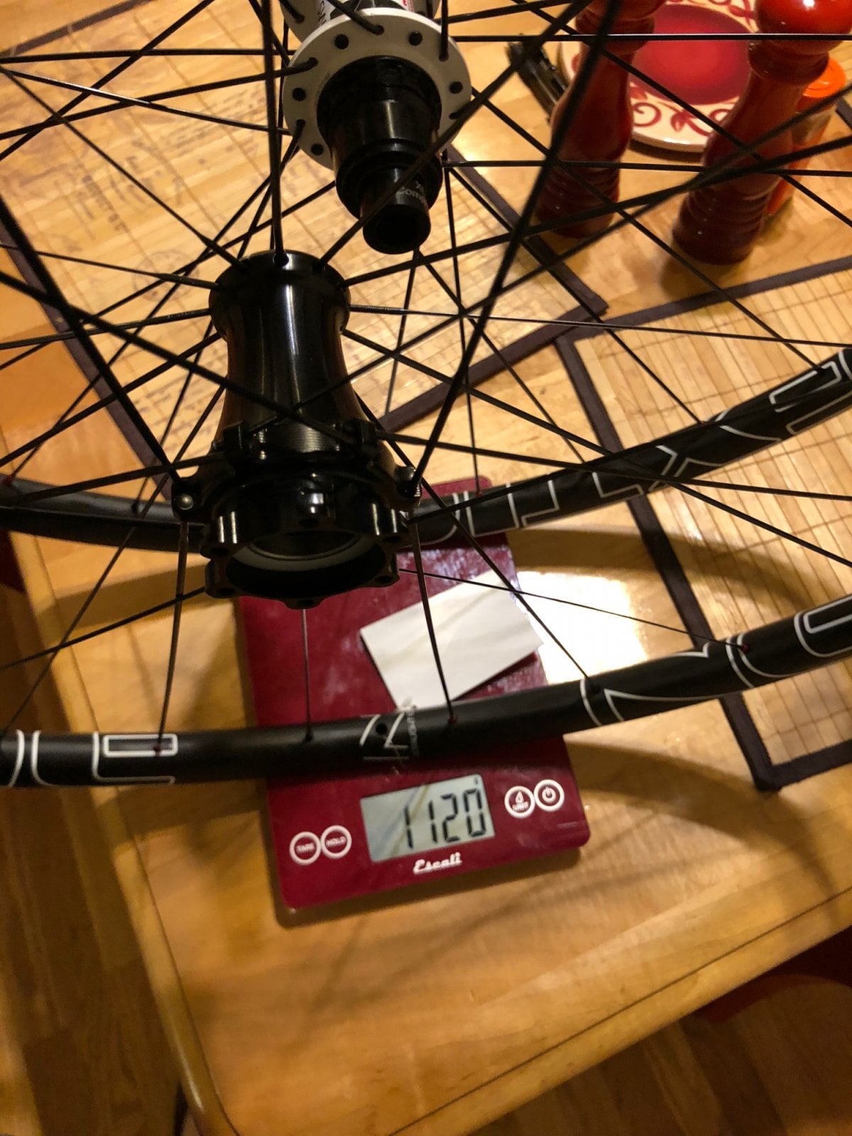

I am 57 year old 195lbs , 6' 1". The hills on this ride were rolling No big climbs, I stripped 7.5 lbs off the bike, and put nextie rims that have T700 and T1000 carbon fiber (Wheel set weight 1300Grams)
see picture of my friends wheel set I built, my set has heavier hubs and more spokes, they both have 280gram rims, and I am running 2.25 racing Ralph Rays, tire alone are 2lbs lighter than stock tires.
I was pretty free with the (trail mode) up to mile 12 or 13 and I was at 49% battery and realized I was not going to make the loop, so I started only using eco and turning the bike off if it was fast and flat. I also set FreeMax for Eco to 30NM and 45% assistance , Trail to 55NM and 60% assistance , crank length changed to 175mm XT.
see pictures
Oh I was clipped in with eggBeater,
All these things helped and I also pedaled .

I JUST CHECKED IT IS 44F IN GARAGE MY BATTERY WILL NOT CHARGE :(
It has been in garage for 4.5 hours
see pictures

So Bigfoot, you are also concluding that low temperatures are the reason for the battery refusing to charge. I am yet to find any mention of this in the manuals.

The Lithium chemistry used in our batteries does not like cold temperatures or in fact extremes of hot in terms of giving up its energy or receiving. As a rule of thumb you should charge when at say room temperature in an ideal world.
