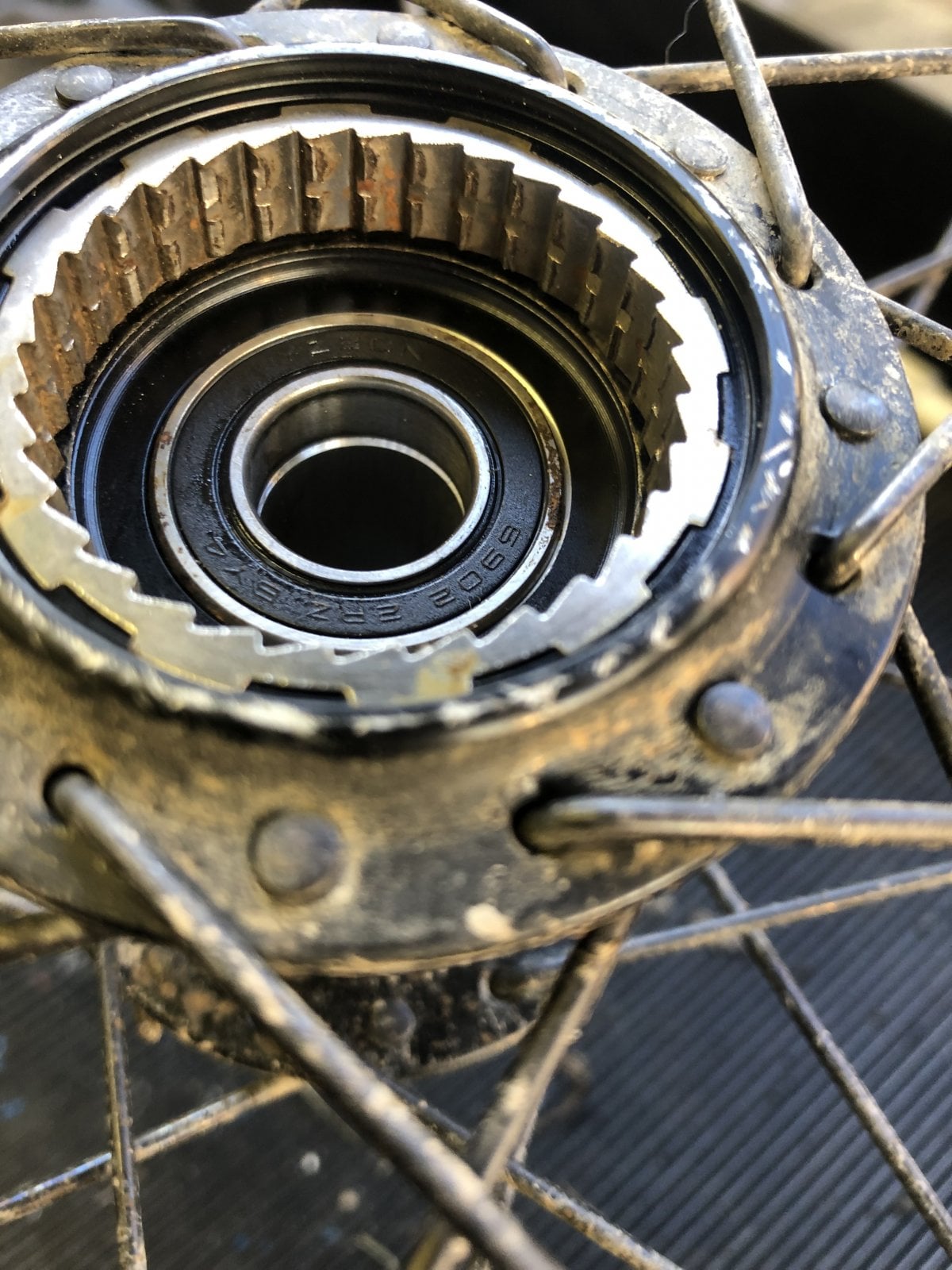

Just swapped across to Hope Pro 4 hubs on my 2021 Focus. The Nova design was poor, and caused failure, and ruined a good ride.

Ok. I don't think my riding is that hot that I would notice a poor hub. 🤦‍♂️😁
You will once the hub strips it’s teeth, your legs go flying around and you fall off. Well I noticed it.
