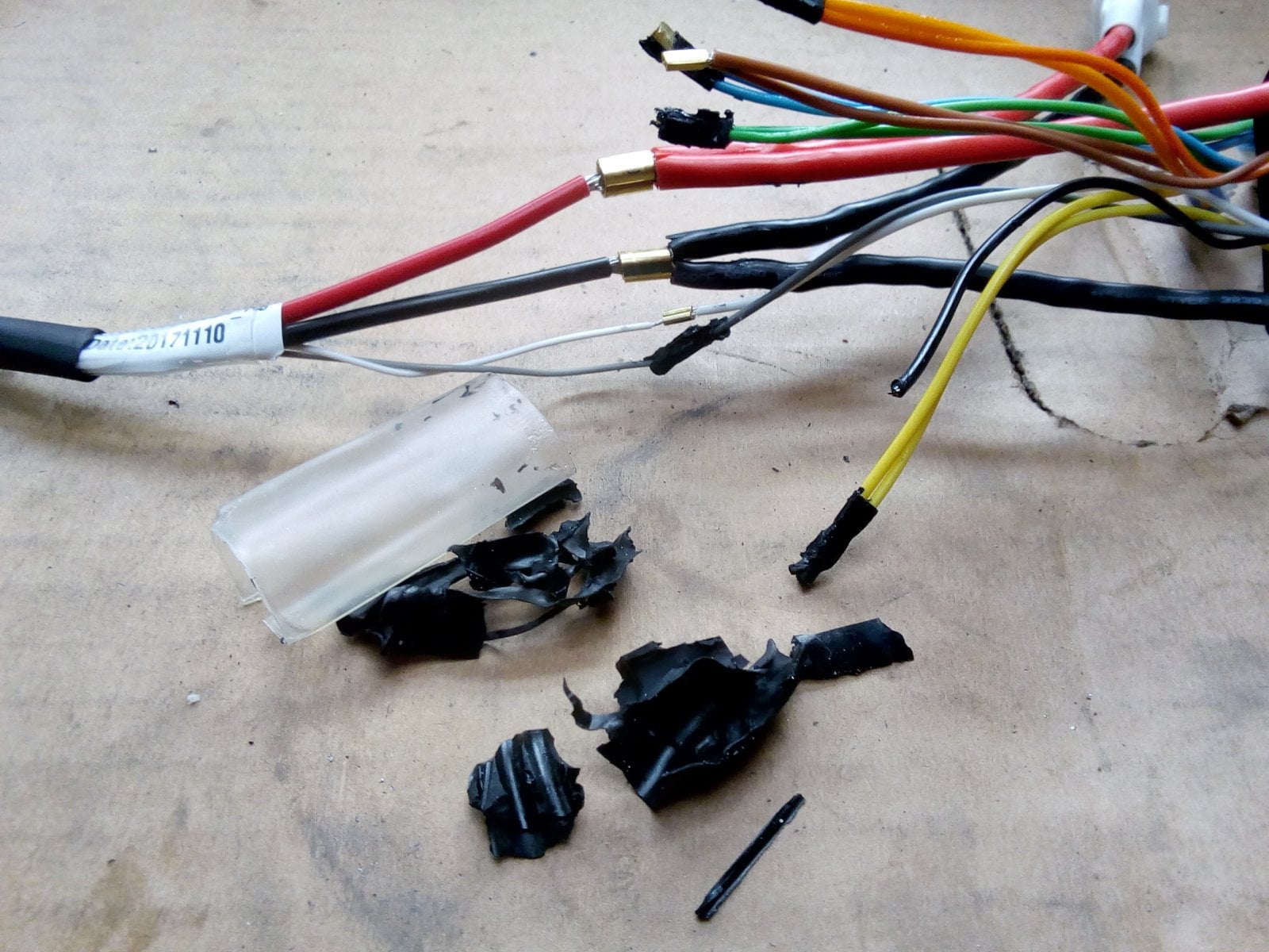

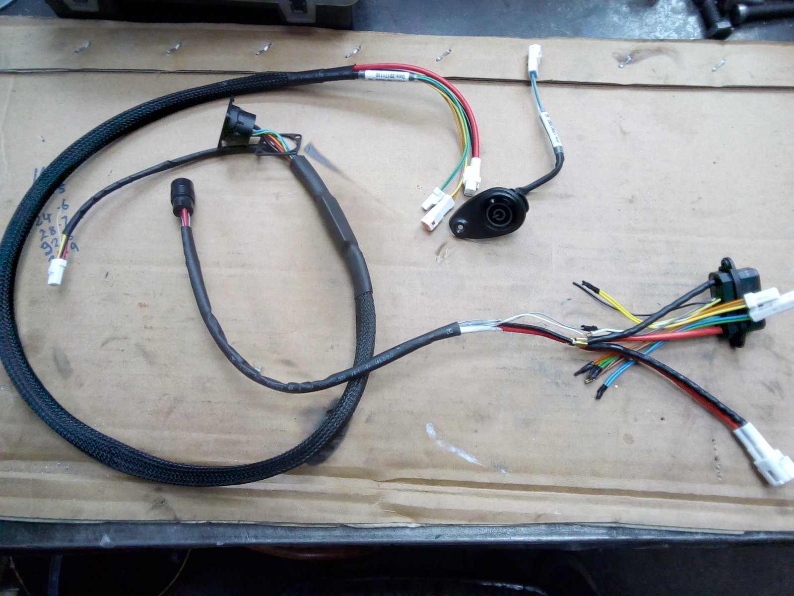

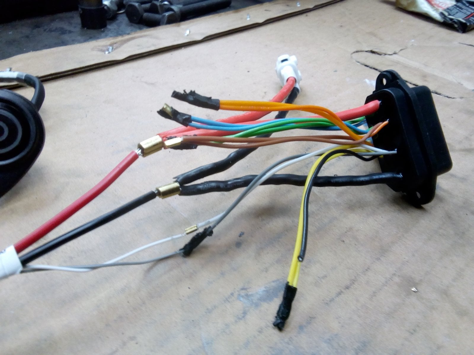

Removed the complete wiring harness from the jam last night to check for continuity of the various wires , I had to satisfy myself that no fault existed with the loom it's self, all check out ok.
However, all the wiring that comes out of the battery about 3" latter disappears into a black rubbery lump of silicone like material.
I picked all this apart, my biggest surprise here was nothing is soldered together, only crimped.
The thin wiring joints had heat shrink insulation , very good, but the heavy black and red cables ( the main current carrying cables !)
have no insulation!! Only separated by the silicon like material. Fair enough the are not touching , l would soon be aware of it if they did!!,
It's hardly a well executed design?
I'm just pedantic when it comes to doing things properly .

One thing I forgot to mention was if you look at the third picture down , you will see a thin black wire( just above the 2 yellows) with a clean cut end, this was connected to nothing inside the black rubbery block! .
I don't think it's broken off any other wire as the end has a clean cut.
I can only assume that the black multi pin connector it comes from is from another system / bike and wasn't required for use!!
I wonder if focus will supply me with a wiring diagram?! The saga continues

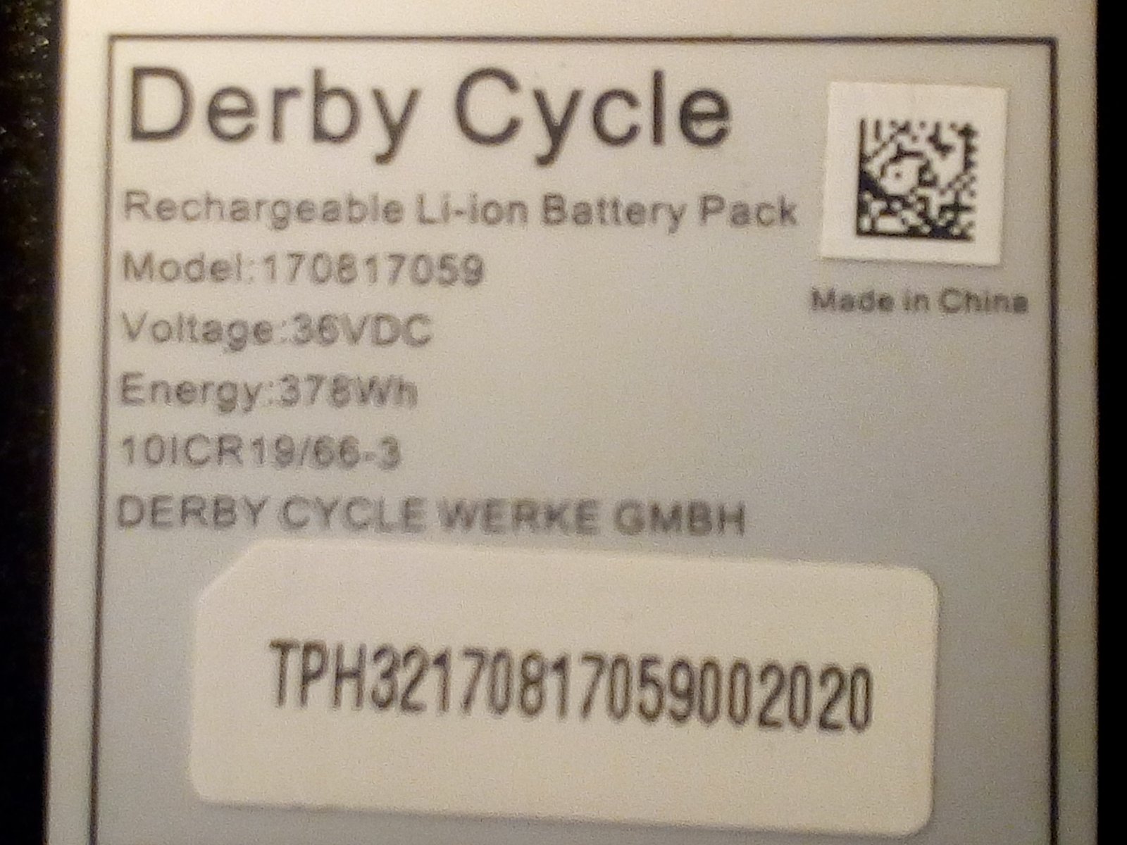

Actually it very well could have something to do with BMZ. The fact that it uses LG cells, which BMZ is heavily aligned with LG, and the fact that it is made in China where BMZ has one of the largest battery manufacturing facilities at this time. Derby GMBH is just another branch of PON Holdings, the parent company for Focus, as well as other brands
