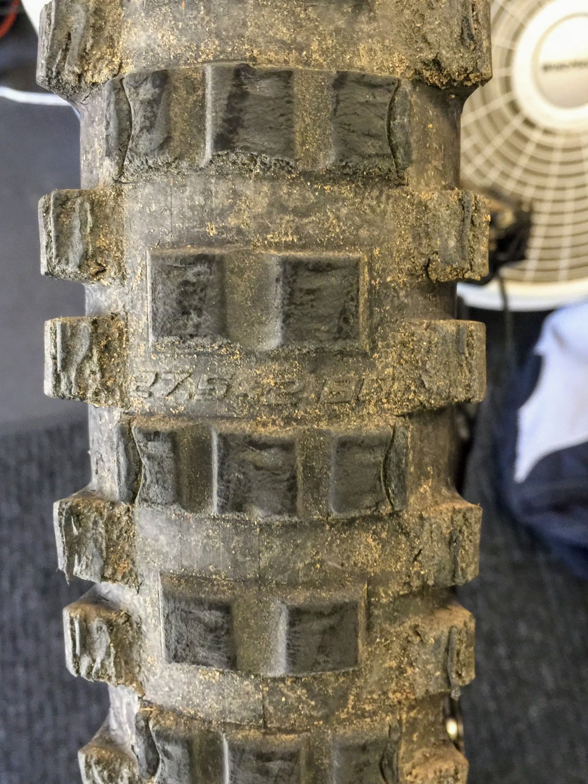

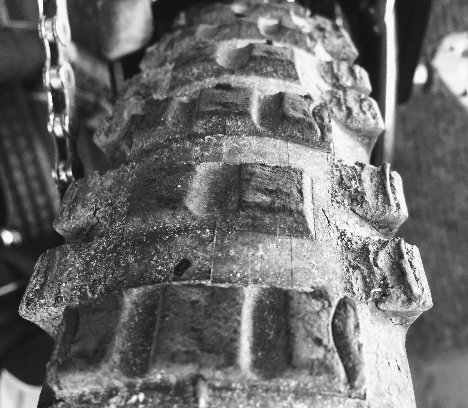

I replaced a worn out 2.5 HR2 on my rear wheel with an Eddy Current 27.5x2.8. My first impressions are:
-Very good climbing traction and braking on hard/loose over hard terrains.
- Average cornering grip, not as predictable as a Maxxis HR2 or Aggressor 2.5.
- very poor grip on trails covered with lots of dry pine needles. In these conditions a 2.5 Maxxis Aggressor is the best tire.
- very slow rolling
Rain is coming in a few days, will update with my impressions on wet terrain.

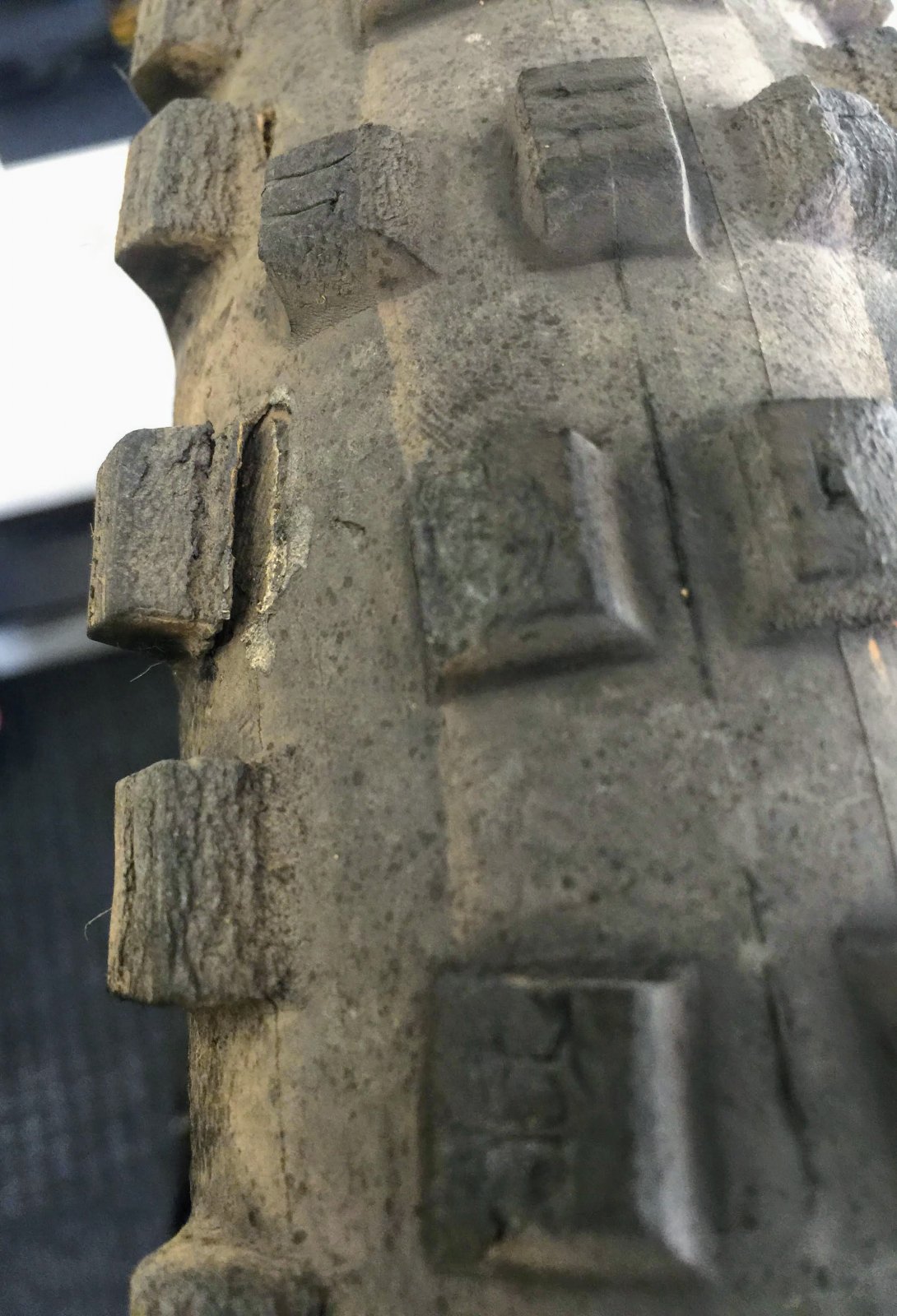

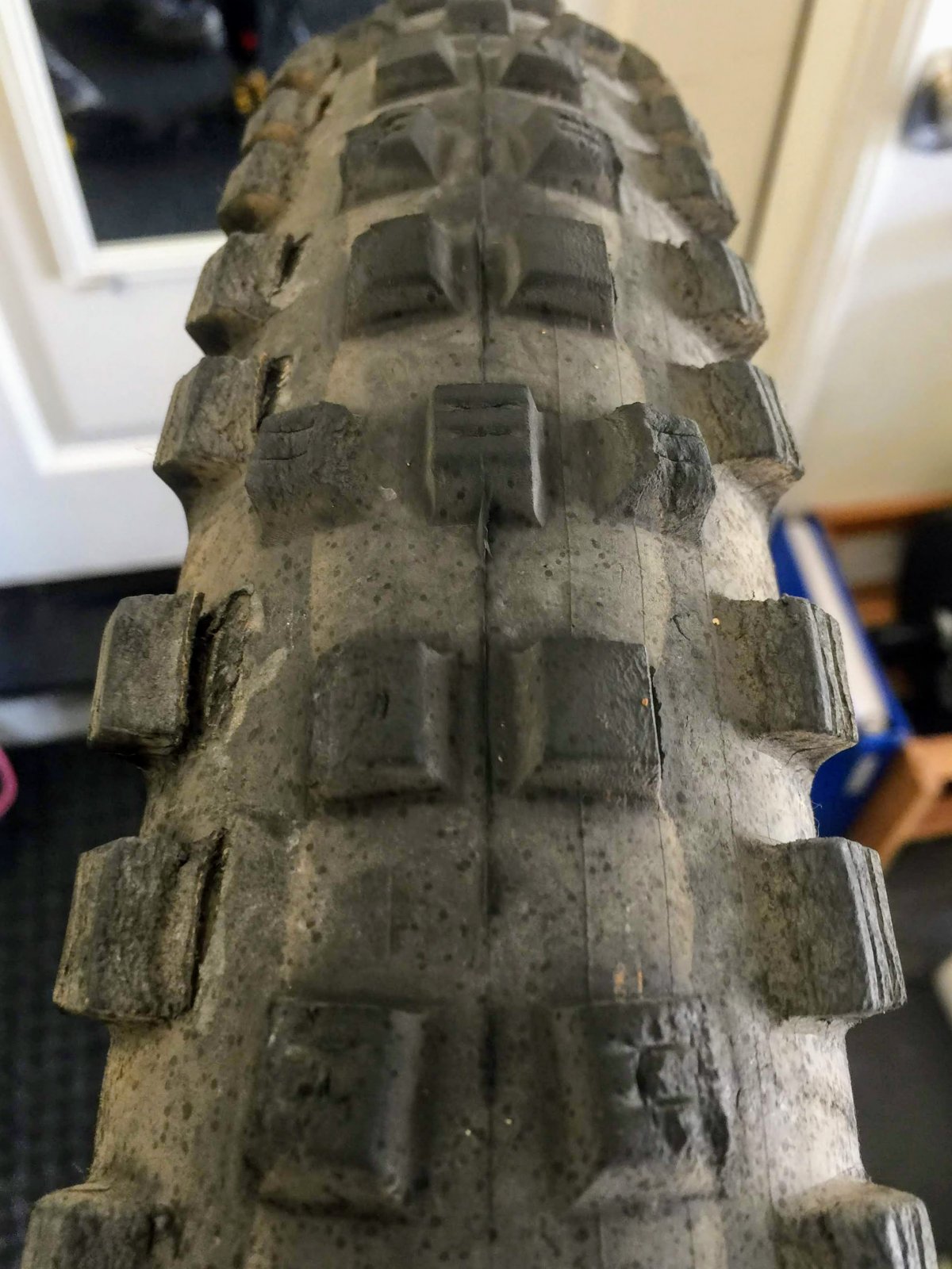

Thanks. I've been looking for a replacement front tire for my Kenevo. On my acoustic Enduro 29 I love the Butcher 2.6. But in 2.8 on the 27.5, the gap between the center knobs and outside knobs seems huge and needs some king of transition know there in a way it doesn't on the 2.6. I ordered the 2.8 magic Mary's today and they look like a good option to pair with the Eddy Current 2.8 on the rear. A beast of a tire for the rear but it seemed to out grip the front Butcher 2.8 and I like the rear to let go a little before the front. I got one for a good price on Amazon and hope they will be an improvement in grip here in dusty SoCal.
Here is the Magic Mary on the front after 568 miles of dry and Rocky So Cal riding. Many side knobs are breaking off.
The Eddy Current is on the rear and has 786 miles and the side knobs are worn but not tearing. Will keep using the EC but need another Front tire option.

The climbing traction of the Eddy current rear 27.5 x 2.8 in snow and sticky mud is simply outstanding. It's my new favourite winter rear tire, alongside with a 2.5 Shorty in the front wheel.

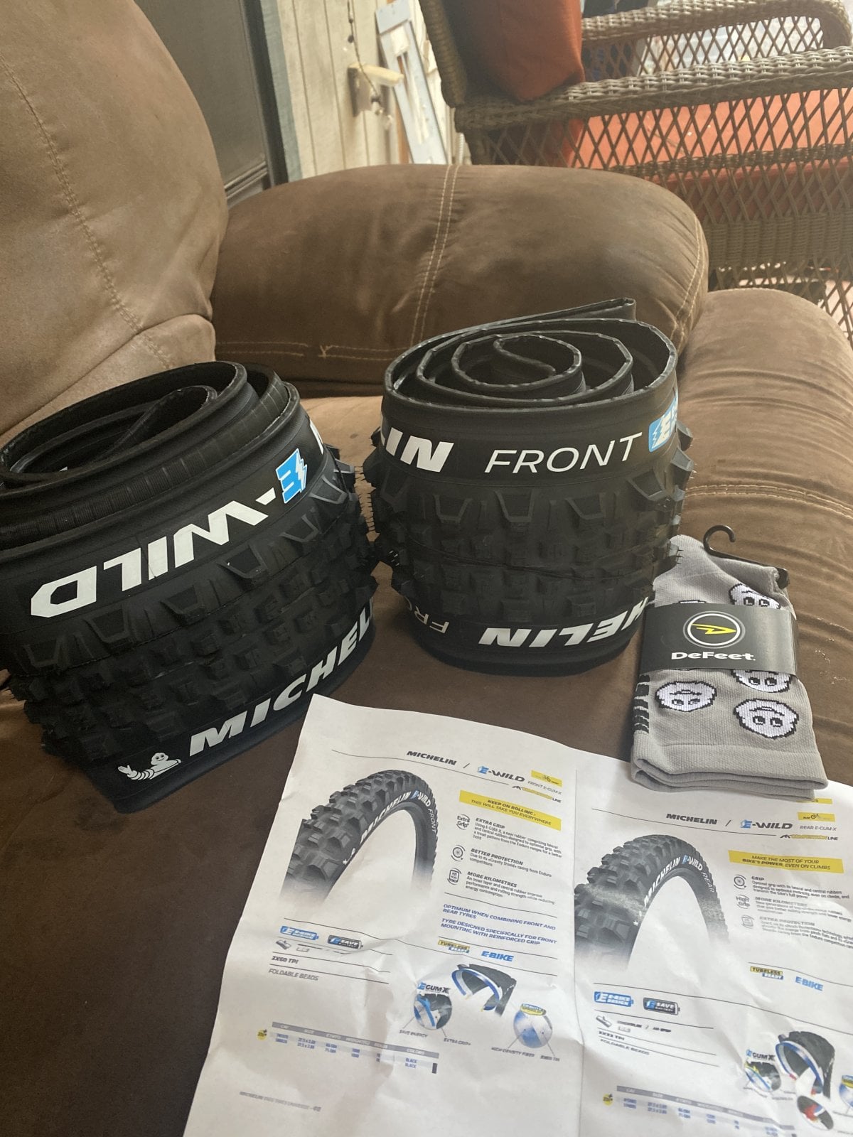

Michelin has supplied me with two 29x2.6 E-wilds to throw down the mountain and write a few reviews on. They just came today so i be mounting them up on two different rim widths. 32 internal and 35 internal to start!
I don’t ever run any type of cores up front so they just be tubeless installs. even got a set of socks to go with them.
First glance. There is a front and rear and the rear tire shares the same tread profile but the tires casing is considerably stiffer and heavier tire. for the weight weenies
Front tire is 1058g
Rear tire is 1318G
