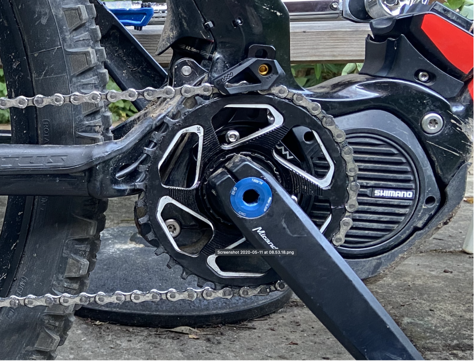

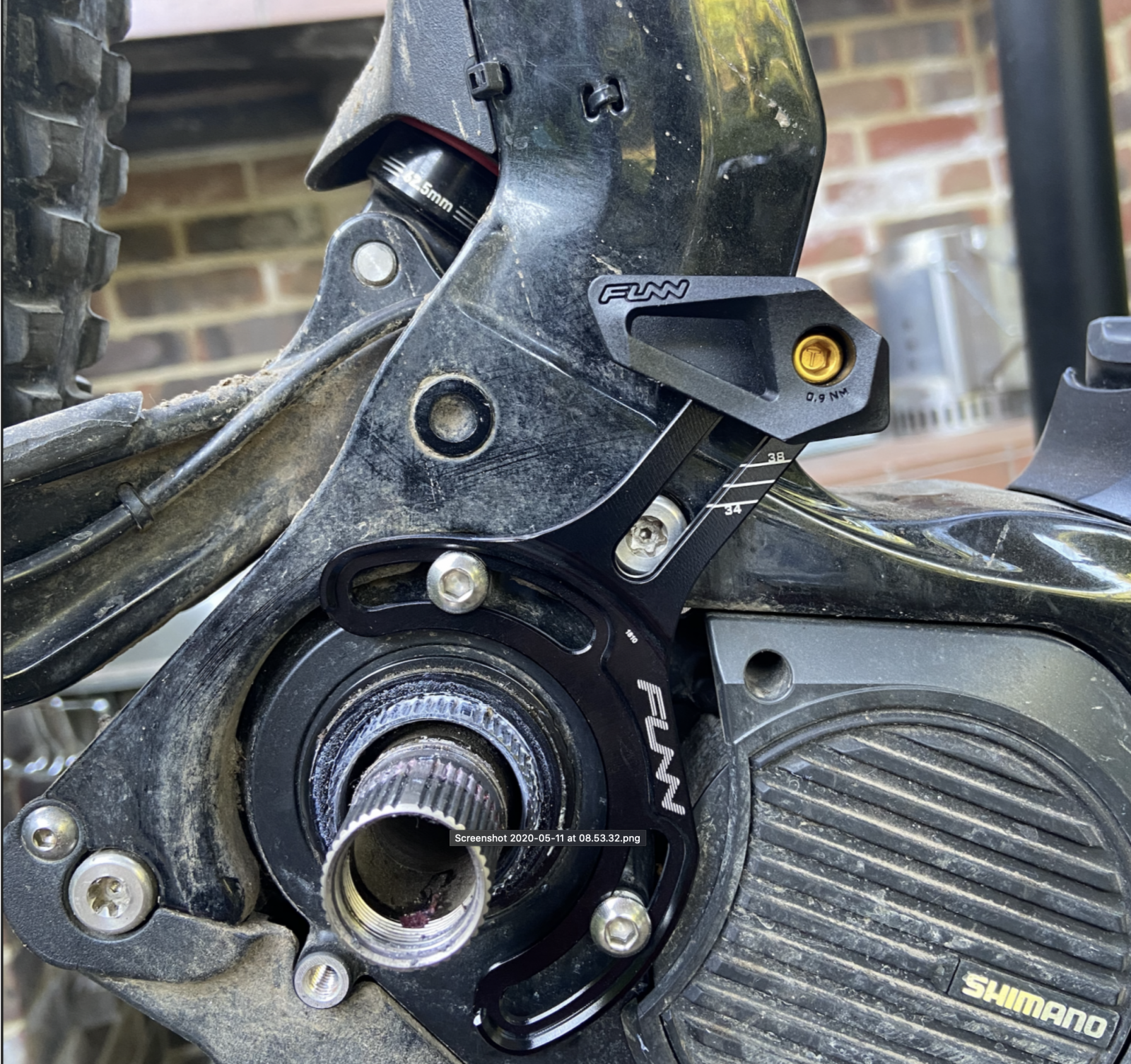

9,185
The e13 one is a POS in my opinion, I don't have decoy but I tried the E13 for while, and it was just a really cheap plasticy piece of kit. I now have a Funn one which is much better, and better looking to boot
