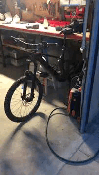

So my 2020 Cube Hybrid Performance 500 got the 504 error. It is not modified. I'm trying to follow the advice with the drill. So I switch the controller on, set to Eco, start the drill and let it run. Few minutes later, I come back to check up, and controller has turned itself off. Same as it does when you switch on the controller, but don't pedal. Is this OK? Will it still fix the error? Should I stand next to it and press some buttons every few minutes to keep it on? The controller shows speed when drill is running. I have no idea why it would switch off by itself? Any advice is appreciated!
I’ve tested.
I set “off” mode and drill 90minutes.
In every 4-5minutes I was click minus button to change display ( kilometers / range / total distance maybe is not needed I don’t know but purion not turned off. If I used mode eco/Tour: emtb/ turbo - purion was turned off)
After 90minutes drilling I turned off purion and on. And error gone :)
My motor is Bosch performance line Cx gen2 1.8.6.0
