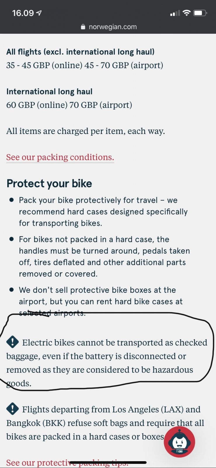

Forexample, norwegian says that even without battery, ebikes are not allowed.

I’m guessing that’s due to the motor aspect. There really can not be any other reason. I wonder if you can fly a battery drill with the battery removed for example?
I think it's more likely that they have a blanket ban in place because some bikes just cannot be inspected easily. Specialized, for example?
For a budget airline, I can see that will be an attractive cost saving - no staff training needed. No doubt Ryanair will be looking closely at this too. :mad:
