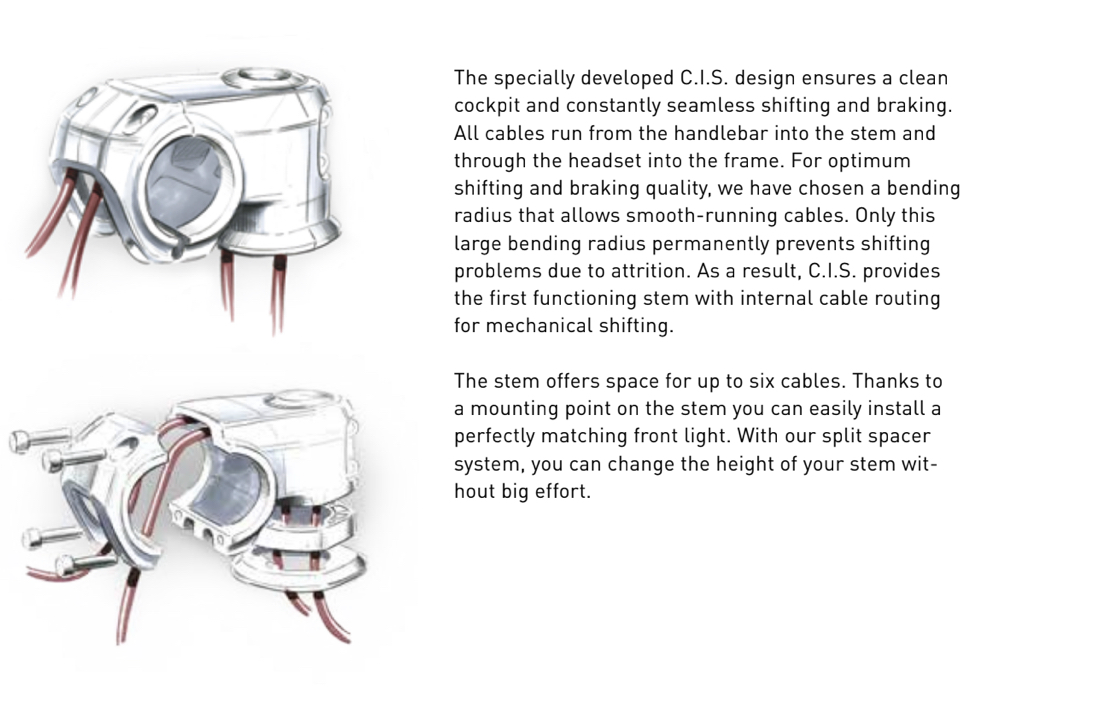

Whilst the cable routing is a very neat idea, I presume a PITA if you want to change the stack height or of course the stem itself - @Rob Rides EMTB are you able to do some pics with the stem removed to show the routing?
Here’s the detail. No issues with stack height, it has spacers that are shaped to allow it to be changed.
