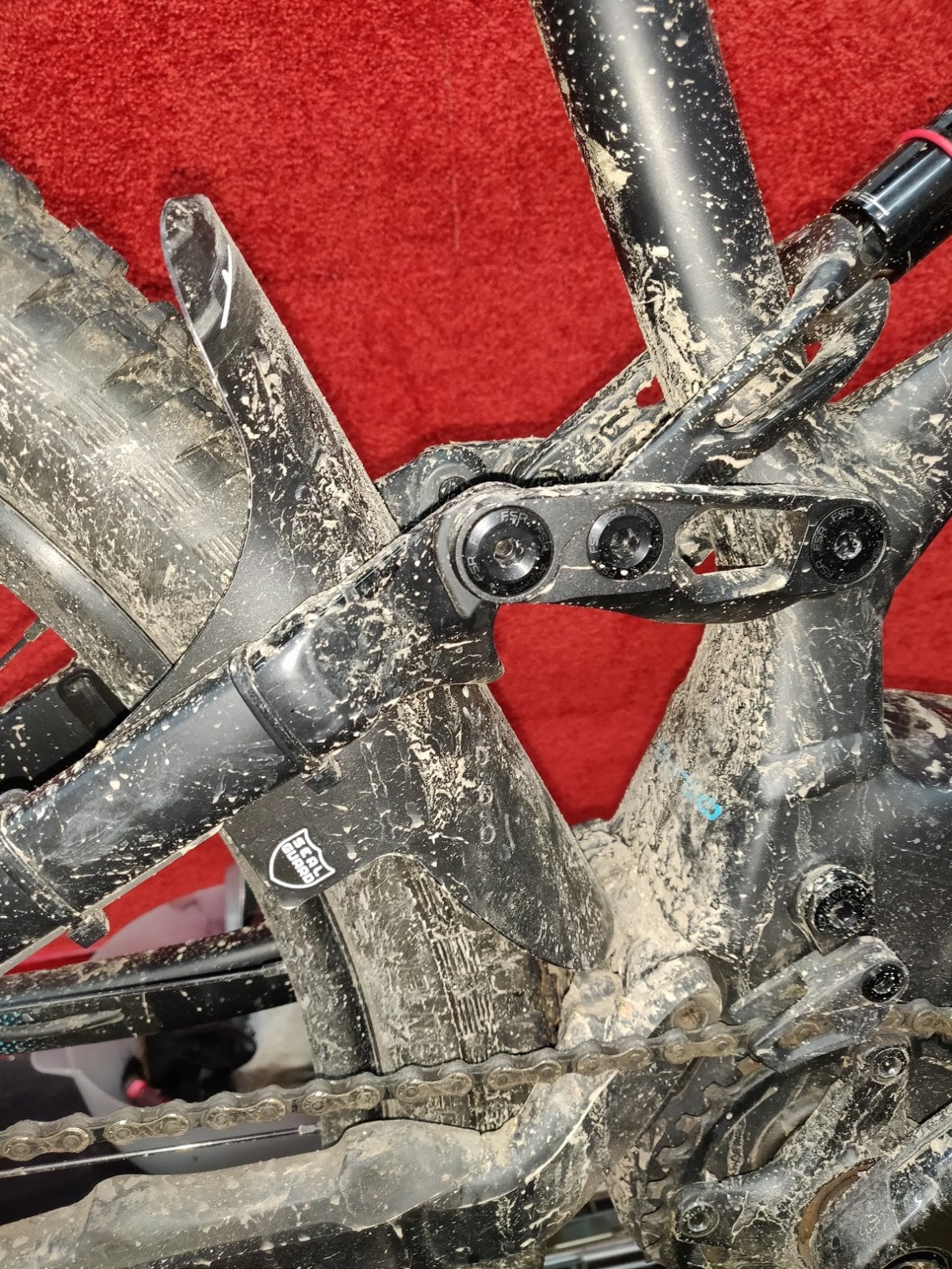

I need a bit of help here, I've mounted a SICOMTB Mudguard V2 on my Levo Comp 2020. However, its getting worse, the gravel is bombarding the lower swing, see attached pictures. I am not impressed with the Mudguard so far...any help or suggestions to mitigate this issue?
Cheers Greg View attachment 30808
That's not great for a product designed to protect the bike.
Have you informed @SicoMTB ?
I'd think about either using thick helicopter/gorilla tape like the stuff you get with Mudhugger guards, or perhaps putting back the plastic guard and fitting a trimmed down Central Coast guard instead of the bottom section of the SicoMTB V2.
I'd previously thought about getting a @SicoMTB guard for my 2020 expert, but didn't like the high price, or the fact you have to remove that little plastic protection piece.
IMHO it would be useful if they would just sell the top section separately

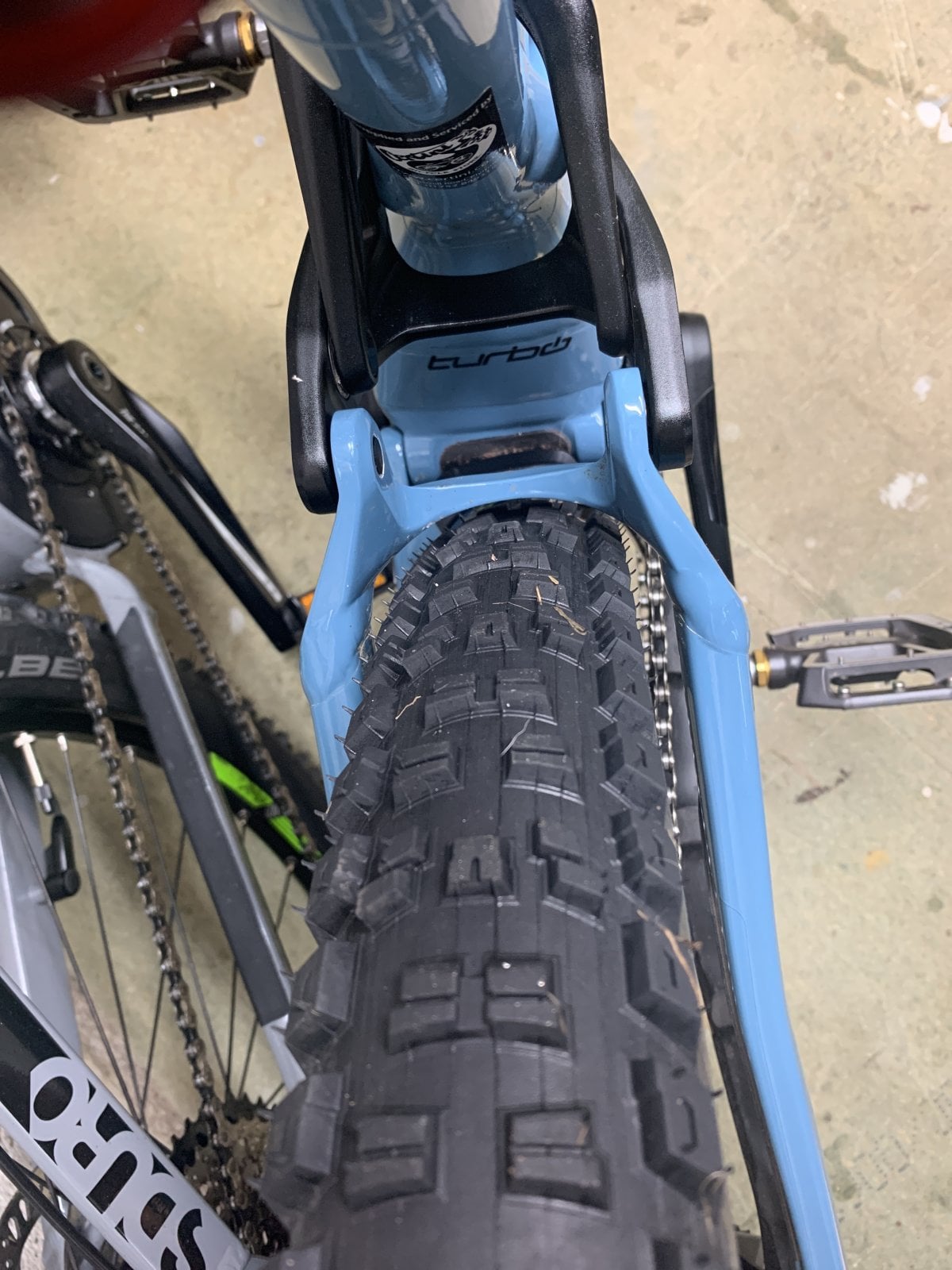

Thanks for recommendation. Still not sure it will fit 2020 with 2.6 rear
View attachment 19111 less than 5mm clearance without mud n crud
After looking at a few options for the Levo 2020 with 2.6 tyre and found that it was not that easy to fit a mud guard and one that have good coverage I installed the Carbon effect sicomtb rear mud guard.
The fit looks tight but I have had no problems. Occasionally a small rock will will stick to the tyre and you can hear it hit the mud guard but it will come off. I have done around 70 miles. No damage to the mud guard.
I have not yet tried in very muddy conditions as it has not been raining that much in in Scotland. The bike comes back from the ride much cleaner.
Installation was easy.
The mud guard looks much better than I thought. it is expensive but it seems to do the job especially protecting the motor housing.

Take Scotchguard 3M oder SlapperTape to protect those areas.
Greetings from germany
Yes, Slapper Tape might work here. However, I am a bit disappointed by the Mudguard. I know the paint is crap on Spech Bikes but this is looking s**t.
Cheers Greg View attachment 30808 View attachment 30809
I ordered a V2 also and didn't like that it doesn't protect the Frame like the older version. I ended up ordering a V1 and going down a tire size. I minion DHR2 29x2.4 fits perfect. A 27.5x3.0 also fits perfect.
It’s job is to protect the pivot joint and to keep mud out of the motor.

Just fit a smaller tyre , you'll have loads of room then.
Mine with a high roller 2.3
