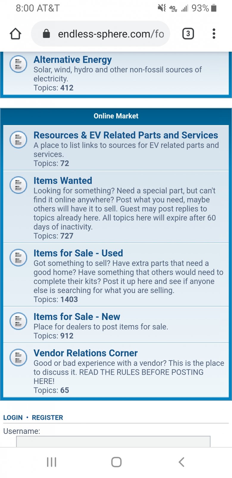

Maybe list it in the for sale section and see if anybody locally is interested. Or go to the endless sphere and post it forsale.
The batteries can be dangerous if tampered with, so there is that to consider as well.
If it's as described earlier... holding a charge but not accepting a charge, I suspect the BMS (battery management system) is toast, but it's very likely the cells are ok. There are plenty of DIY folks out there building their own packs, and I suspect the cells alone are worth ar least $100 but there is always the chance it's all junk.
