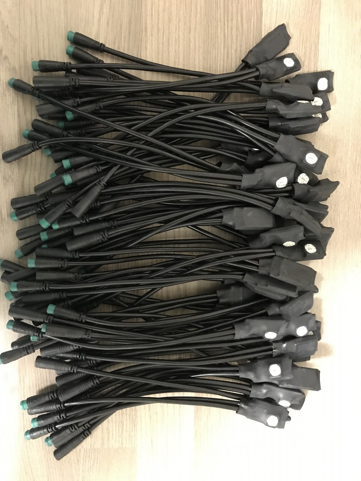

1st batch dispatching from tomorrow.
Worldwide customers. Free shipping.
Almost sold out ?
