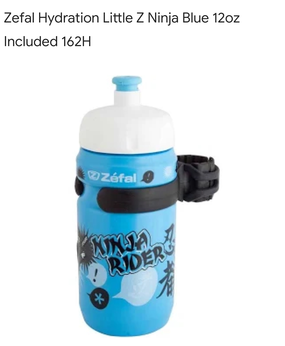

I haven't found a bottle cage or bottle that works with the Kenevo, but I'm still looking Just ordered this combo, a small 350ml bottle and a reversible side loading cage. Pretty stoked about the ninja bottle, I'll report back after I try it out.

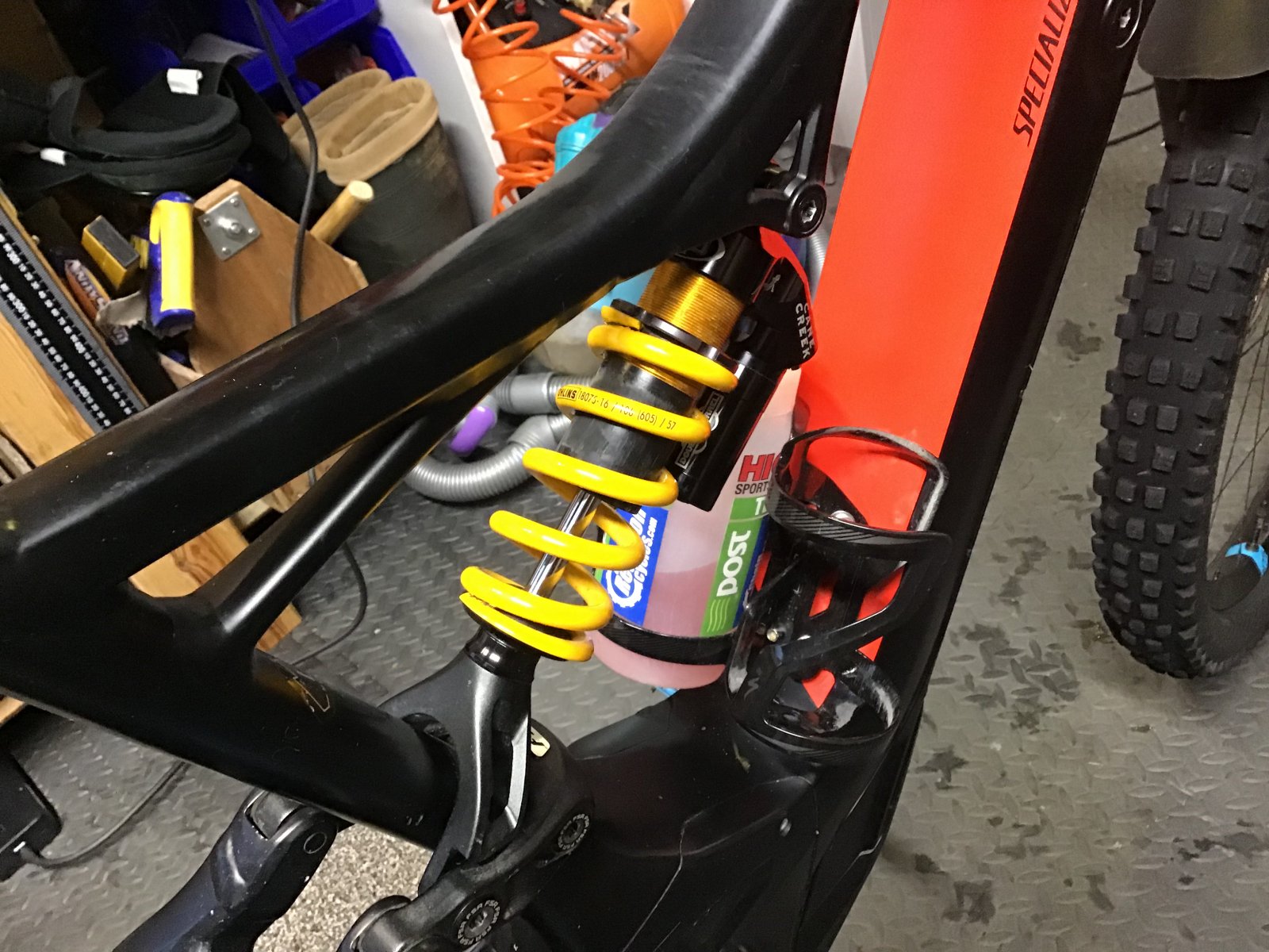

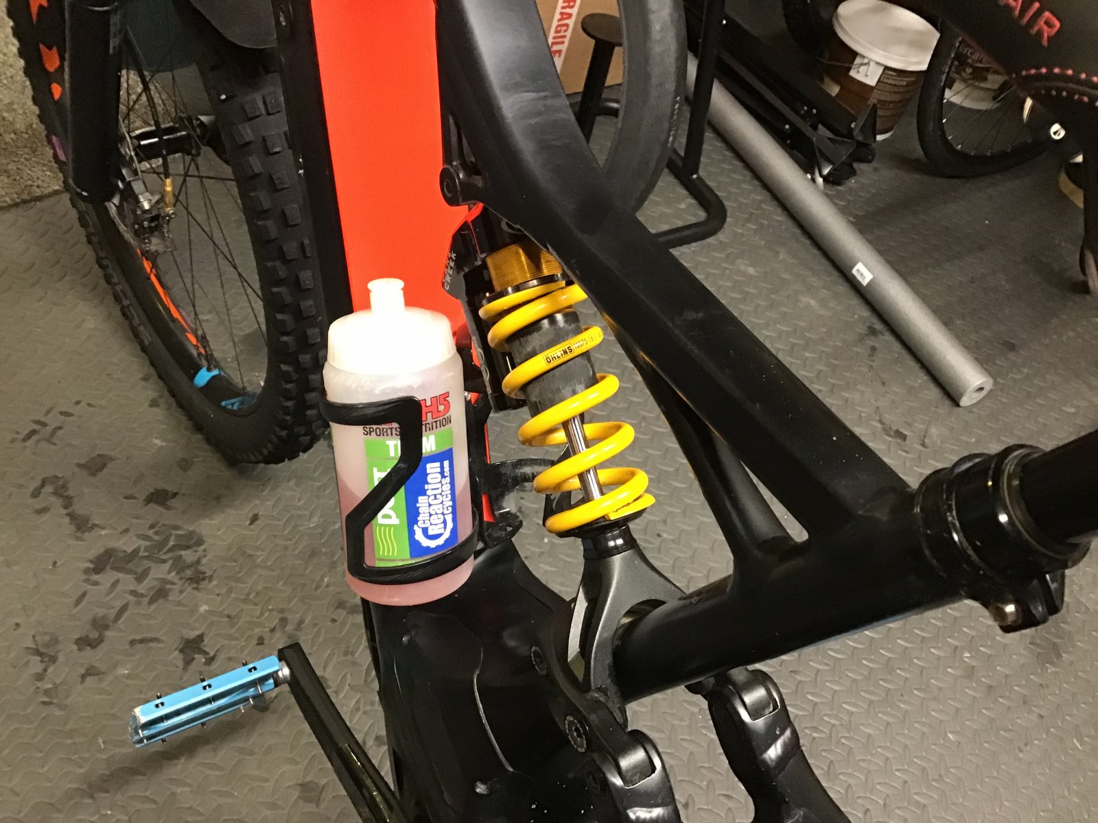

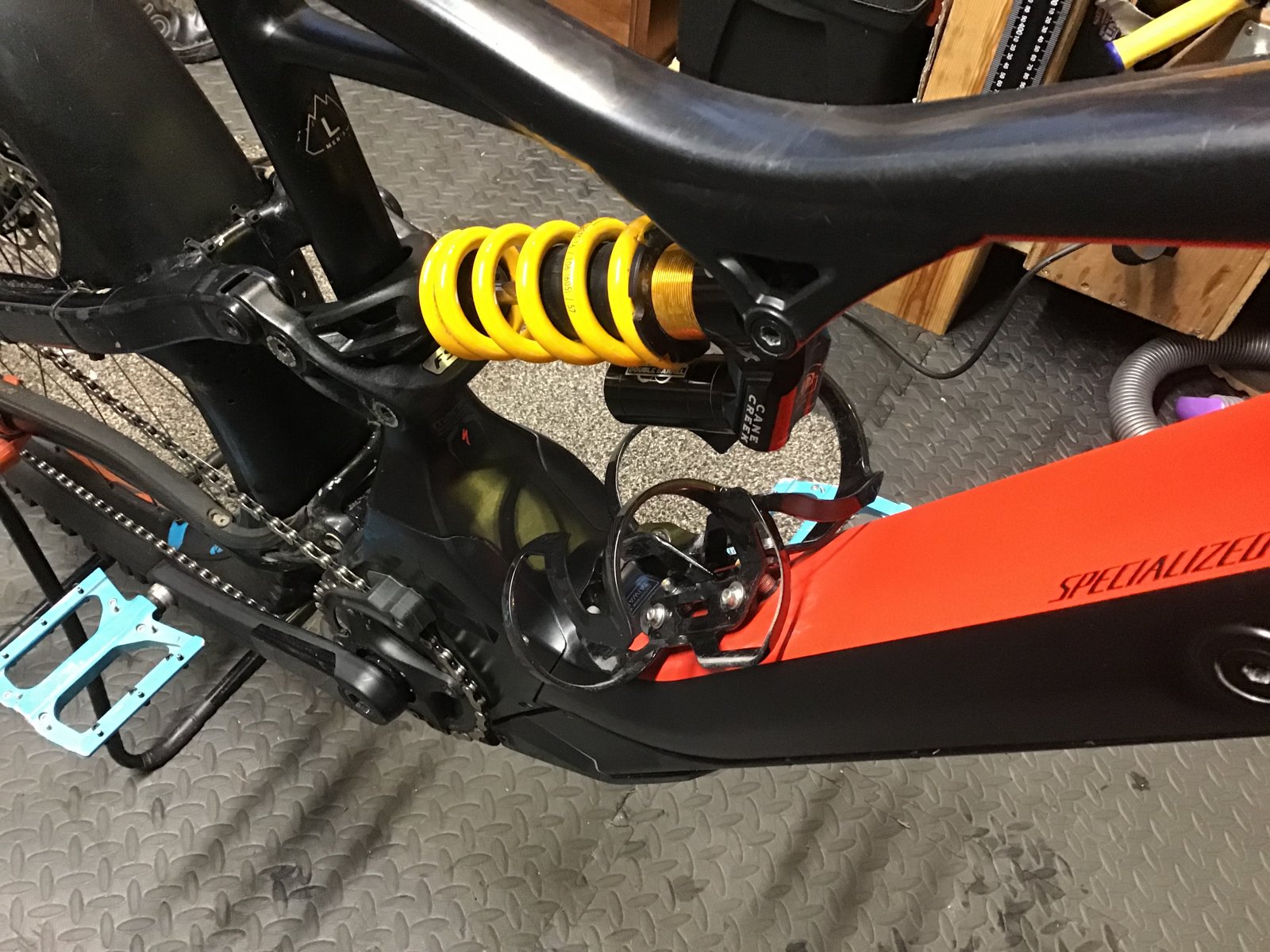

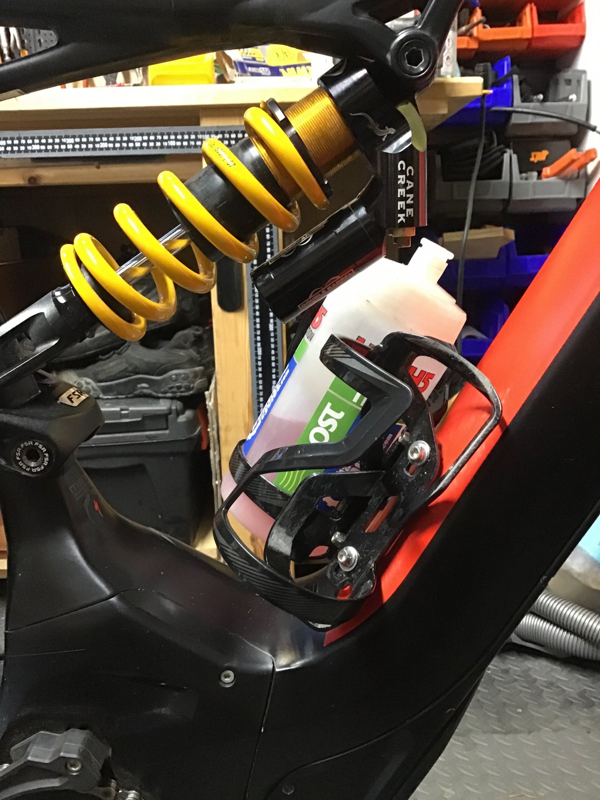

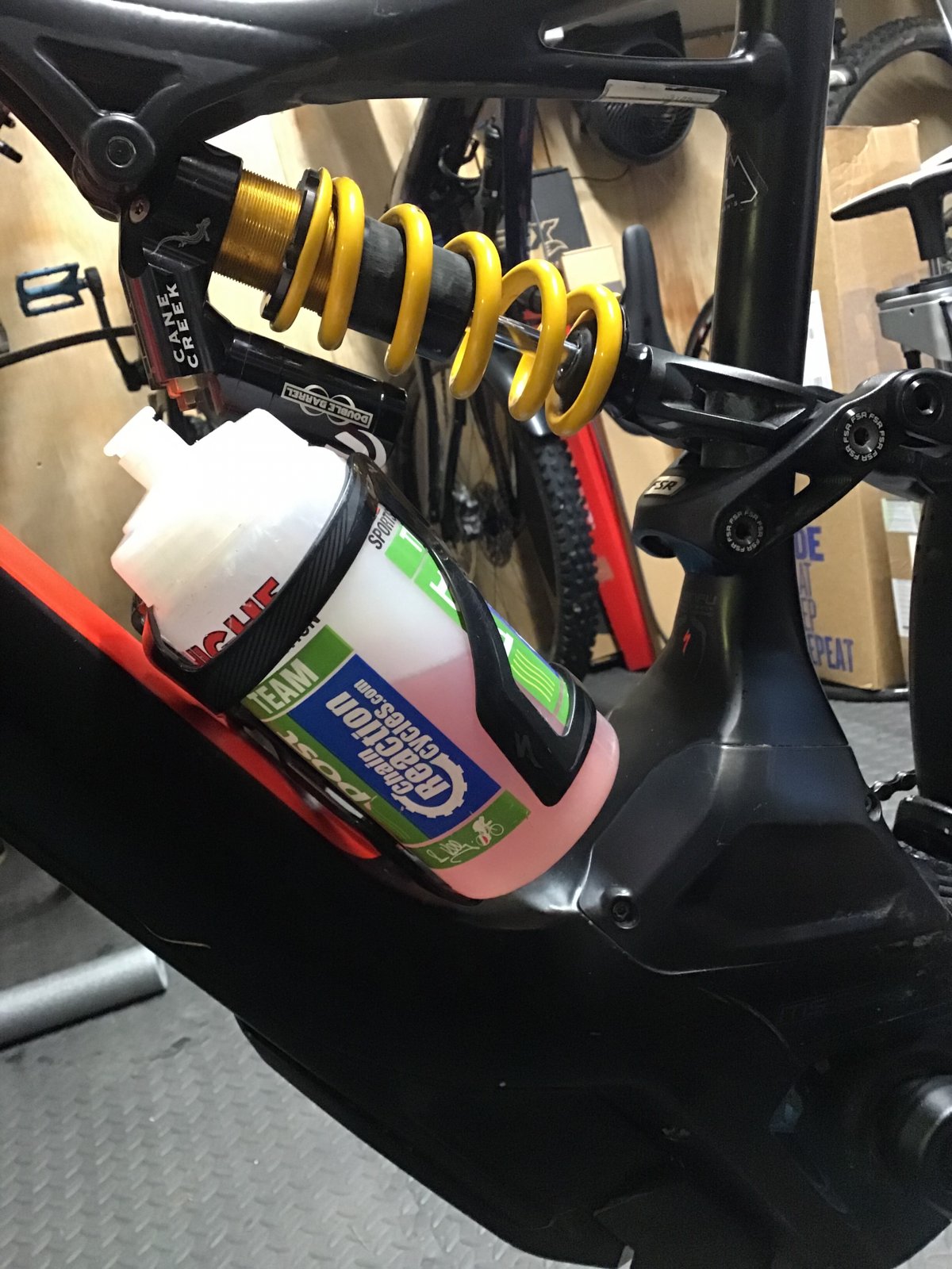

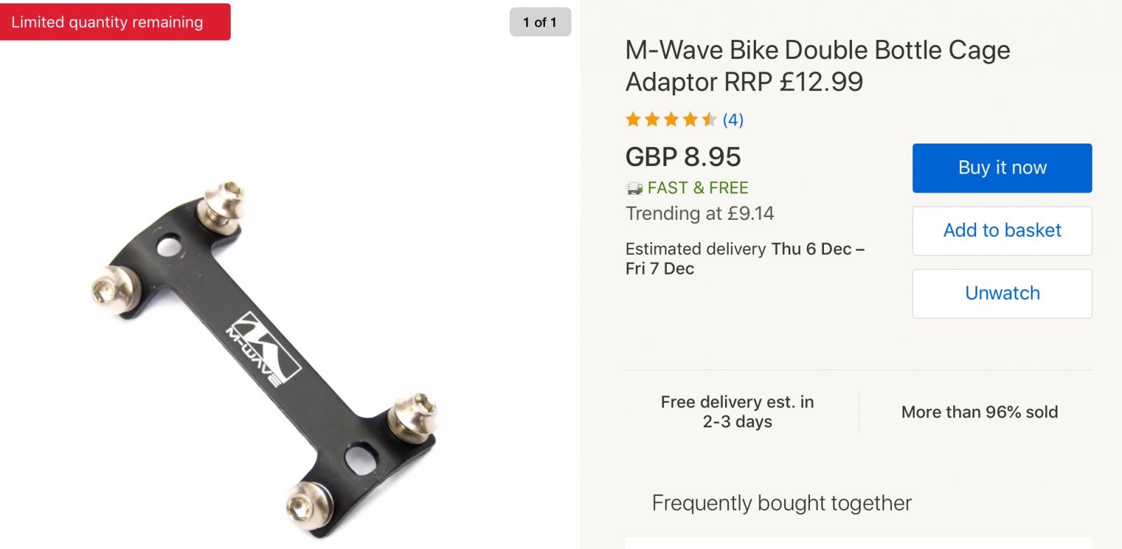

Or......
You could try this. It allows you to fit 2 small bottles side by side with an offset to the centre of the piggy back reservoir. No issues with the bottles getting in the way or you hitting them with your feet/shins/legs when you pedal either (y)
Correct, its a Levo with a piggy back shock and not a Kenevo but I believe it may still work as I had the same issue. I could not squeeze in even a small bottle when I fitted my coil shock as the reservoir on the shock prevented this.
As the downtube is flat you will need to use washers (please look closely at the first bike photo) to lift the bottle mount up and away from the downtube so the bottle cages do not rub on the frame when you fit them. You may need longer bottle cage screws too.
Hope this works for all you Kenevo Dude’s and Dudesses as it has been a brilliant cheap fix for me :)
