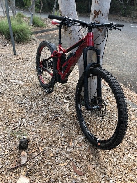

Before turning a tyre on my 900e I swapped the 2.8 Minions for Specialized Eliminators in 2.6 width Blck Dmnd casing. I followed "Flows" reports on their 900 as well, and this was the main reason I went with the heavier sidewall and narrower tyre, as well as having ridden on Specialized tyres for the last 7 years. Once mounted, the Eliminators looked barely narrower than the Minions. I didn't spend much time on the 2.8s on my test ride, but can say that the bike with 2.6s feels just like riding my analogue bike, and the tougher construction has already saved my rims

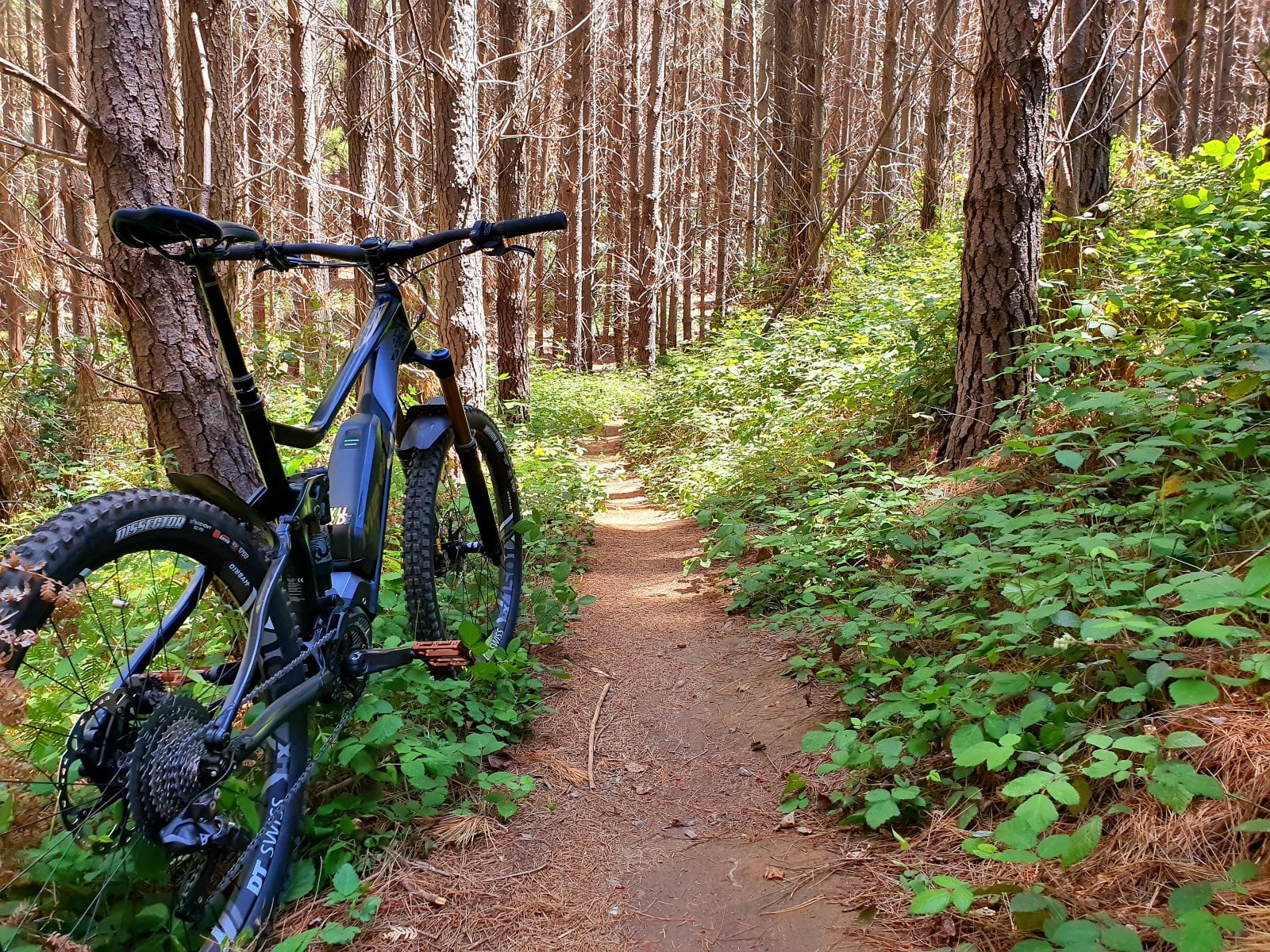

Hi All, my first post! Had the E160 for 5 months now, done about 1000km with the stock tyres running tubeless. Read a lot of articles including Flows saying how a narrower front tyre improves handling so decided to put a 30mm internal 29er wheel on the front with one of the new Schwalbe Eddy Current eMTB tyres in a 2.6 width. Was loving the bike before but this has definitely improved performance particularly in cornering. Have done around 120km with the new set up.
The narrower tyre is easier to lean over and go from edge to edge in tight corners. The overall height of the new combo is roughly 20mm more than the original adding about 5mm to the BB height and 0.5 degrees slackness to the head angle making lifting the front that tiny bit easier. Haven't noticed any detrimental effect to climbing, infact my times on a couple of tech climbs are significantly lower. The new Eddie Current tyres are awesome btw, really thick side walls and massive lugs, have ordered a 2.8 for the rear to replace the DHR which I find pretty useless if you don't run a reasonably high PSI. Here's a pic:
