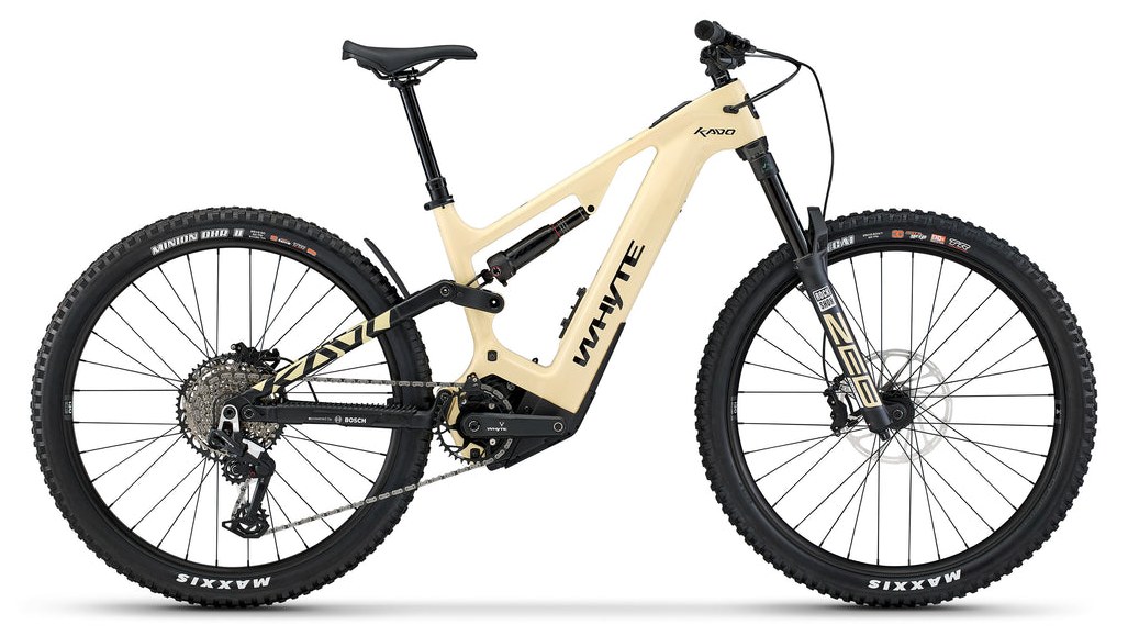

A capable and confidence-inspiring full-power, full-torque eMTB
The Whyte Kado 2025 is the UK brand's flagship full-power enduro eMTB, a carbon-mainframe / aluminium-rear chassis built around the Bosch Performance Line CX Gen 5 motor (120 Nm torque, 750 W manufacturer-claimed peak) and an 800 Wh battery (600 Wh on the entry trim). Travel is 160 mm front and 150 mm rear via a four-bar Horst-link suspension layout (Shape.it Link V2). Five trims from £3,999 (S 600Wh) to £9,999 (Works). Four sizes from S to XL, reach 436-510 mm, head angle 65.0 degrees flat, chainstays 450 mm flat. Claimed weight 25.4 kg on the headline descriptor, with the RS at 23.8 kg and RSX at 24.31 kg. The community read in one line: properly UK-designed-for-UK-conditions carbon enduro at remarkable value pricing, with the Bosch CX Gen 5 motor and a strong UK dealer network (including discounter Winstanley) making this one of the best-value full-power platforms on the market.
Drive system and range. The Bosch CX Gen 5 is the most refined eMTB motor on the market — 120 Nm torque, smooth and quiet, free OTA firmware updates via the eBike Flow app, and the deepest dealer network in the UK and Europe. The 800 Wh battery (on RS upwards) gives genuine all-day range; the 600 Wh entry trim is more limited. Real-world range will sit in the 50 to 75 km territory in mixed terrain on Trail/eMTB mode with the 800 Wh battery.
Geometry and handling. Sensibly modern. 65.0 degree head angle is right on the trail/enduro boundary. Reach steps cleanly: 436 mm (S), 460 mm (M), 485 mm (L), 510 mm (XL). Chainstays held at 450 mm flat across all four sizes — the one geometry compromise. Wheelbase 1213 to 1305 mm. The Shape.it Link V2 four-bar Horst-link suspension is well-developed. @OffitThatM8 on the RS: "Low center of gravity design enables composed behavior in air and balanced handling over rough terrain, with ability to rail berms and be 'hucked about'."
Build and value. Five well-spaced trims. S 600Wh at £3,999 is the value entry point — and at the Winstanley discounter price of just £2,999, @irie calls it "a LOT of bike with a Bosch CX motor for £3k." S 800Wh at £4,499 adds battery capacity. RS at £5,999 (23.8 kg) jumps to RockShox ZEB Select, Deluxe Select R, SRAM DB8 four-piston brakes, and SRAM Eagle 90/70 T-Type mechanical. RSX at £7,499 (24.31 kg) goes Fox Float 38 Performance Elite with Grip X2 (custom-tuned for Whyte), Float X Performance Elite DPS, Magura MT7 brakes, and SRAM S1000 AXS Eagle T-Type. Works at £9,999 is the no-compromise top. The Whyte lifetime bearing warranty is a meaningful value-add.

Verdict. The Whyte Kado 2025 is the value play of the entire UK carbon-mainframe full-power enduro segment. It suits intermediate-to-advanced UK riders, particularly those buying through Winstanley or similar discounters where the entry trim drops to £2,999, who value Whyte's UK design ethos and lifetime bearing warranty, and who don't mind a 4-bar Horst-link layout with conservative 450 mm chainstays. Look elsewhere if you want sub-23 kg weight, size-tuned chainstays, or carbon throughout. Production status: current, five trims, four sizes.
