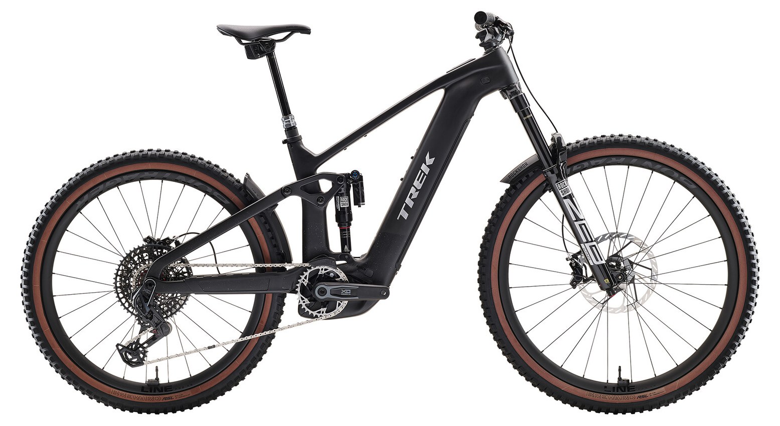

The Trek Rail+ Gen 5 2025 is the US brand's full-power enduro flagship: a 160/160 mm ABP platform with OCLV Mountain Carbon (9.x trims) or Alpha Platinum Aluminium (5/7/8 trims), Bosch Performance Line CX Gen 5 motor at 120 Nm of torque and 750 W peak, and a removable 800 Wh PowerTube battery. At a claimed 24.1 kg in trim 5 and £4,250 entry pricing, the Rail+ Gen 5 is one of the most aggressively priced and well-supported Bosch CX Gen 5 carbon-front enduros on sale. With mullet wheels, an angle-adjust headset, two-position Mino Link flip-chip and an adjustable leverage rate flip-chip (19% to 24% progression), this is one of the most geometry-adjustable platforms in the segment.
Drive system and range. Bosch CX Gen 5 delivers 120 Nm of torque, 750 W peak (the gold-authoritative figures) and a 2.8 kg unit weight. The 800 Wh PowerTube is removable via Trek's RIB 2.0 system. @Bike Bot confirms 800 Wh and 600 Wh batteries are the same length with interchangeable adapter parts — riders wanting a lighter, smaller battery for shorter rides can swap. The PowerMore range extender is compatible. Real-world range on Bosch CX Gen 5 with 800 Wh consistently lands at 1,500–2,000 m of climbing per charge depending on assistance and rider weight. The Bosch ecosystem (eBike Flow app, OTA updates, Kiox displays) is the most mature on the market.
Geometry and handling. A 64.5 degree head angle is bang in the modern enduro sweet spot, adjustable +/-1 degree via headset cups. Reach progresses cleanly: 430 mm (S/15.5"), 450 mm (M/17.5"), 490 mm (L/19.5"), 515–520 mm (XL/21.5"). The 448 mm chainstay is held constant across sizes. Wheelbase grows 1,185 mm to 1,314 mm. Mullet 29/27.5 wheels are standard on M/L/XL, with size S available in dual 27.5" for shorter riders. The Mino Link adjusts BB height and head angle; the leverage rate flip-chip lets riders run coil shocks. Eight nominal size points (including dual sizing conventions in metric/imperial) is generous.
Build and value. Seven trims sit on the Rail+ platform. The £4,250 5 is the alloy entry. The £5,000 8 at 23.8 kg with RockShox ZEB Select fork is the strong value point. The £7,000 9.8 GX AXS T-Type at 24.18 kg adds carbon front + FOX 38 Performance Elite and AXS wireless. The £8,500 9.9 X0 AXS T-Type at 23.98 kg goes RockShox ZEB Ultimate + SRAM Code Silver brakes + Bontrager Line Pro 30 OCLV carbon wheels. The £12,000 9.9 XX AXS halo at 23.2 kg gets SRAM Maven Ultimate brakes and XX T-Type Eagle AXS. The price-to-spec curve is excellent across the lineup.
Community-verified strengths. Forum reception has been overwhelmingly positive. @Bike Bot with a month on the 9.8 GX AXS calls it "very solid, a great alternative to a Gen 4 Levo" and notes that despite no flashy features it is "a very well balanced and versatile package with no real flaws." @Rob Rides EMTB tested the demo with stock 160 mm fork, 170 mm fork and 180 mm fork with -1 angleset and called it "the most underrated ebike released recently. In 170 format it's a brilliant enduro bike, big battery, removable, PowerMore compatible. Not too heavy (23.x kg)." @Bmg1 reports the bike rebuilt his trail skills and confidence and feels "really composed downhill, climbs great, super quiet."
Caveats and known gripes. Headset gasket failure is a real concern. @johnmo reports the headset gasket (between parts 1 and 2 in the OEM diagram) split into two rings within 6 months of use, and Trek's warranty claim was declined citing wear and tear rather than manufacturing defect — a frustration worth knowing about. Fit can be a constraint: @Weeksy reports only S (450 mm reach) and L (490 mm reach) were available in some markets at his time of purchase — no M option — so check stock at the dealer carefully. @irie at 5'10" found the M Trek Fuel EX a perfect fit but had to go ML on the Rail because M wasn't available. @Bmg1 had a freak UDH failure (Trek handled the warranty well). The 448 mm constant chainstay is competent but not size-progressive in an era where Norco and Megamo do scale rear-centre with size. Trek's "Rail+" naming is poor for SEO and confusing for buyers cross-shopping the original Rail vs the new Plus version.
Verdict. The Trek Rail+ Gen 5 is one of the best-supported and most spec-flexible full-power enduros on sale: Bosch CX Gen 5 power, 800 Wh removable battery, RIB 2.0 system, geometry adjustability via Mino Link + angleset + leverage-rate flip-chip, and a seven-trim ladder spanning £4,250 to £12,000. It will suit buyers who want proven Bosch reliability, the latest Smart System ecosystem, established UK dealer network and a bike that grows with the rider through fork-travel and geometry tuning. Buyers wanting the lightest possible weight, the slackest possible enduro geometry, or first-hand Avinox M2S power should look at the Cube One77 SLX (lighter at 22.8 kg, similar price), Centurion No Pogo R7000 or BH iLynx+ DL. Production status: current.
