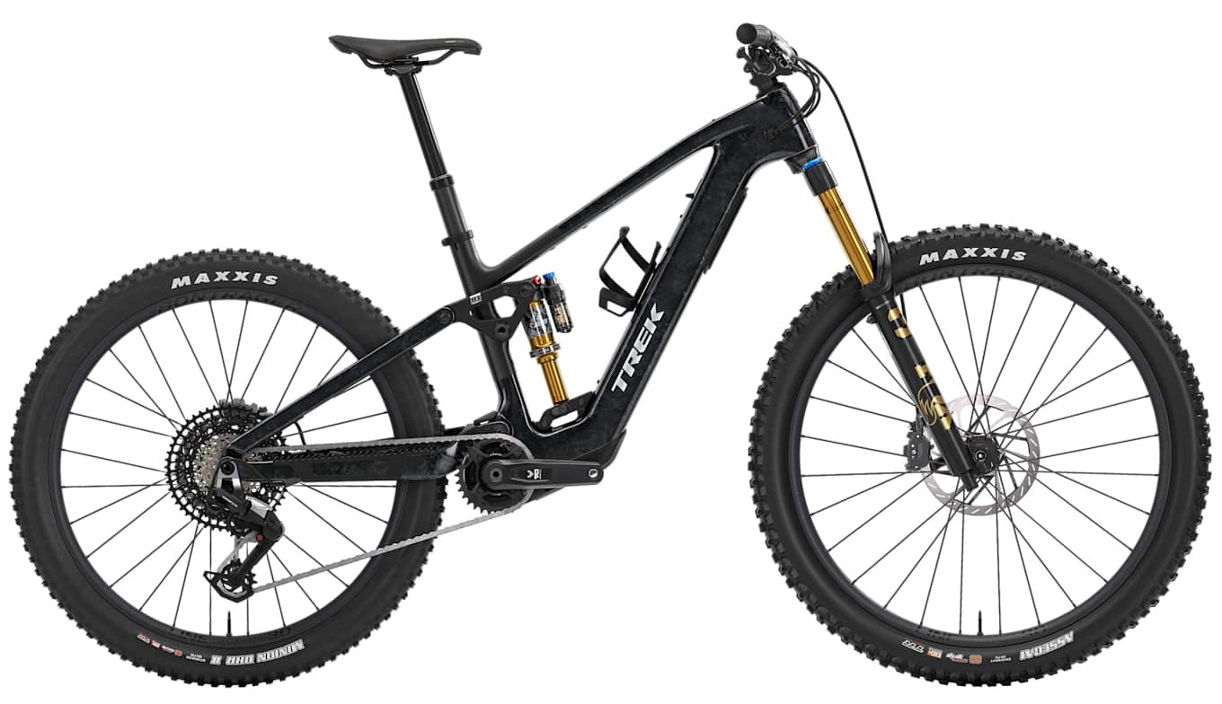

The Trek Fuel+ MX 2026 is the mullet variant of Trek's Fuel+ Gen 2 platform, an all-mountain SL carbon eMTB with the new TQ HPR60 motor. Headline numbers: 150mm fork, 150mm rear, TQ HPR60 at 60Nm and a 350W peak with a 1.92kg motor mass, a 580Wh battery, 64.2 degree head angle and reach 426 to 527mm across S, M, L, XL and XXL. Trim ladder: 9.8 XT/Eagle 90 at GBP 7,625, 9.8 XT Di2 at GBP 8,075, 9.9 X0 AXS at GBP 10,300, and base at EUR 11,800. Community read: @nickf, a 67-year-old rider, tested the Fuel+ MX over 70km and 1,800m+ of climbing across two days and reports the motor as "99% silent" with Med mode "adequate for most climbing".
Drive system and range. The TQ HPR60 is the newer-spec successor to the HPR50: 60Nm of torque, 350W peak and a 1.924kg motor mass. It is one of the quietest motors on the market thanks to TQ's signature magnetic gearbox. The 580Wh battery is a meaningful 60% increase over the HPR50/360Wh combination used elsewhere in the TQ family. @nickf's real-world range testing in France: 27.8km/545m on 60% battery (mid/hi), 36.4km/620m on 60% (eco/mid): comfortably 2+ hour rides with capacity to spare. The motor is "quieter and more natural feeling than Fazua motor" per @nickf's direct comparison with a Heckler SL.
Geometry and handling. 64.2 degrees up front is properly slack for an SL bike. Reach steps cleanly: 426 (S), 456 (M), 482 (L), 507 (XL), 527 (XXL). Chainstays grow with size from 440 to 449mm: a thoughtful proportional approach. Wheelbase tops out at 1332mm on XXL. Mullet 29/27.5 wheel layout is standard, but @Noclutch notes the platform supports full 29er conversion via link changes: a useful flexibility.
Build and value. Five trims with meaningful jumps. 9.8 XT and Eagle 90 (GBP 7,625): mechanical Shimano XT or SRAM Eagle 90 T-Type. 9.8 XT Di2 (GBP 8,075): Shimano XT M8200 Di2 electronic. 9.9 X0 AXS (GBP 10,300, approximately 19.1kg per @wtsheff): SRAM X0 AXS T-Type, Fox Factory 36 and Float X. Base at EUR 11,800 is the flagship Project One/Pro build. Standout: 19.1kg system weight on a 150/150mm carbon mullet at the 9.9 trim is class-leading. @zirkel rates the Fuel+ MX's Fox Factory 36/Float X over the Yeti MTE C2 90's Fox Performance equivalents.

| S | M | L | XL | XXL | |
| Reach | 426 mm | 456 mm | 482 mm | 507 mm | 527 mm |
| Stack | 627 mm | 627 mm | 641 mm | 654 mm | 668 mm |
| Chainstay | 440 mm | 440 mm | 440 mm | 444 mm | 449 mm |
| Headtube Angle | 64.2° | 64.2° | 64.2° | 64.2° | 64.2° |
| Seattube Angle (eff) | 77.7° | 77.5° | 77° | 76.6° | 76.1° |
| BB Drop | 31 mm | 31 mm | 31 mm | 31 mm | 31 mm |
| Wheelbase | 1204 mm | 1234 mm | 1266 mm | 1301 mm | 1332 mm |
| Headtube | 110 mm | 110 mm | 125 mm | 140 mm | 155 mm |
| Front Centre | 764 mm | 794 mm | 826 mm | 857 mm | 883 mm |
