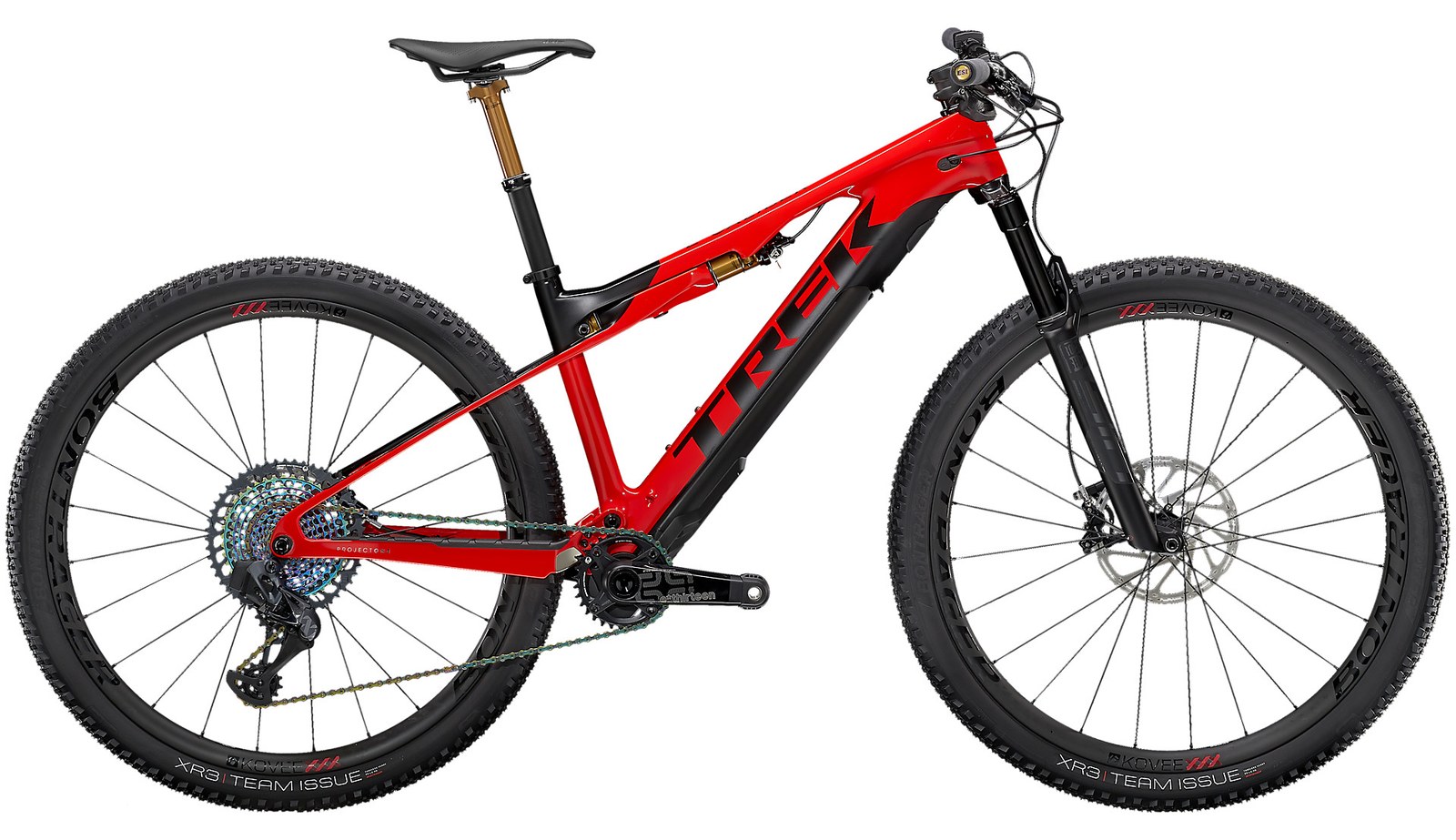

EMTB Forums verdict
The 2022 Trek E-Caliber is a lightweight cross-country eMTB built on the same IsoStrut platform as Trek's World Cup Supercaliber: an OCLV Mountain Carbon frame with 120 mm of fork travel and just 60 mm of integrated rear travel, running full 29in wheels. Rather than a full-power motor it uses the compact Fazua Evation drive (badged 'Ride Trail 50' in Trek's spec), a 55 Nm, 250 W nominal / 450 W peak unit fed by a 250 Wh battery. The whole motor-and-battery drivepack slides out of the down tube, dropping a claimed 2.9 kg and leaving a near-drag-free bike that pedals close to an analogue XC race bike.
Geometry is XC-focused and consistent across all four sizes: a 67.5 degree head angle, 447 mm chainstays, a 323 mm bottom bracket height with 50 mm of drop, and reach growing from 405 mm on the Small to 490 mm on the Extra Large. All trims share the frame, so the ride position is identical whichever build you pick. Every model rolls on 29x2.40in Bontrager XR3 Team Issue tyres with a 120 mm fork and Trek's remote-lockout IsoStrut shock.
Six builds were offered in the UK. The alloy-wheeled 9.6 (18.48 kg claimed, 6,500 pounds) mixes a RockShox 35 Gold RL fork with a Shimano Deore/XT drivetrain and a TranzX dropper. The carbon-wheeled 9.8 GX and 9.8 XT (both 9,250 pounds) add a RockShox SID Select+ fork, Kovee Pro 30 carbon wheels and SRAM GX or Shimano XT groups, with the 9.8 GX AXS (9,850 pounds) going wireless. At the top, the 9.9 XTR (16.38 kg, 11,100 pounds) pairs a Fox Factory 34 Step-Cast fork and Fox Factory shock with Shimano XTR and Kovee XXX carbon wheels, while the flagship 9.9 XX1 AXS (16.35 kg, 12,100 pounds) runs a RockShox SID Ultimate fork and SRAM XX1 Eagle AXS.
The E-Caliber was a niche, expensive proposition and Trek discontinued it after a short run, so it is no longer available new. For a used buyer it remains one of the very few genuine XC race eMTBs, best judged on the Fazua drive suiting your terrain and the significant price gulf between the alloy 9.6 and the carbon-wheeled builds.

MotorFazua Evation · 55 Nm · all trims
BatteryFazua Evation battery · 250 Wh · all trims
Travel F/R120/60 mm · all trims
