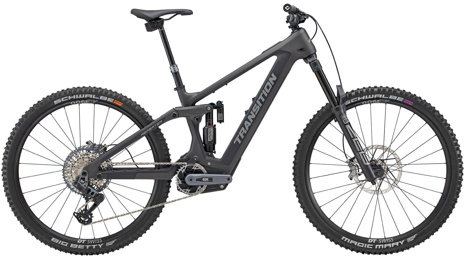

Transition Repeater PT 2026
From £10,499
EMTB Forums verdict
The Repeater PT is Transition's hard-hitting carbon enduro eMTB, running 170mm of travel front and rear via the brand's GiddyUp suspension layout with its claimed 27 per cent progression. The defining feature is the SRAM Eagle Powertrain system: a 90Nm Brose-built motor, 720Wh battery and T-Type AXS Transmission all integrated to enable auto shift and coast shift, with two simple power modes (Range and Rally).
Two builds are offered. The GX at £10,499 pairs RockShox ZEB Select and Vivid Select+ suspension with a SRAM GX AXS Transmission, Code Bronze brakes and DT Swiss H 1900 wheels. Stepping up to the XO at £11,999 buys the Ultimate-level ZEB fork and Vivid shock, an XO AXS Transmission, Code Silver brakes, Crankbrothers Synthesis alloy wheels and a OneUp carbon bar. Both share 220mm rotors, a 160mm crank, the Schwalbe Magic Mary and Big Betty Super Gravity tyre pairing and a claimed weight just under 24kg.
Geometry is aggressive and consistent across the four sizes, with a 63.5 degree head angle and 455mm chainstays throughout, while reach grows from 425mm on the Small to 510mm on the XL. The effective seat angle steepens on the smaller frames, ranging from 77.5 degrees on the XL to 79.2 degrees on the Small. The frame is mixed-wheel compatible via a geo chip and the oversized head tube accepts reach or angle-adjust headsets.
