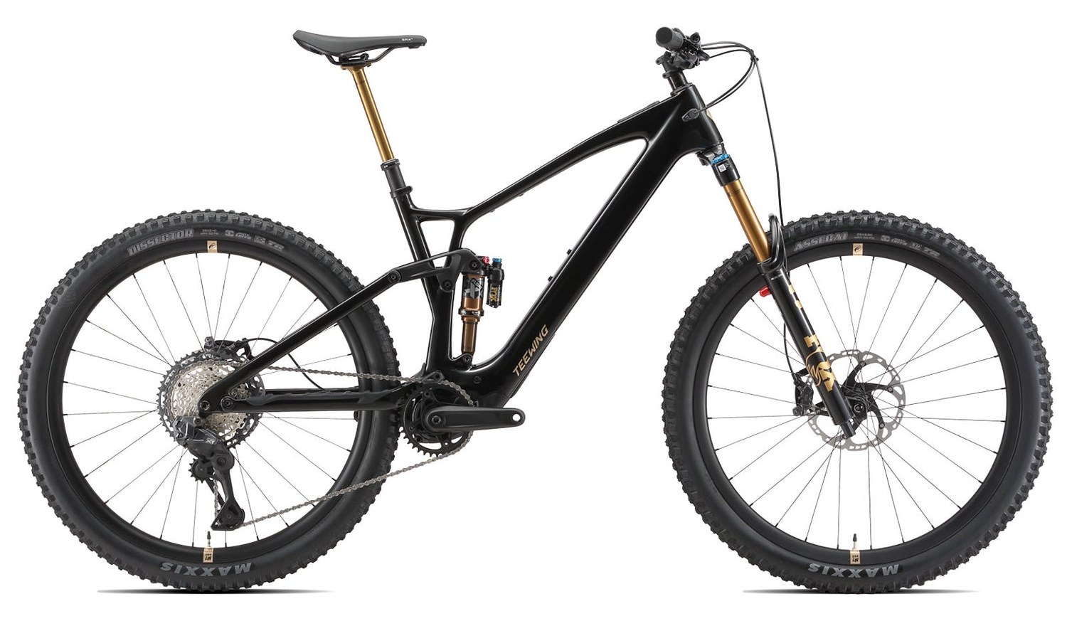

The Teewing Turbo Force Pro 2026 is a direct-sale Chinese carbon all-mountain eMTB built around DJI's Avinox M1 motor and an 800 Wh battery. It runs 160 mm of fork travel and 150 mm rear on a T800 reinforced carbon monocoque frame (claimed at 2.37 kg, category 4 certified). Headline numbers: 105 Nm of torque, 1000 W peak power from the Avinox M1, a claimed 21 kg system weight, a 64.5 degree head angle, a 77 degree seat angle and reach from 453 to 500 mm across three sizes. £7,399 for the Force Pro base trim with FOX 36 Float Factory, FOX Float X Factory, Shimano XT four-piston brakes and Shimano XT Di2. Community verdict: an ambitious Chinese-built carbon platform that delivers the latest DJI Avinox drive at a meaningfully lower price than the Amflow flagship, though brand visibility and dealer reach remain limited.
Drive system and range. The DJI Avinox M1 sits at the entry of the Avinox line, with 105 Nm of continuous torque (rising to 120 Nm in Boost mode) and 1000 W of peak power. At 2.52 kg motor weight, the M1 is lighter than Bosch CX Gen 5 (2.8 kg) by about 10 per cent. Independent lab testing has flagged that real-world peak power on the M1 sits around 730 to 780 W rather than the headline 1000 W, with Boost adding roughly 50 W on top. The 800 Wh FP800 battery is removable via side hatch, supports 4 A standard charging and delivers proper all-day range, with mixed all-mountain use typically reaching 60 to 90 km. The Avinox shares helical gears, sealed bearings and a 5-mode (Eco, Trail, Auto, Turbo, Boost) interface across M1, M2 and M2S generations.
Geometry and handling. A 64.5 degree head angle is bang on the modern all-mountain norm, matching the Amflow PR Carbon, Cannondale Moterra Neo and Norco Sight VLT. Reach grows from 453 mm in M to 500 mm in XL, a tight 47 mm spread that excludes shorter and very tall riders. The 445 mm chainstay is identical across sizes, on the playful side of the all-mountain market. Wheelbases run 1229 to 1285 mm. 29-inch wheels across the range. The 77 degree seat angle gives a steep, climb-friendly seated position.
Build and value. Three trims. The base at £7,399 brings FOX 36 Float Factory with GRIP X2 damper, FOX Float X Factory shock, Shimano XT BR-M8220 four-piston hydraulic brakes and Shimano XT Di2 M8250 drivetrain. The Force at €6,699 is the mid-spec, and the Force XT sits above (price not yet recorded). The standout strength is the price-to-spec ratio: a FOX 36 Factory, FOX Float X Factory and Shimano XT Di2 build with DJI Avinox M1 and 800 Wh battery is genuinely competitive at the £7,399 trim. The questionable note is the three-size lineup, which only covers M, L and XL and excludes a meaningful share of shorter riders.
Caveats and known gripes. Teewing brand recognition outside specialist direct-import channels remains limited. UK warranty and dealer reach are essentially zero: support relies on Teewing's direct-to-customer model, which means longer wait times for parts and service. Long-term reliability data on the chassis is not yet available from the community. DJI Avinox warranty support is still bedding in compared to Bosch and Shimano. As a direct-sale brand without local dealer presence, resale value is harder to predict than for mainstream brands. And the three-size lineup is genuinely restrictive for riders outside the 5'9" to 6'2" range.
Verdict. The Turbo Force Pro 2026 suits the value-led carbon all-mountain rider who wants DJI Avinox M1 motor power and a flagship FOX Factory plus Shimano XT Di2 build at a price well below the equivalent Amflow PR Carbon Pro, and who is comfortable with a direct-sale brand without UK dealer support. Riders chasing stronger UK warranty cover, wider size range or the latest DJI Avinox M2S motor should look at the Amflow PR Carbon, the Mondraker Zendit or the Pivot Shuttle AMP'd. Production status: current.
Frame
T800 reinforced carbon monocoque all-mountain frame (2.37 kg claimed, category 4 certified) with four-bar linkage, 160 mm front / 150 mm rear travel, 64.5 degree head angle, 77 degree seat angle, 800 Wh Avinox battery integrated
