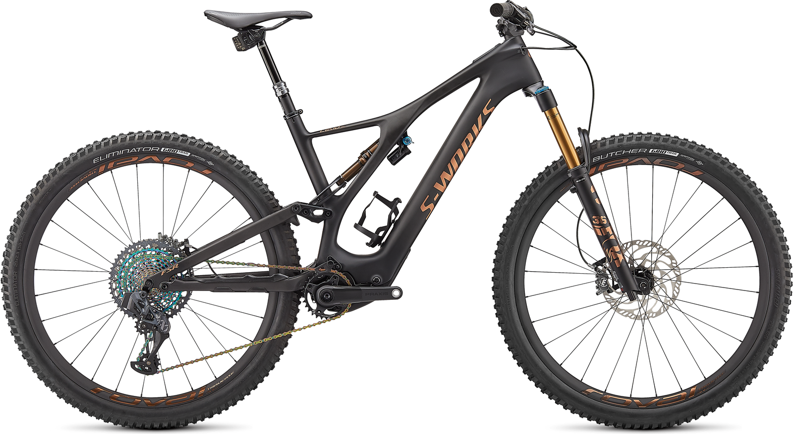

The 2022 Turbo Levo SL was the final catalogue year of the original lightweight Levo, a Stumpjumper-derived 29er with 150mm of travel at both ends and Specialized's own SL 1.1 motor (35Nm, 240W peak, 1.95kg, 2x rider amplification) fed by a fully integrated 320Wh battery with an optional 160Wh range extender. The MY22 bikes carried over from 2021 with the MasterMind firmware update preinstalled for smoother power delivery, while the Expert Carbon gained a Grip2-damped Fox 36 Performance Elite in place of the previous 34 and SRAM Code RS brakes with 200mm rotors. Flow Mountain Bike measured the 2022 Expert Carbon at 17.84kg without pedals, some 4-5kg lighter than a full-power Levo.
At the start of the 2022 season the UK ladder ran from the £5,750 Comp, the only M5 alloy frame and the only trim offered in XS, through the £7,100 Comp Carbon (identical NX Eagle, Fox Rhythm 34 and Guide R build, so roughly £1,350 buys the FACT 11m carbon frame), to the £8,500 Expert Carbon with SRAM X01, Code RS 4-piston brakes and Roval Traverse alloy wheels. The £12,500 S-Works added Factory-level Fox suspension, wireless XX1 Eagle AXS, Magura MT7 brakes with 203mm rotors, carbon Roval Traverse SL wheels and a Reverb AXS post. Specialized's 2022 price rises pushed UK RRPs up during the year (the Comp reached £6,500 and the S-Works £13,700 by late 2022). The Expert Carbon is the value pick of the carbon trims: it shares the S-Works fork chassis and damper family and gets the same tyres and geometry for £4,000 less at launch pricing.
Geometry is conservative by later standards: a 66-degree head angle, 435mm reach on the Medium, 437mm chainstays across all sizes and no flip chip or geometry adjustment. It was superseded in mid-2023 by the second-generation Levo SL with the SL 1.2 motor, mullet wheels and S-Sizing, so the 2022 bike is now discontinued and only available used.
